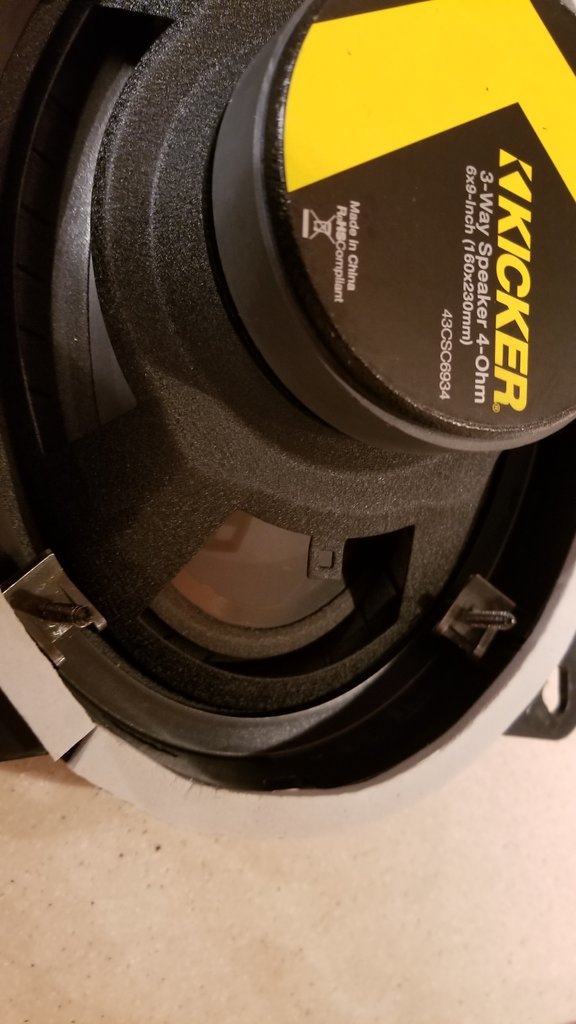

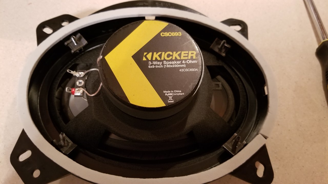

    mounting my new door speakers on Tuesday, i had a few minutes today so to save some time when i go to install i went ahead and mounted the speakers to the Metra speaker mounting brackets that were included by Crutchfield. The 6 3/4" bracket holes were perfectly lined up but those 6x9 bracket holes were pathetic .. i got the screws in them but to me it seems if you would try to tighten them really tight they would strip out.
    I also used 3/8" wide X 3/16" thick weather stripping between speaker and bracket plus put it on backside of bracket that goes against door .. maybe not necessary but it was cheap.

    yes they will strip and eventually get loose from vibrations.
    you need to lock them in place with the mounting tabs supplied.
    OhioTaco68[QUOTED] likes this.

    THANKS !! i will go back and put those on .. guess i should have read instructions LOL as i just put the screws in

    I got it figured out :thumbsup: hopefully this can be a help to someone else ... use the longer screws and the clips on the underside to get the speaker tight to the adapter bracket

    That is exactly how I secured mine. I don't know how so many people were confident with just the screws.
