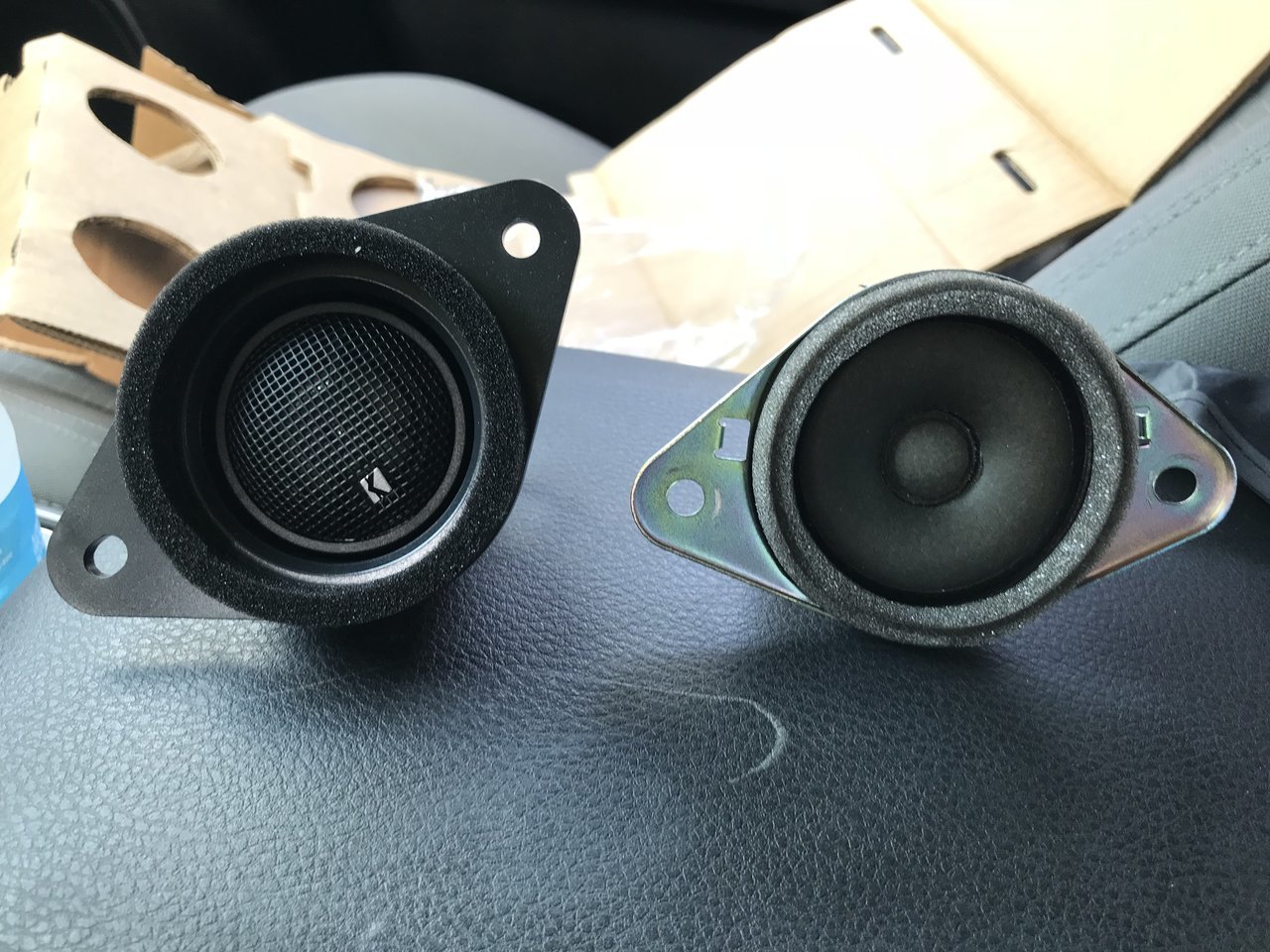

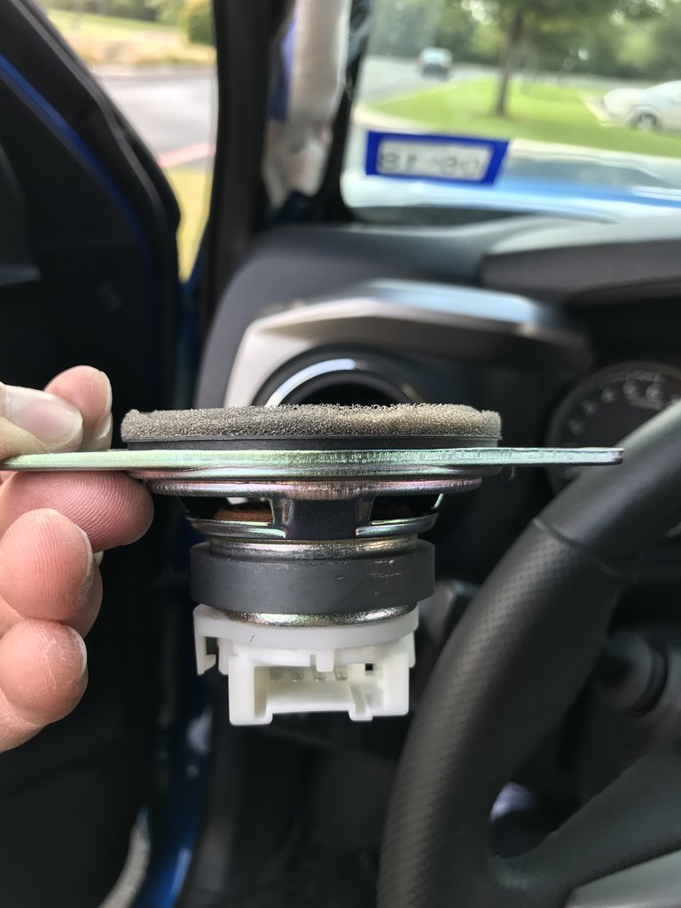

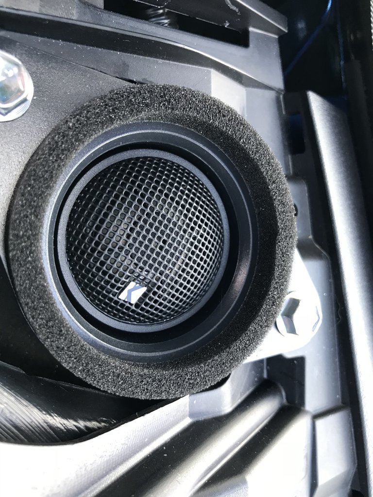

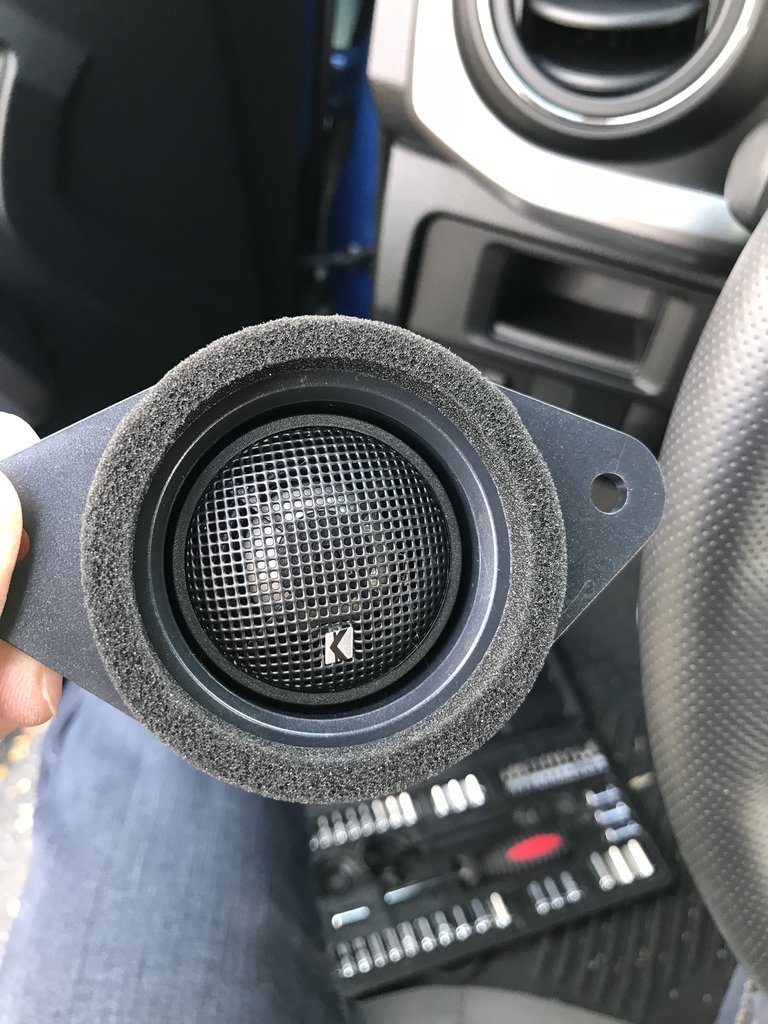

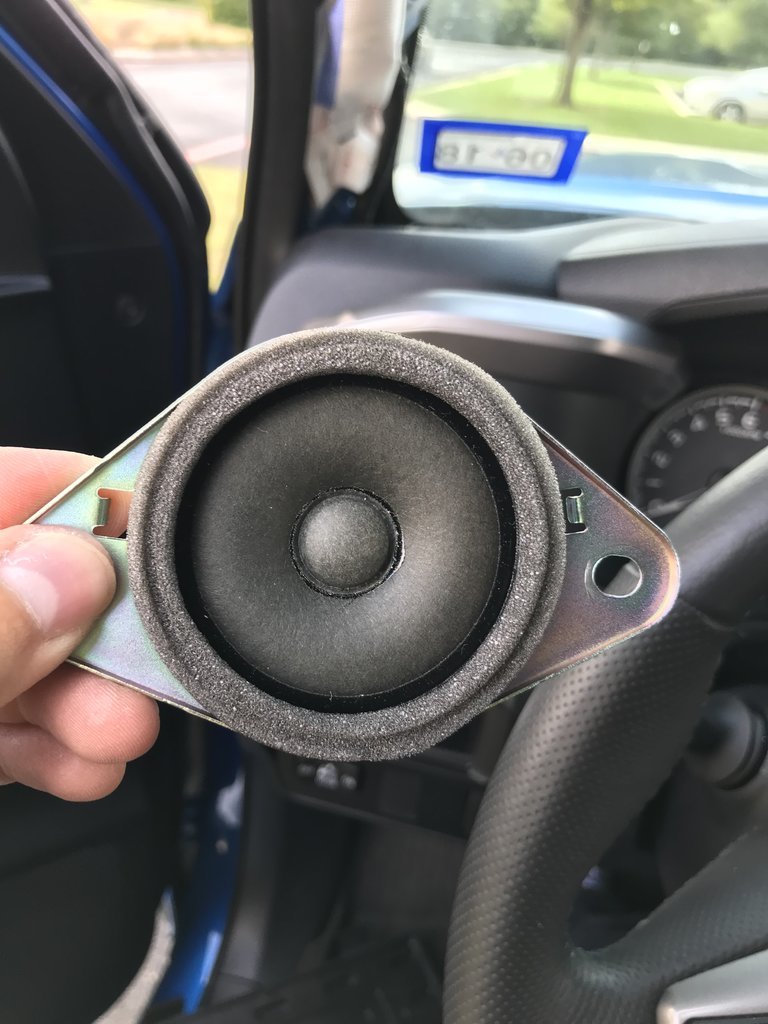

    Done! Just finished replacing mine! 10min for both sides! Can’t wait to test it out! Here’s some pics I took :)

    Well ? Pretty big difference huh, you can actually hear the treble now :thumbsup:

    Holy shit what a difference just replacing the tweeters make!!! I have Bluetooth going with my Spotify with the volume at 20 and sounds like it’s almost at 40! And I’m not exaggerating either haha. It sounds great and I might just keep it this way for a while before replacing the other door speakers. Glad I discovered this thread!
