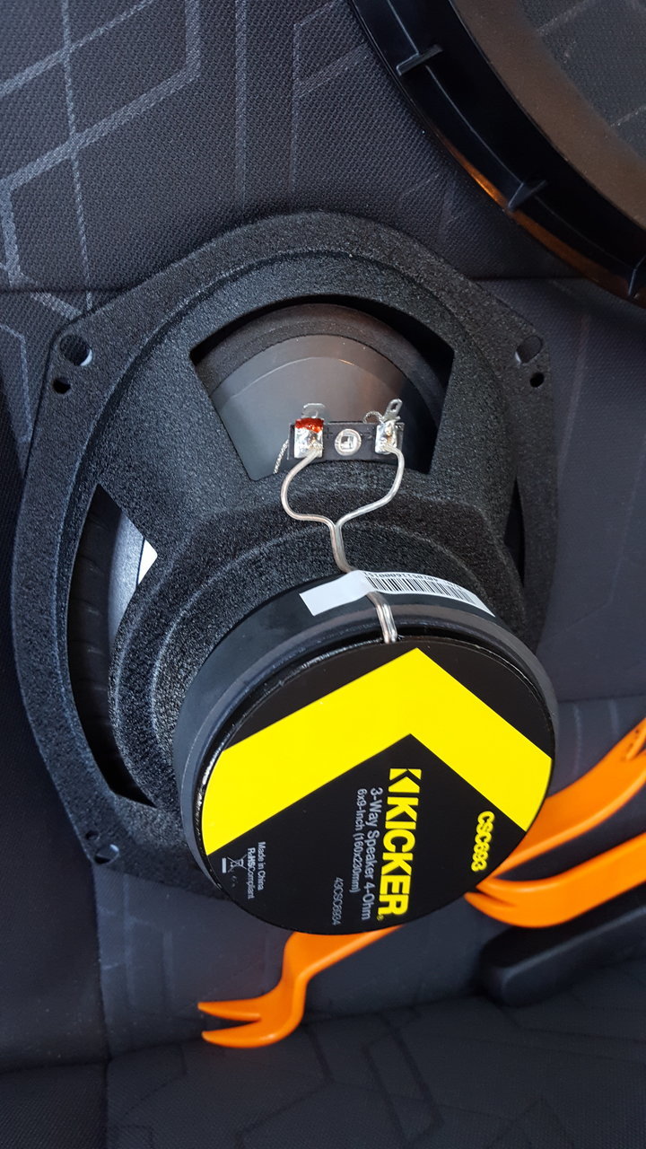

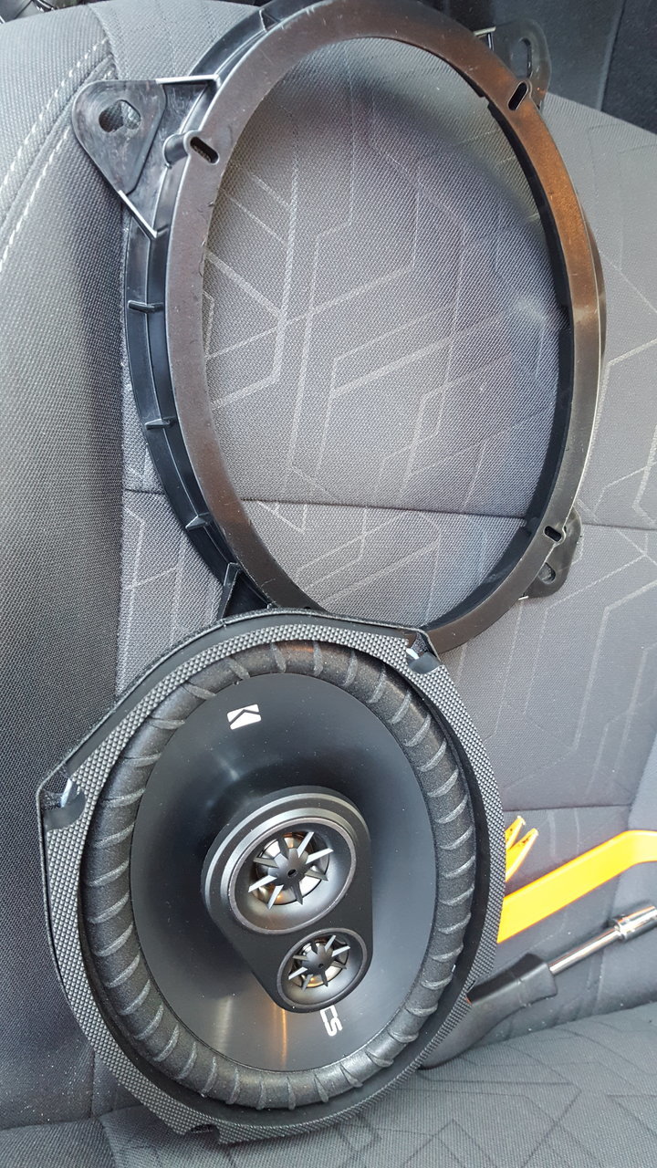

    Did crutchfield send me the wrong shit? It doesn't look like the video. The speaker doesn't match up to the bracket and the bracket has no slot for the white connector to plug back in
  12. Nov 2, 2017 at 2:40 PM
    #1032
    mrproduxn
    mrproduxn Well-Known Member
    Feb 22, 2013
    #98175
    6,378
    steve
    Retired DoD SE VA
    Tacomas 1987,2000,2008, 2016,2012,2008
    Retired/Hobbyist old as f***
    It appears to be the correct shape and height. I know mine had square holes for the wire adapter plugs. That doesn't mean these won't work. Maybe these are more universal. The plug hole isn't that important. As long as you can connect the plug it should be fine. It only takes a few minutes to remove a stock one and lay it side by side to see if the profile and height match up. Lay the new speaker on the mount when comparing because the stock speaker and mount are 1 piece. Don't install any screws until you compare them.
  13. Nov 2, 2017 at 3:02 PM
    #1033
    gliebig
    gliebig Well-Known Member
    Oct 12, 2017
    #232728
    138
    2017 Silver Spark Off Road Ext Cab LB
    I think I got it. Used the pigtails to connect the new speaker . The speaker to bracket connection was a bit wonky but I got it.
