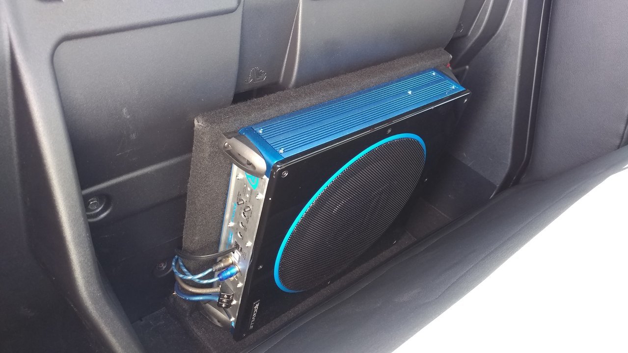

    Finally finished my subwoofer install:

    What is that and hows the sound?

    I don't think it matters but if you have the entune premium + nav it's probably the 7" screen.
