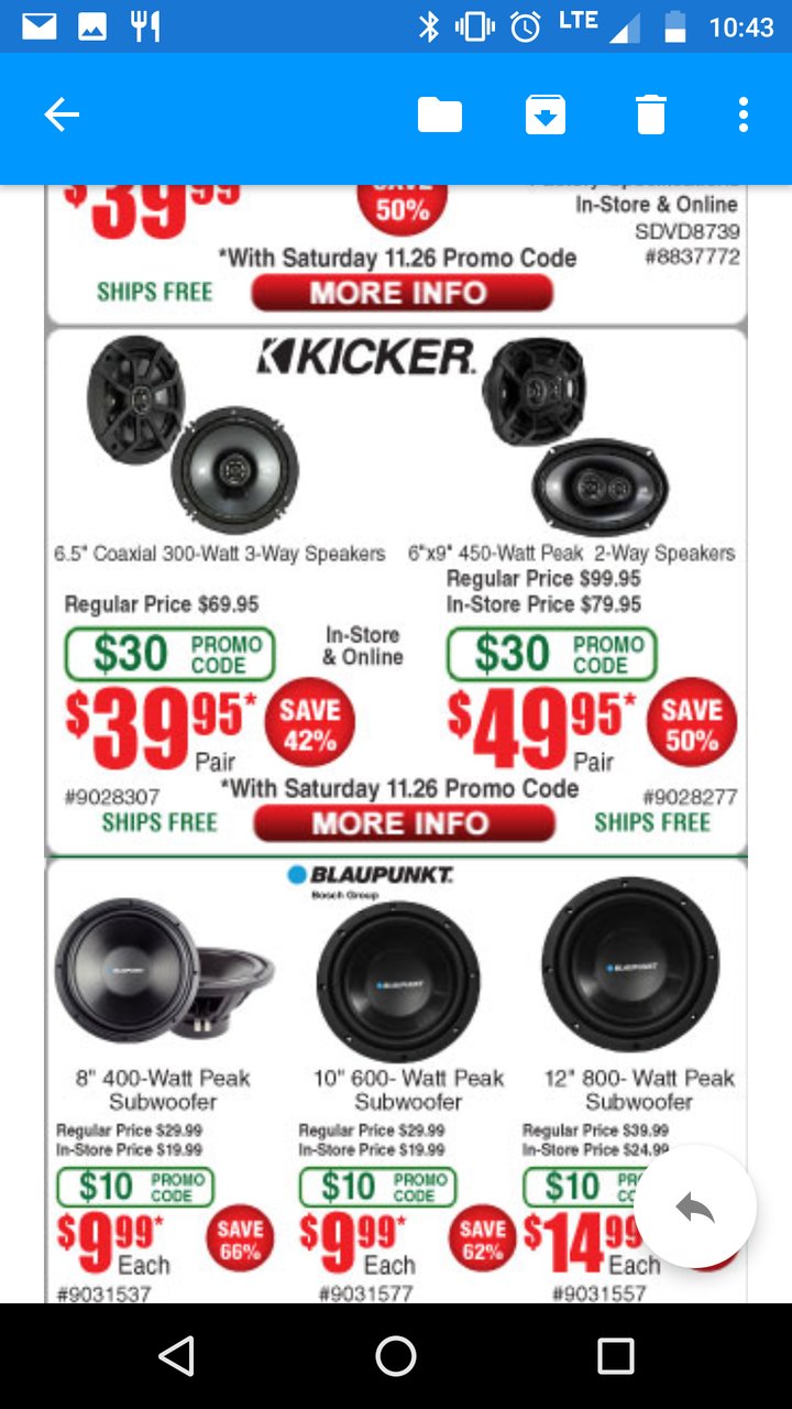

    Heads up if you guys want a good deal today on the door speakers. Fry's has them for about $50 with their email promo code 6816338

    Would the Frys speakers come with mounting hardware and what size do I get.

    ^ this. That's why I ordered with Crutchfield. I could get it cheaper at other places, but not if I included the cost of the mounting hardware.

    You're right. Just looked up what's needed, and it's not included at Fry's. $65 for the 6x9s at Crutchfield today, with everything you need.
    That'll be the better deal.

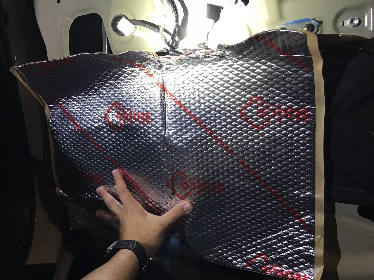

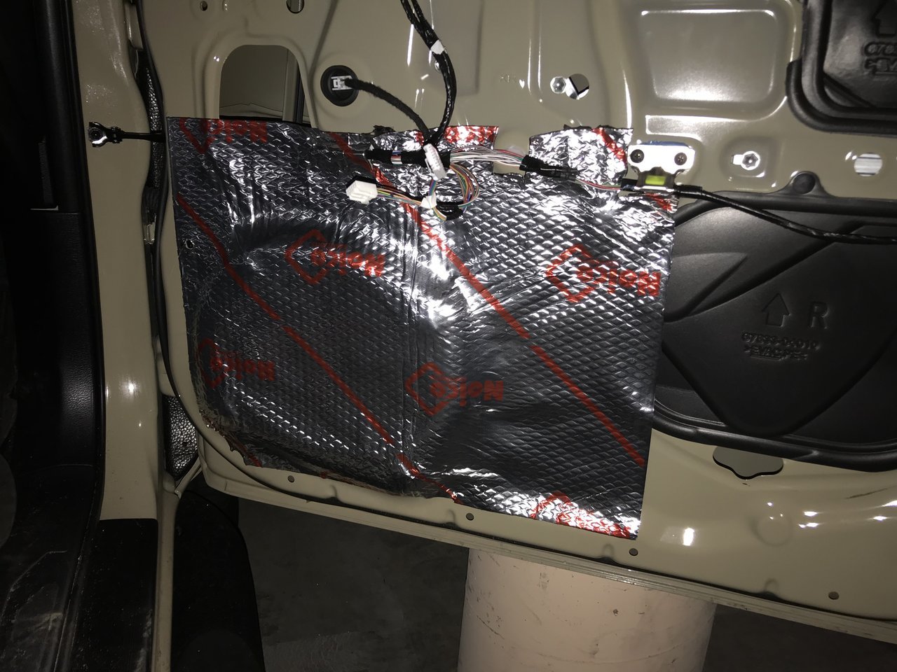

    need to learn more about this stuff
    Holy crap. I’m a handy guy. But I’ve never done stuff with speakers and NOTHING ever like the sound deadening. And a bit of a perfectionist in the handy and crafty stuff i do. I would say that if the Noico doesn’t make a huge difference. DONT DO IT. holy crap. The first door took me FOREVER. between trying to figure the screws and mounting them on the bracket and how to do the noico well. Rough.
    Hope the next three doors go a lot quicker.
    It isn’t as asy as everyone makes it seem. Well for me it hasnt been

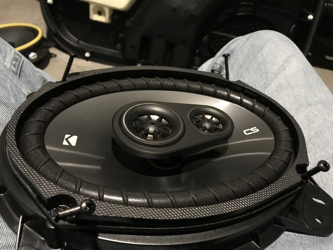

  17. Dec 3, 2017 at 7:42 PM
    #1317
    Pikestaco
    Pikestaco Newbie
    Dec 29, 2016
    #206007
    1,100
    Los Angeles
    2017 Quicksand 4x4 TRD Sport DCLB

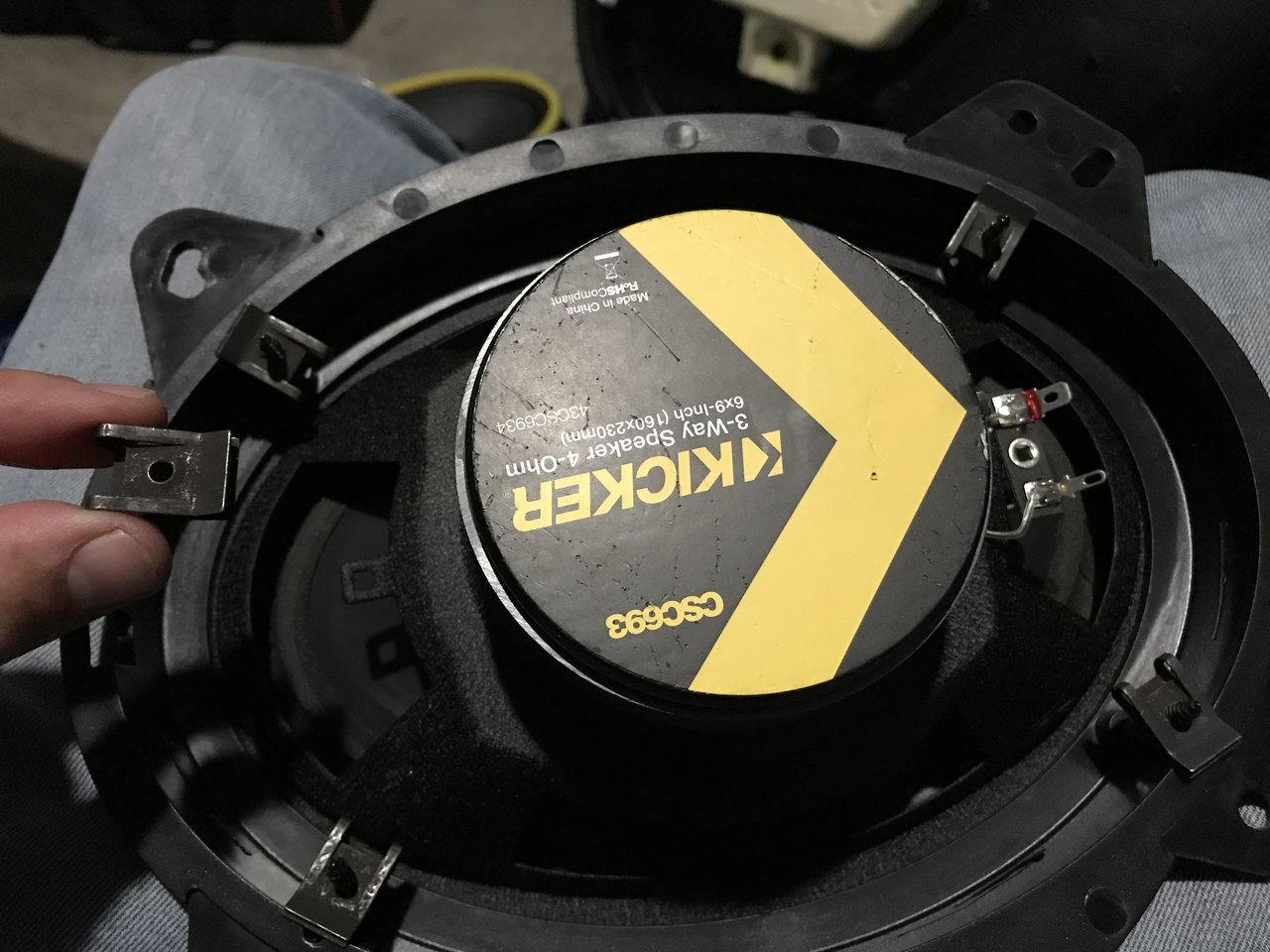

    The screws and brackets also sucked. Not sure I did them right. Well I angled the screws right. But I used these little back pieces. Not sure if needed or if used them right?
  18. Dec 3, 2017 at 8:44 PM
    #1318
    707tothe907
    707tothe907 Superior Member
    Oct 28, 2010
    #45372
    2,813
    Jake
    Chico NorCal
    05 DCSB Off Road
    I also attempted to install mine today. Very frustrated with how the speaker lines up to the bracket. Guess we have to drill a 4th hole? And what’s up with the L shaped pieces of metal we’re supposed to screw into? What a joke

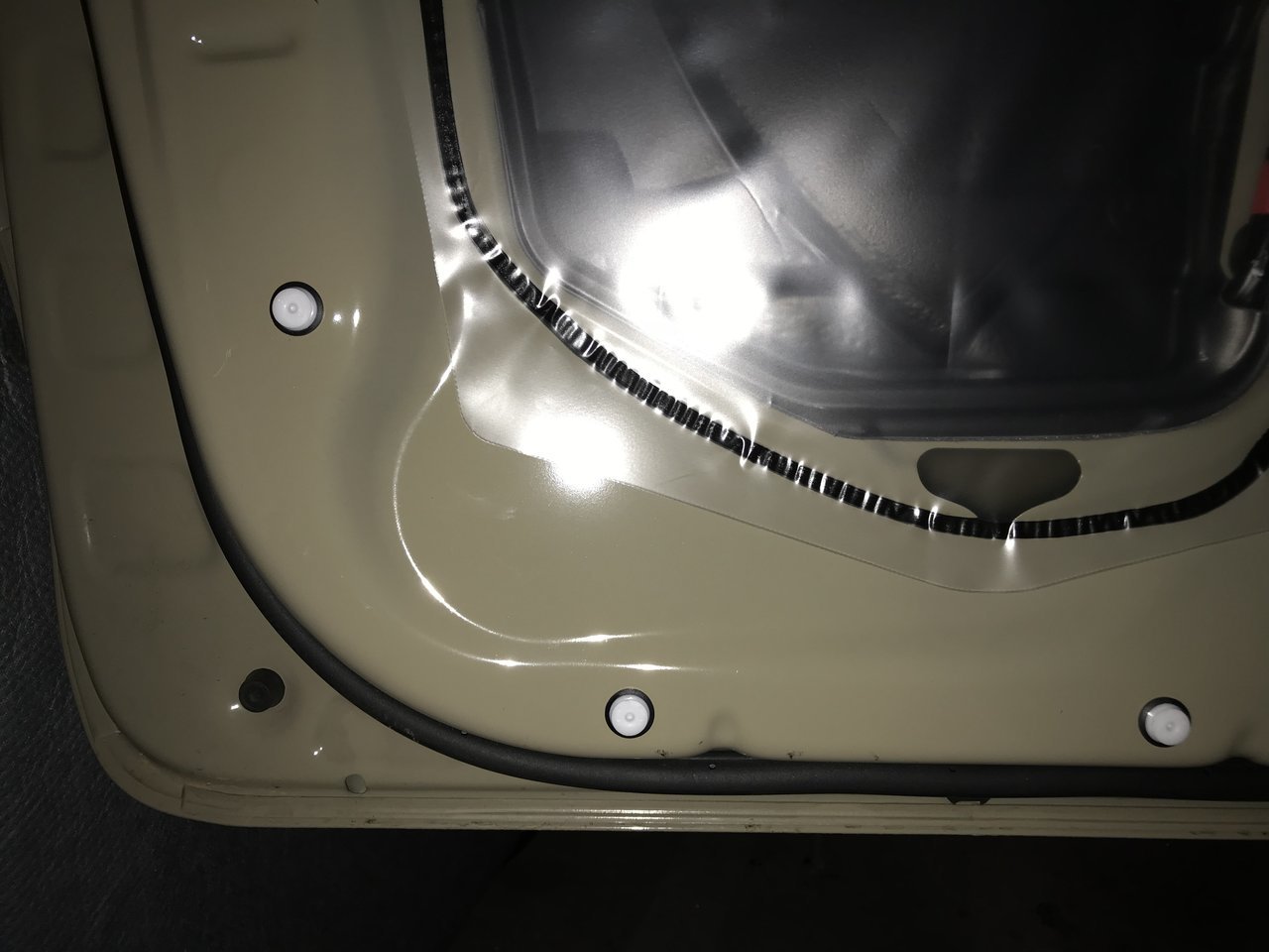

    So here is some more of my tips for those who aren’t experienced with this stuff. Or who are nervous to go at it.
    Removing the panels of the doors is not easy. Maybe my plugs were extra tough or I was doing it wrong. But on all my doors several of the white plugs didn’t pull out of the door. Rather I pulled the back of the plug out of the panel. So they’d be left in the door and I’d remove them with the tools. DO NOT ATTEMPT THIS WITHOUT THE ORANGE TOOLS OR SOMETHING SIMILAR. I can’t imagine doing it without them. And the little pick tool was a HUGE help. I’d use it to mark the Noico so I would know where to cut things.
    dziner and Technique like this.

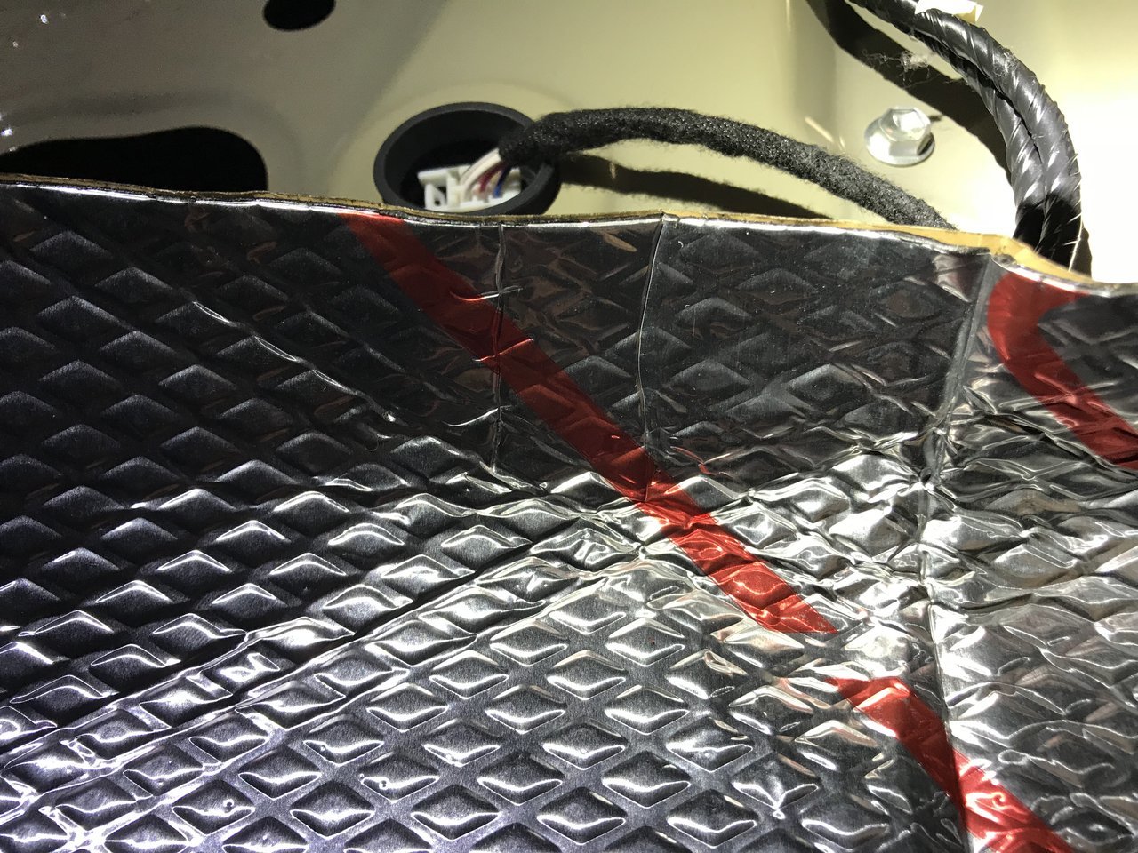

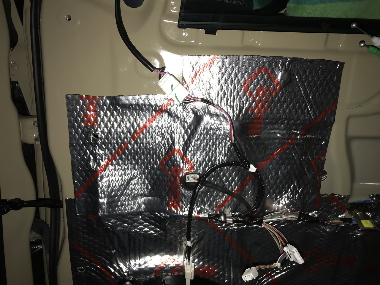

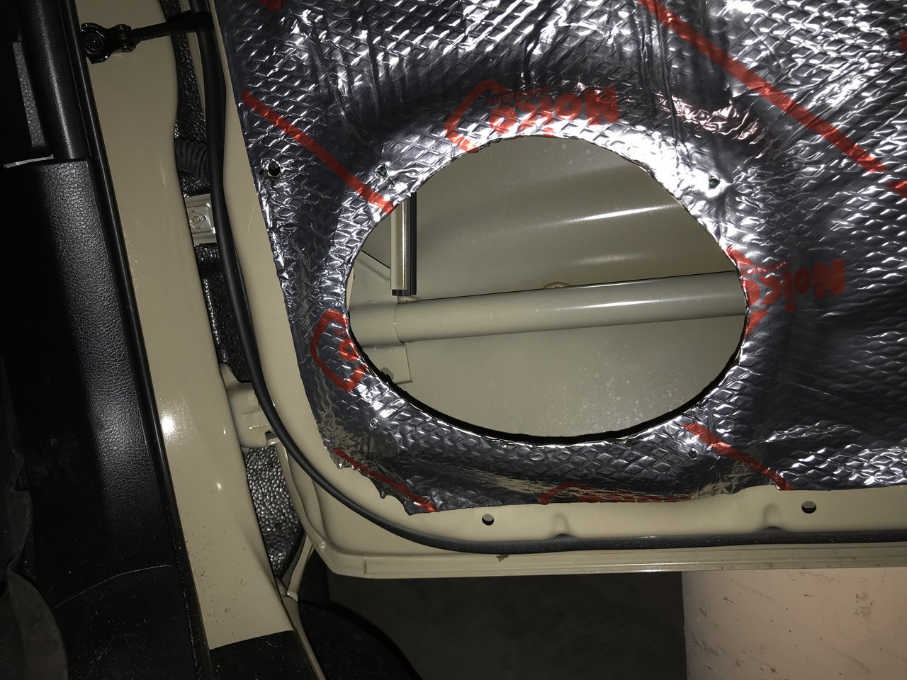

  20. Dec 3, 2017 at 10:50 PM
    #1320
    Pikestaco
    Pikestaco Newbie
    Dec 29, 2016
    #206007
    1,100
    Los Angeles
    When applying the Noico I recommend holding it up and marking and pushing on the Noico where you need to make cuts. The product is pretty amazing. Where there were little circles I’d unplug the wire and push on the Noico and after have a mark where to cut out. Also. Don’t try to cover everything with full sheets. I would use a full sheet for the bottom area covering the speaker hole. From there I would mostly use half sheets to do the rest. And save all your extra pieces you cut. You can use them to cover where wires come out and other little spots.
