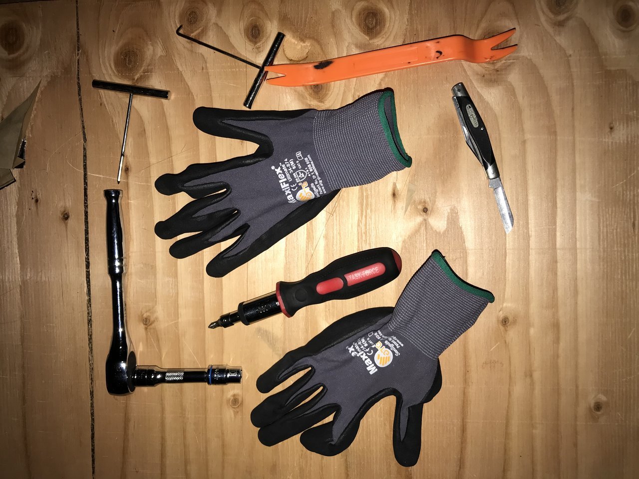

    Lastly. At a MINIMUM you will need all these things. I really couldn’t imagine doing it without these. And expect your fingers to hurt after. I used the back of the orange pry tool to smooth out my Noico. Worked pretty well. Sure a roller would work better but I didn’t have one.

    And I would say if you’re like me. Set aside at least 6 hours. I believe it took me in prep, searching for answers on things like the brackets for the speakers and which screws to use, (I used black ones with the little flat backs for front speakers and shorter black ones with no backs for rear speakers) and doing the tweeters also and clean up almost 7 hours.

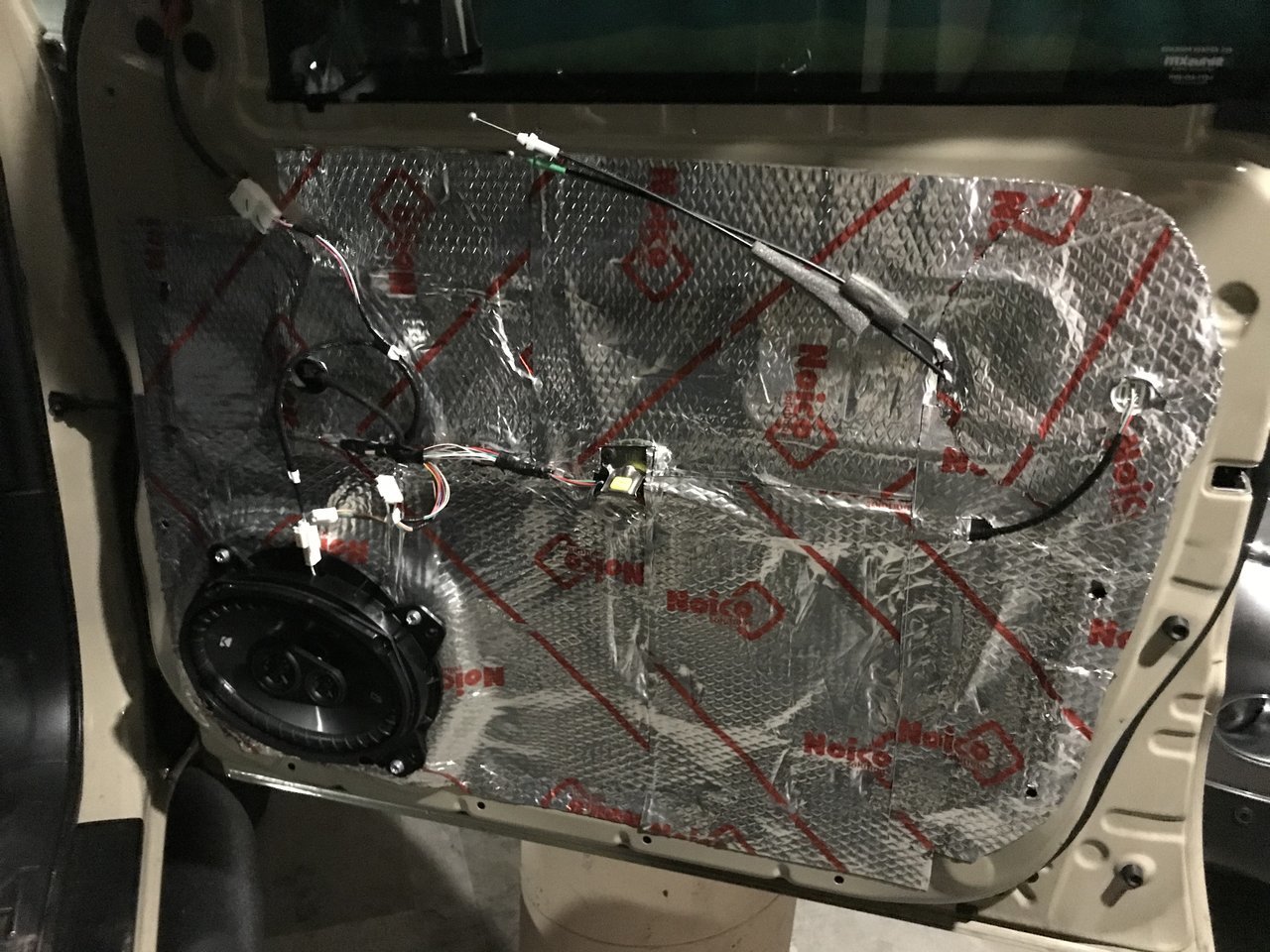

    Kudos to you, that is one hell of a good job. Now you also need to install a foam or Noico pad on the inside surface of the door panel, behind the speaker, to cancel out sound waves from the back of the speaker that will bounce around inside the door. Foam is actually better for this application than Noico/Dynamat... the foil will reflect sound waves even though the pad will cancel vibrations in the door skin sheet metal. So, get some cheap closed cell foam padding or "egg crate" acoustic foam tile and glue it on with contact cement.

    Yeah, that is a clean install - well-done Pike's! On the door energy, here's some discussion on a cheap & easy solution: http://www.diymobileaudio.com/forum...on/372914-more-door-treatments-guy-legit.html
    MOST deadening in a vehicle is pretty pricey, but this seems to be the lone exception.

    That's a pretty cool DIY project. It's amazing to hear the difference when he taps on the front door vs. the quarter panel vs. the rear door. That front door has a nice solid thud to it.
