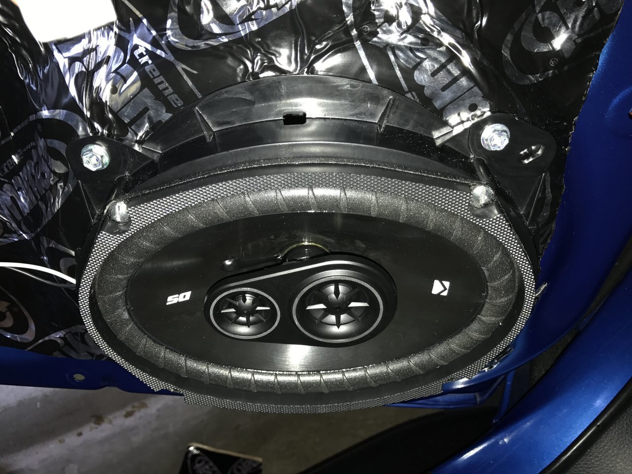

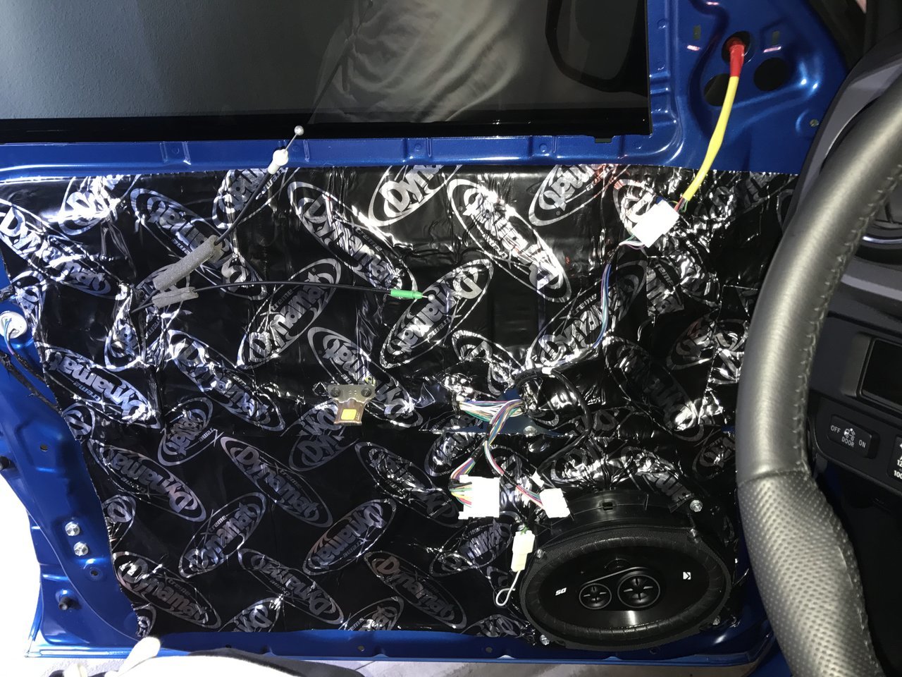

    You need two Dynamat extreme 10435 kits. One Dynamat 10007 roller, a good sharp utility knife, and a pair of scissors. Amazon or eBay depending on the best deal. More than a couple good YouTube videos on how to do it. Just search installing Dynamat extreme. Also search 2016 tacoma removal of door panels. ********* has a couple good ones. Make sure you connect back up the door handle and door lock correctly before you snap the panel back on. And don't close the door before you check. IMG_3029.jpgIMG_3030.jpg

    Yikes! That's $144 on Amazon. You covered the whole door, is there a minimum amount or minimum place covered that you would go for? If not I guess I will install everything and then see if anything rattles.

    From what I have read do at least the area where the speakers bolt to. You can also check out DEI boom mat speaker baffles. Someone else posted about using them.
