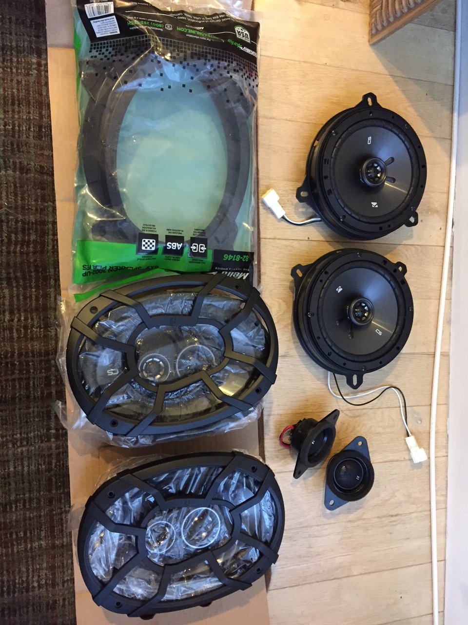

    Mine are for sale, the 6x9's were never installed and tweeters and rear door coaxials were only on for a couple of weeks , includes all adapters and connectors $175.00IMG_2704.jpg
