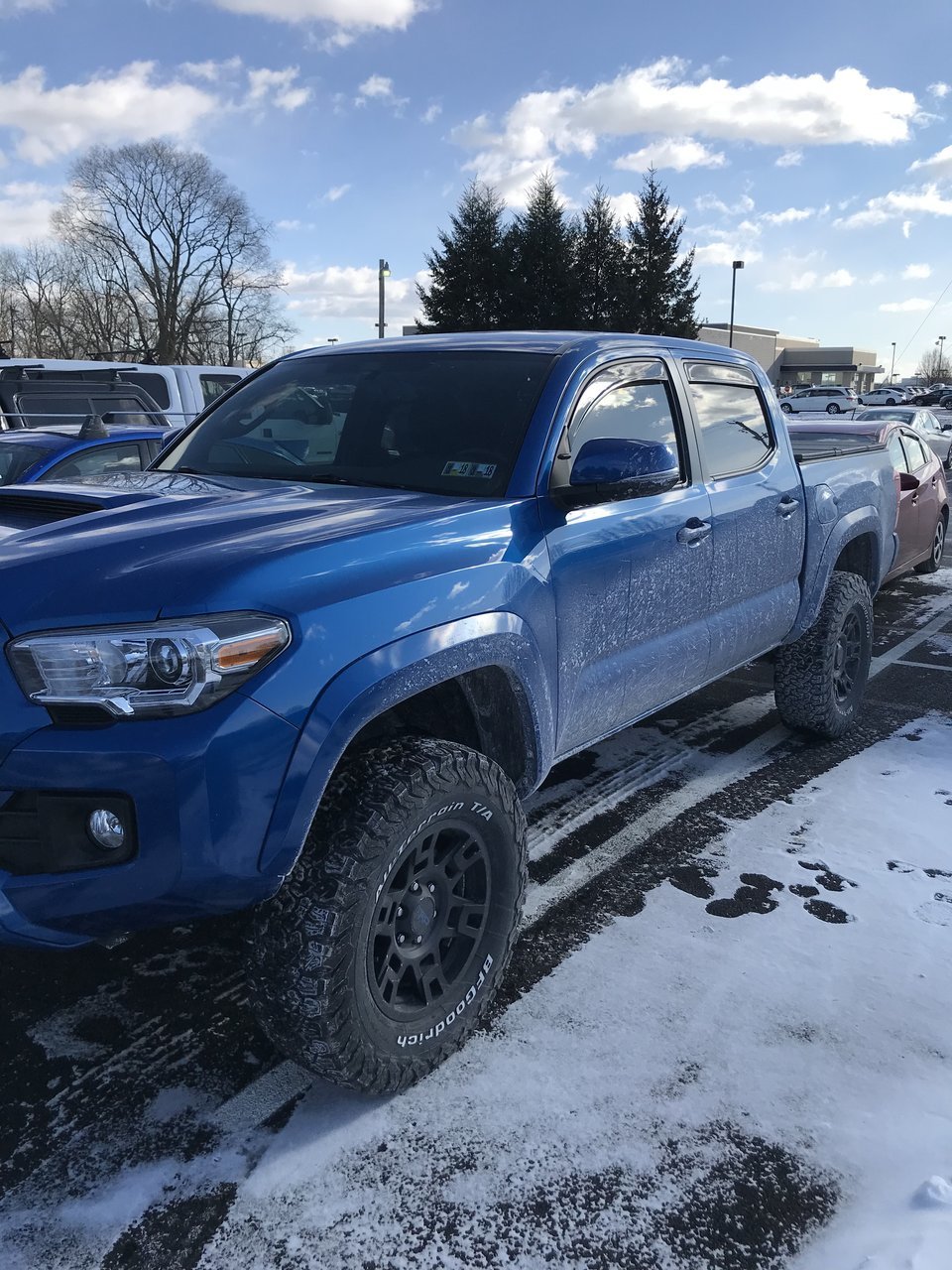

    Yeah. Here is my current situation. The amount of salt they use is just unbelievable. I can feel it slowly eating my truck away.

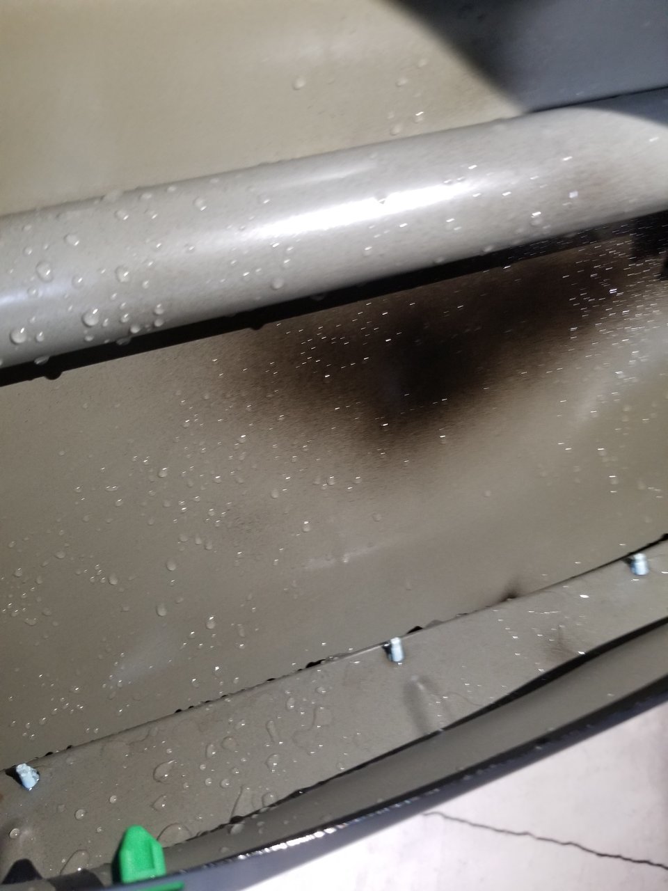

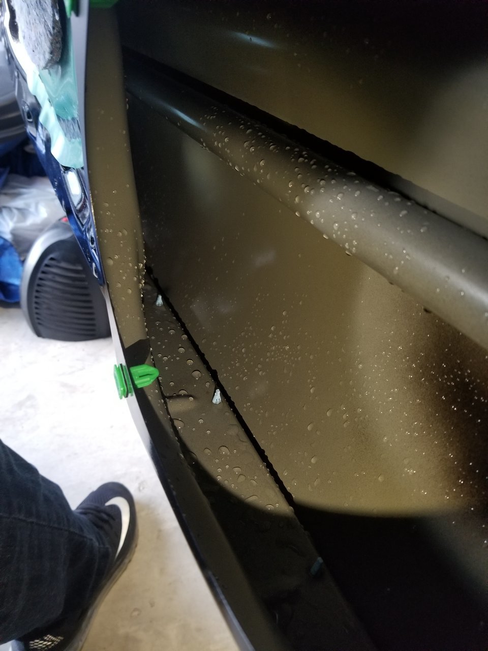

    I have a one week old 2017 trd or DC. So I got all the recommended speakers. I installed the tweeters then moved to the doors. Opened up the door to find moisture inside the door frame on both the driver and passenger side. Anybody else have this issue?

    That is un-nerving, but completely normal. If you look, you will see that there are gaps at the front and rear edges of the rubber window scraper where water can go right in. There are also holes all across the bottom edge of the door to let water escape.

    This is completely normal and is why you should never use wood or MDF for speaker rings, unless you liberally paint them with water-resistant paint. (learned this from experience...lol) You'd be surprised how big the wood can expand.
    If you look at the bottom of the door where the inner and outer skins connect, you will see small holes along the bottom...those are drainage holes. Make sure you do NOT seal/cover those with the sound deadening!!!
