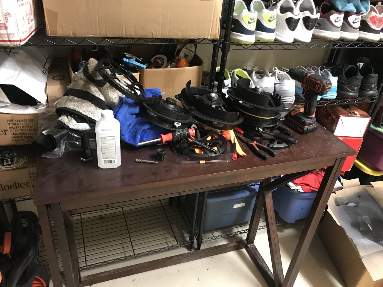

    So I just finished this tonight. Had the tweeters in for about 5 days before I installed the kicker speakers. I’ll start off by saying that this was way harder than it’s written up to be. Maybe I got the wrong connectors from Crutchfield because I had to splice the small speaker connector from the kicker box to the Crutchfield adapter. The small one wouldn’t go on all 4 speakers, I had to do it to all 4. The bigger one slid on but the little ones did not. I was bending the housing on the speaker trying to get it on, so I just said fuck it, cut it off & spliced it to the one that came in the kicker box.
    I’d say that was about and hour or so with that, then I realized that I didn’t need the stock kicker speaker housing, which I drilled on & tried to put my door back together with no avail. So I took that off, put door back together & the speaker didn’t work. At this point I almost gave up & put the old one back in place. I was half tempted to pay someone to do it for me. Fuck it, the tweeters sounded really good alone anways, maybe I’ll send these back I thought to myself.
    I re-pulled the entire door & the speaker. I noticed my stupid spliced wire had become disconnected. I re inserted it & tried again, it worked. I then went on to finish the job. It definitely gets easier the more you do it, as has been said.

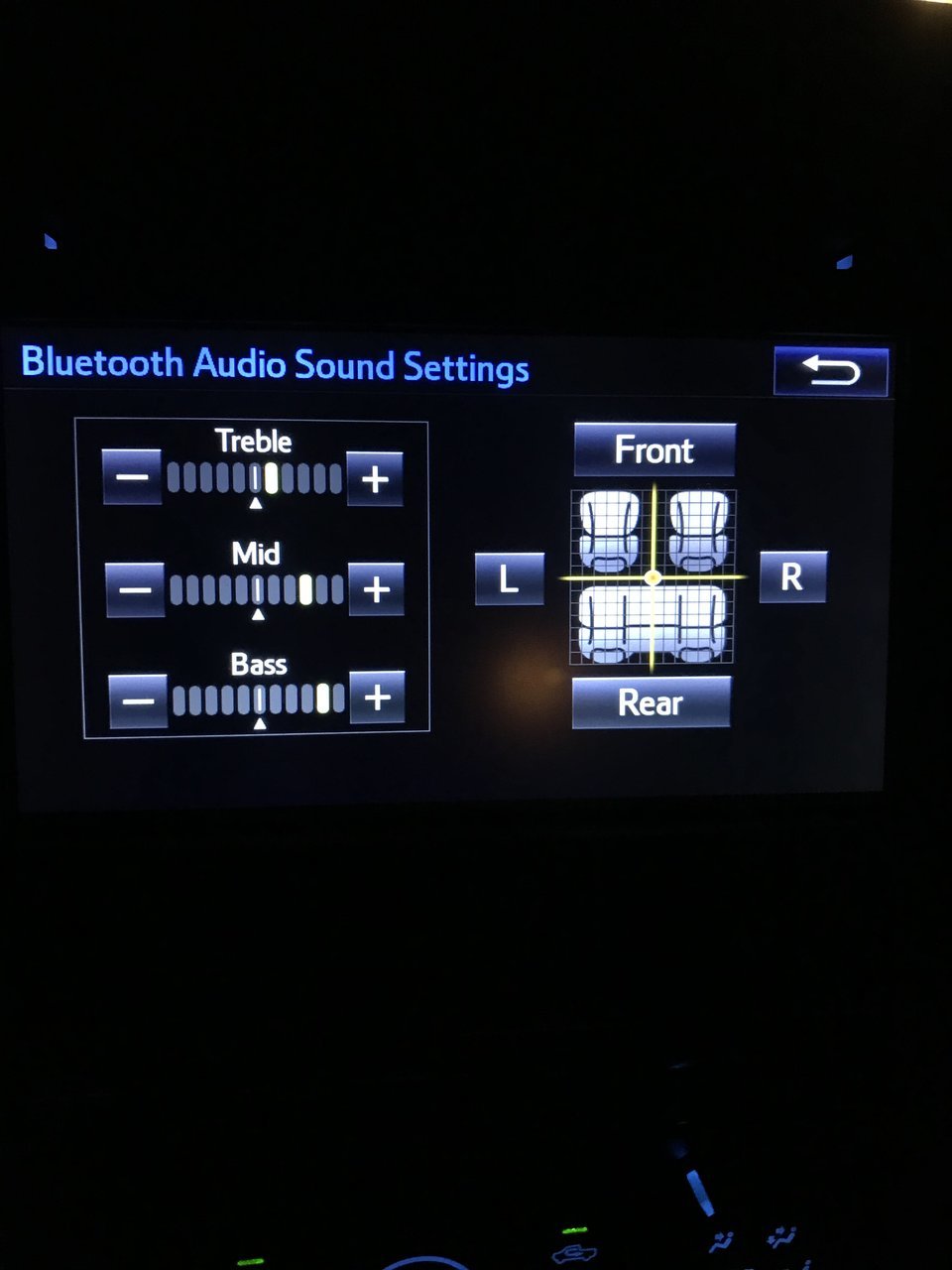

    With all that being said, I’m not that thrilled. The bass is definitely not ass deep anymore & I feel like the front left speaker is quieter & possibly messed up. Maybe because of the way I had to install it. It’s very crisp when it’s loud which is better but now I feel like I need to add a sub (8”/10”). I’ll know more about the entire result tomorrow once I drive around with it all day.
    Im attaching the best EQ I found in 45 seconds of messing with it, what’s everyone else running EQ wise?
    This took about 4 hours & it’s beer drinking time now.

    You have a lot of sneakers.

    I can’t remember but I’m pretty sure I tried every way with the little ones, if it didn’t work I’d flip it. No way I had bad luck 4 times in a row.
    Those are golf shoes (that’s why they’re in the garage) & most of them came from Burlington Coat factory when they had a Nike surplus. Only $20 a piece so I loaded up, I love golfwrx forums as much as tacomaworld.

    I have my EQ settings exactly where yours are and it sounds great. True you do need to tone down the treble a bit vs. mids and bass so it isn't overpowering but the EQ does a good job (for me) balancing it all out with these settings. I would agree the bass does tend to break in a bit the more you listen to it. I thought about a sub for a bit but the bass is so good for my tastes as-is I don't plan on messing w/ any other audio stuff the time being. Sorry you had pains w/ the connectors to the speakers, definitely shouldn't have any loss of fidelity or volume on left vs. right so there probably was something to the install steps you had to take. I guess the good thing now is that once you've done them once, it takes all of 5 minutes to pull the doors back apart if you want to make a change.
    Good luck!
