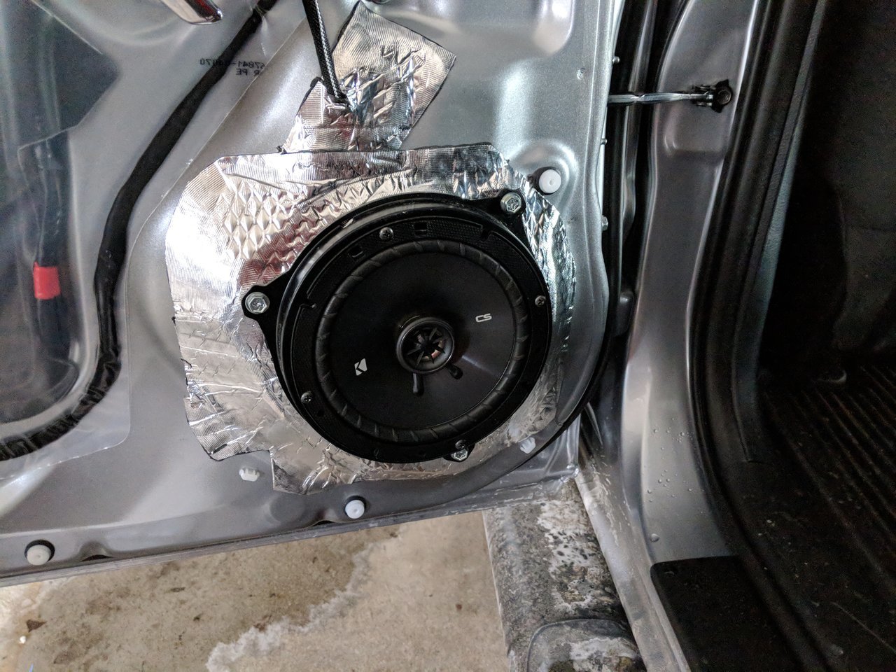

    This is my 2018 DC with the kicker speakers with the crutchfield supplied adapters and the OEM screws.

    So they definitely sent me the wrong kit. My rear doors had 2 places on all 3 screw sites to try & use to match up the holes to the door. I had to spin the damn thing & find out which way I needed to place it to tighten my screws. My front doors were the same thing. Neither front nor back housing they sent actually fit into the doors, they both jutted out and the speakers went into them. I’ll have to re-pull a door & see if I have to jam the Crutchfield housing into the door? Shouldn’t I have noticed that it fits right in? It definitely didn’t...

    They are left side right side specific. Also, the tabs on the inner ring need to be pulled. You can do this by bending up with a pair of pliers.

    Wow, don’t remember seeing that on here or in the directions. I didn’t do any of that & didn’t know they were L/R specific. Probably why my install was fubar. I’ll go back & check my Crutchfield email with the install directions. Thanks

    I didn't see it in the instructions. I put one up to the hole and it didn't line up. So I switched to the other one. But I had the same issue in my tundra when I did the system in that truck.

    I'm not being a dick here.
    You have them upside down. The last picture is correct. Break the tabs in The inner ring by bending them.
    Zoom in on this picture:
