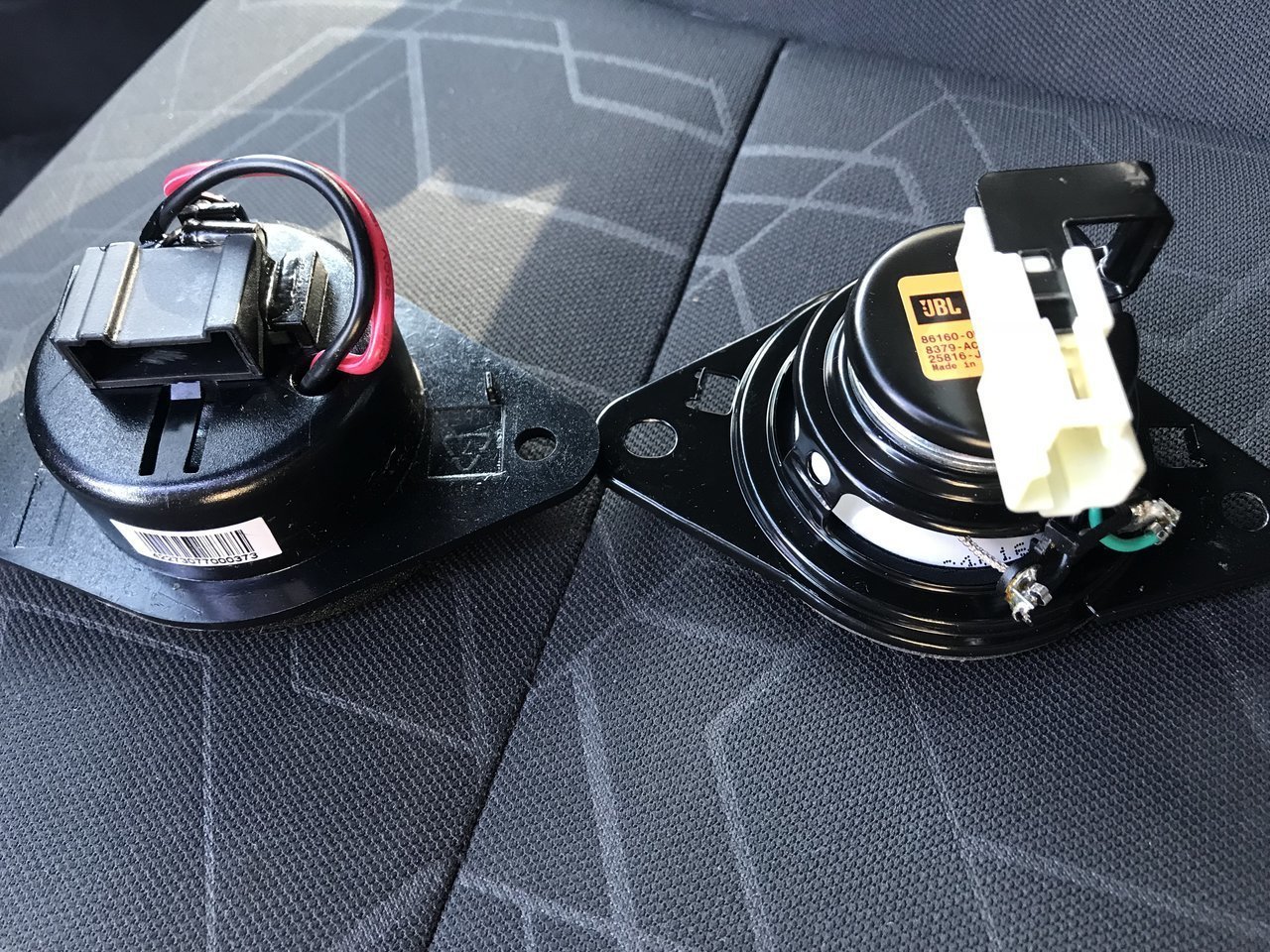

    What aftermarket tweeters are used for the JBL system ? Is there a plug and play set up like the Subaru H631SFJ101.
    Can the kickers referred to in this thread be used with the JBL system? Thanks in Advance great information in here.

    Pic taken from another forum member. Kicker/Subaru replacement on left, JBL tweeter in the right.
    You will have to splice aftermarket tweeter to factory speaker wiring.
    Aftermarket tweeter can be mounted with a universal back strap or get tweeter adapters from Mr. Marv.

    The question is where do the two spliced wires go on the 4 pin.

    You can remove the connector from the stock tweeter. The pos/neg of your new tweeter will connect to the pos/neg of the connector you removed from stock speaker. Connect the harness back to the connector. Solder everything, use heat shrink tubing and should
    look pretty good. This will allow you to work on the wiring outside of the vehicle versus fighting limited slack on the stock harness.
