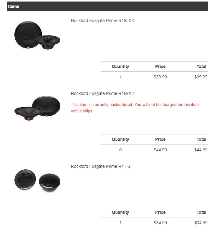

    I went with Rockford primes from crutchfield. I can't believe how much better even the primes sound. I did make my own tweeter adapters out of a cutting board.

    No the kickers CS 6x9s for the fronts are to deep per crutchfield. That's the reason I went rockford.

    The 6x9's and 6.5's are plug and play. Just have to put the speakers in the brackets and plug up the wires.
    The tweeters are not. I cut factory tweeter wire and ran it to the new tweeter. No big deal. Then i made a bracket for the new tweeter. You can buy them from taco tunes also.

    6.5 3 Way Rear Doors
    https://www.crutchfield.com/p_575R165X3/Rockford-Fosgate-Prime-R165X3.html?tp=78072&omnews=14684828
    6x9 2 Way Front Doors
    https://www.crutchfield.com/p_575R169X2/Rockford-Fosgate-Prime-R169X2.html?tp=91&omnews=14684828
    Tweets - you will need to order or make brackets for these (I used a thin cutting board from the dollar store and used the factory bracket as a template.)
    https://www.crutchfield.com/p_575R1TS/Rockford-Fosgate-Prime-R1T-S.html?tp=107&omnews=14684828
    This is a good option if you are keeping your factory head unit.
