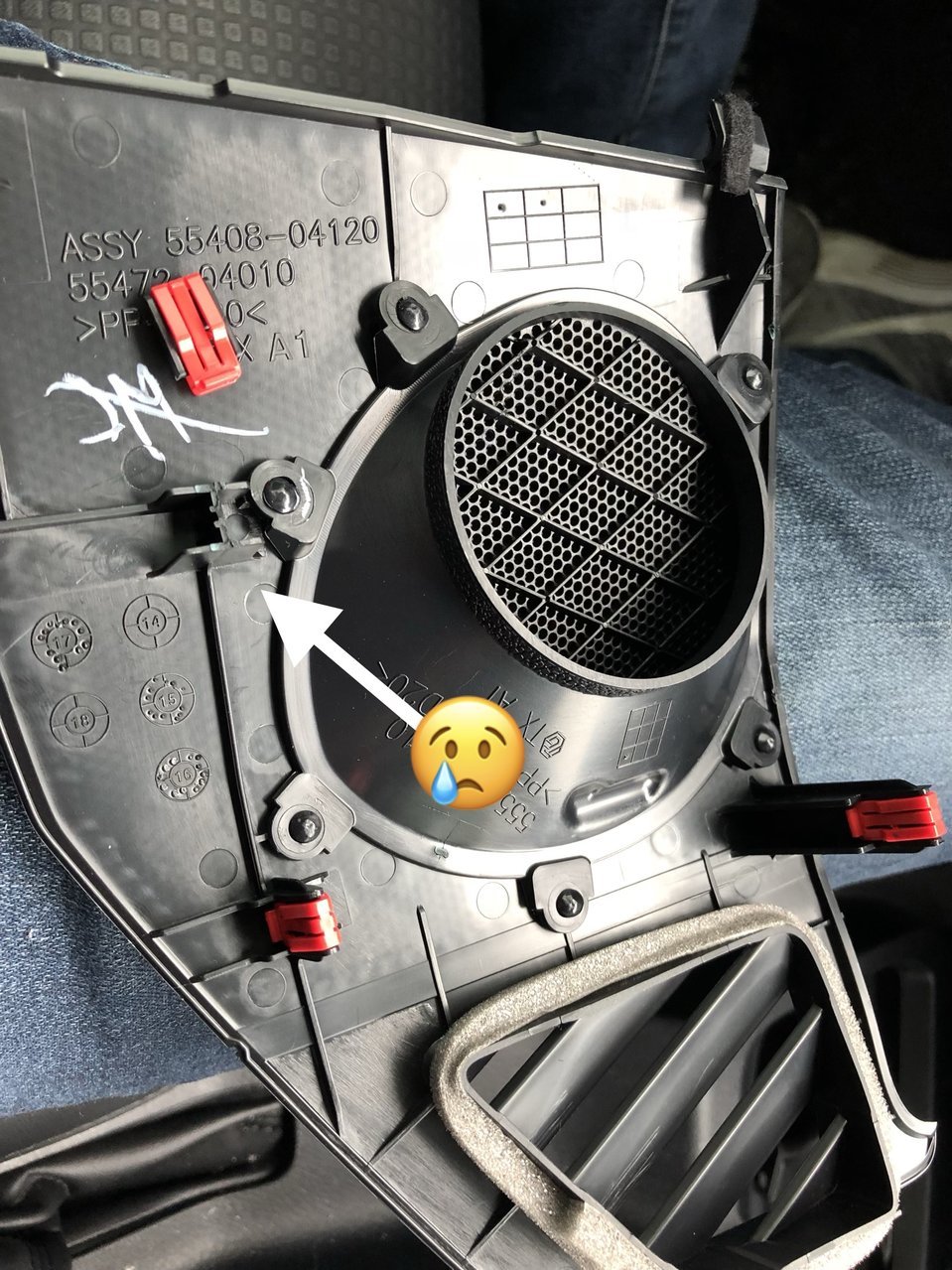

    Got the tweeters installed with only one casualty13F5576E-04B9-434B-B4D8-857E74CCFFC4.jpg

    Did you leave the a pillar on?

    Nope

    Take the red tab off, super glue it and give it time to cure. Should be ok not much tension on that clip.

    I just reinstalled without that clip. Seems to be fine, must have been one of those optional ones
