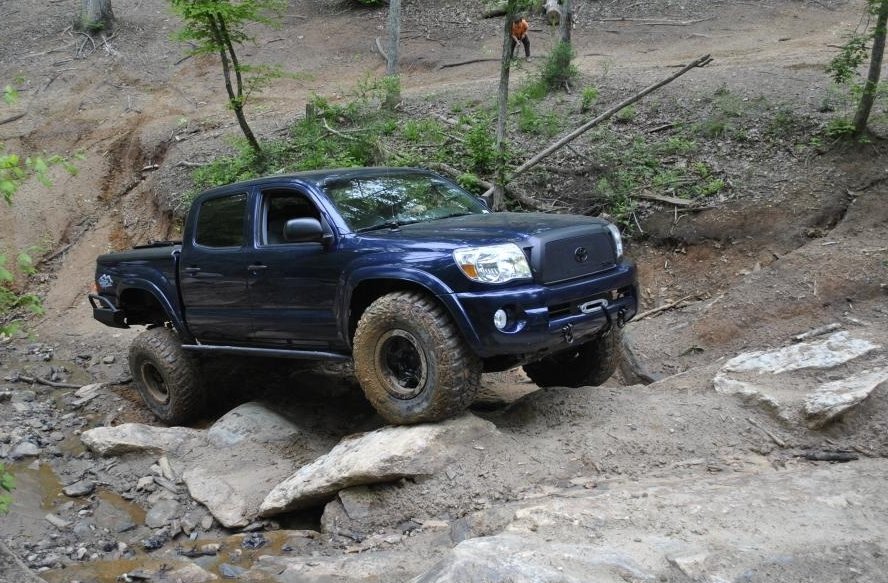

    After running it for some time now, I don't have any need to fill that gap. The flares are very stable with just the clips holding them on - and cleaning out the gap after going through mud is no big deal with the power washer. Some day I would like to do liners, but that's on the list of things to do when I run out of other things to do... :)

    I got pretty sick of running around without liners. Ended up cutting up the old ones and riveting them in, worked pretty well. It helped stiffen up things too. Things stay a LOT cleaner.
    I guess that doesn't help for the flare to fender portion but mine are capped so??
    Also, 315s barely rubbed the flare, I'd have gone 2.5" if I had known. I don't think 3" is needed though.

    Getting ready to do this to mine, so you recommend a jigsaw over a dremel tool?

    go at it with a jigsaw and maybe touch it up with the dremel after. just a thought

    Jigsaw. Nice new blade cuts through the fender like butter.

    I found that rubber door seal works really well to fill the gap between the fender flare and the fender. I used a little silicone just to keep things stuck. Looks good too. You can order it from Napa
