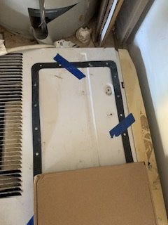

    It’s funny
    All parts I’m getting,come in these boxes that are as old as the taco!
    decided to make gasket flat by taping and putting weight over it
    Was folded up in box for 25years
    Still soft, not perished/no cracking

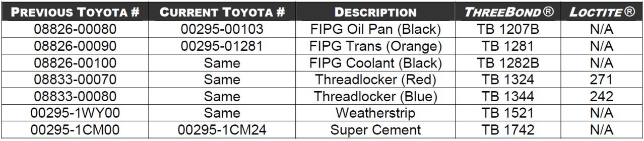

    FIPG for the pan; it's what Toyota used and it'll work well for another 2-300k miles.

    For anyone in the future.
    Here is what Toyota uses.
    I haven’t used the any of the actual Toyota or ThreeBond brand. (EXPENSIVE)
    I run down to the local auto parts store and buy the Permatex brand that fits my needs.

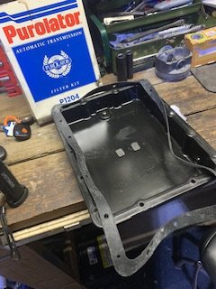

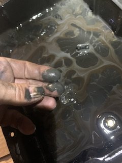

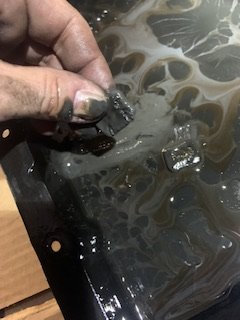

    Well
    As with pretty much all my wrenching tasks……started out like a dream
    Dipstick housing out/cleaned
    Pan dropped with 2-3 mallet taps
    Then things went downhill
    1st- ewe(daughter got me saying)
  20. Sep 8, 2023 at 8:58 PM
    #20
    ControlCar
    ControlCar [OP] My Moto: Help & Learn…period.
    Jul 22, 2023
    #429578
    3,496
    Steven
    Sugar Land TX
    1996 Taco 2.4L 2wd Automatic
    Clock Volt meter/LSPV Delete/Hyundai 16’s/FP gauge/after 9months of wrenching ZERO oil leaks
    I’m wasn’t expecting anything red
    But that gray not good
    Marched on….thinking about budgeting for tht 3-4 gallons of T fluid.
    Cleaned pan thoroughly
