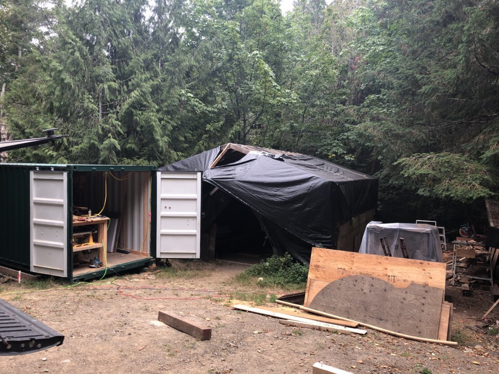

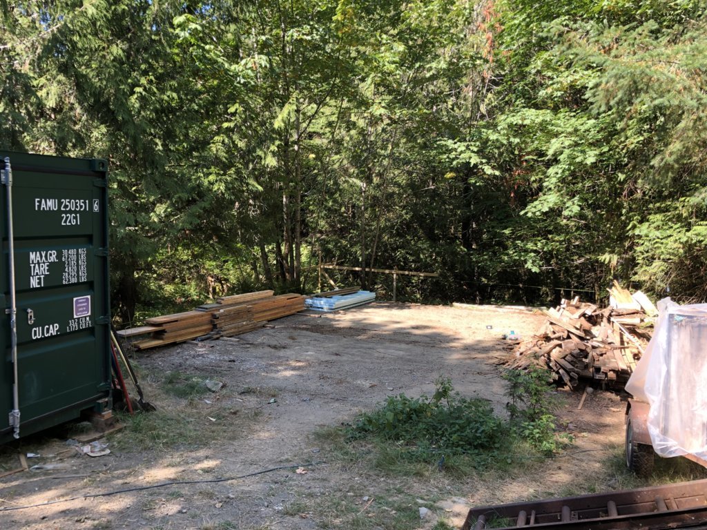

    I've had a "temporary" storage contraption in my back 40 for about 15 years , basically a wood framework with a heavy tarp over it to store assorted lumber , formwork , concrete accessories , etc .
    So job #1 was to find a home for all the shit I had stored in there so I could tear that down and build the new building in the same area .
    I got my 8x20 container moved back to that site to store the more moisture sensitive materials
    Here is the old shack and container

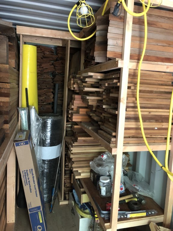

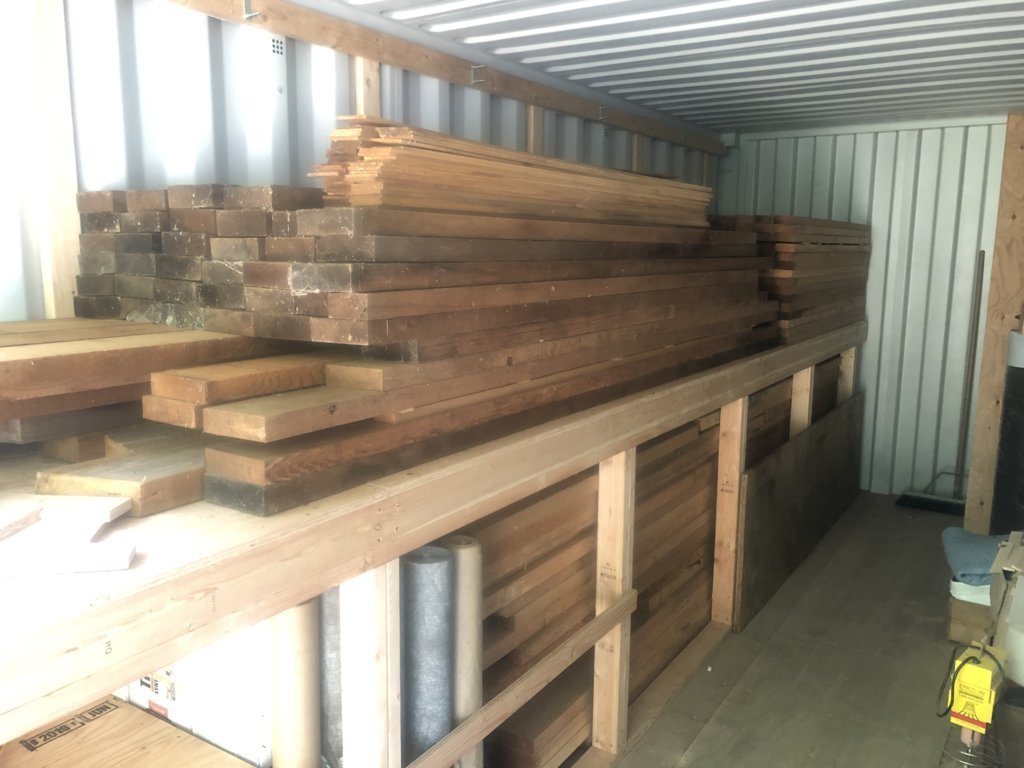

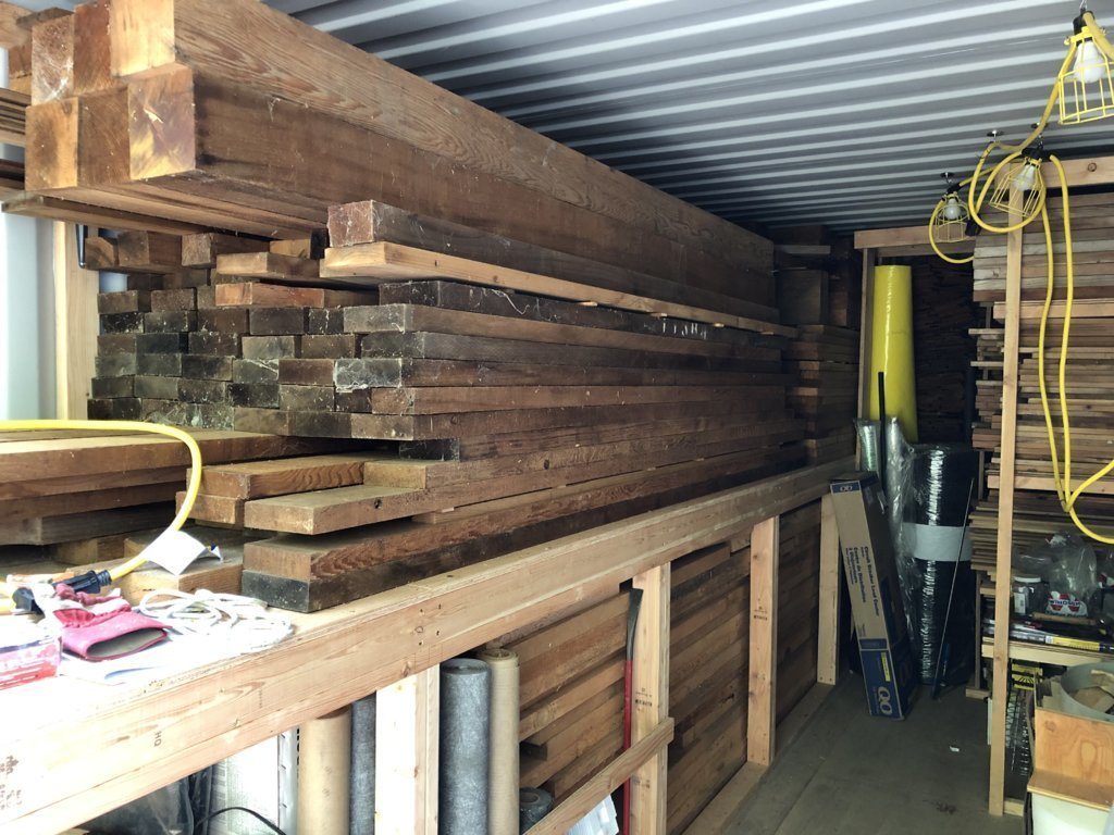

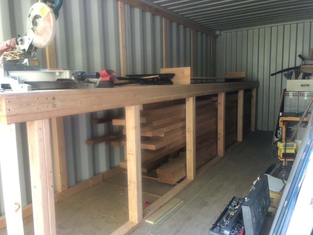

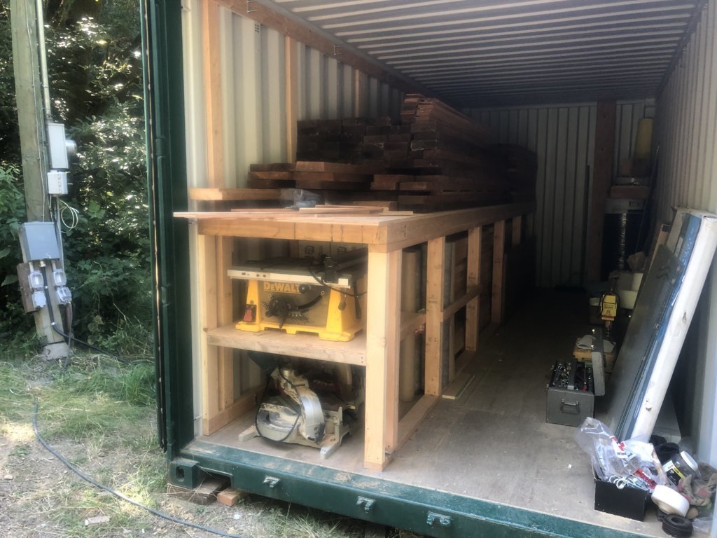

    I built some storage racks in the container to maximize my storage plus allow me to keep my fir materials and cedar materials separated
    Full 2" random width VG Fir on the bottom
    Cedar materials up top

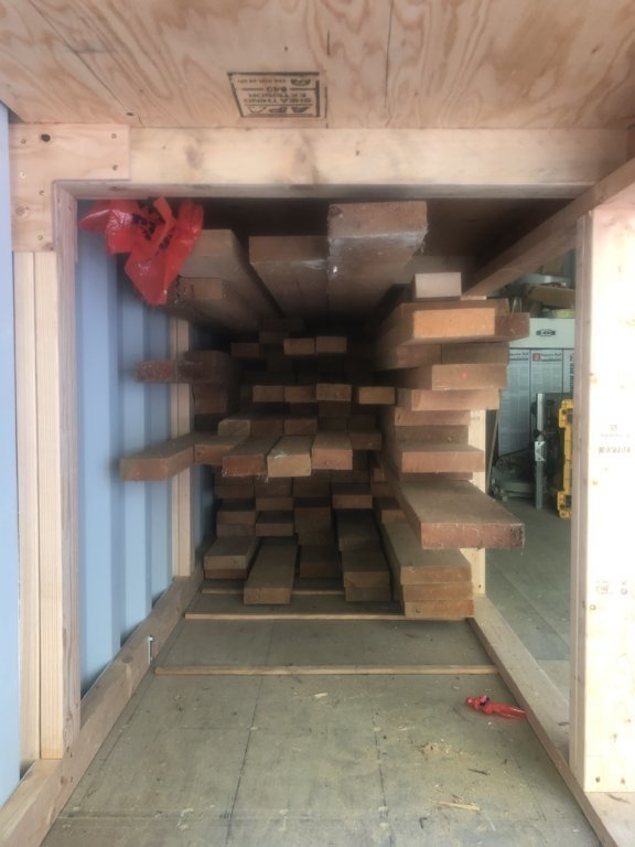

    and I rigged the end so I could store and easily get at my tablesaw and chopsaw by just opening the left door
    and as always , you don't realize how much shit you have till you have to move it all haha
    That was the container material moved for the most part

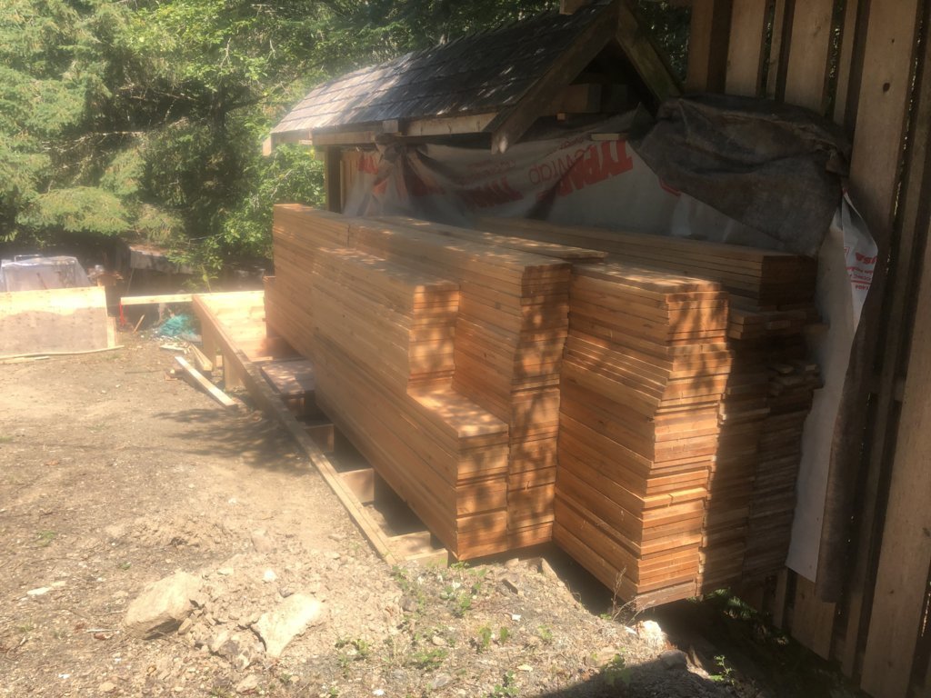

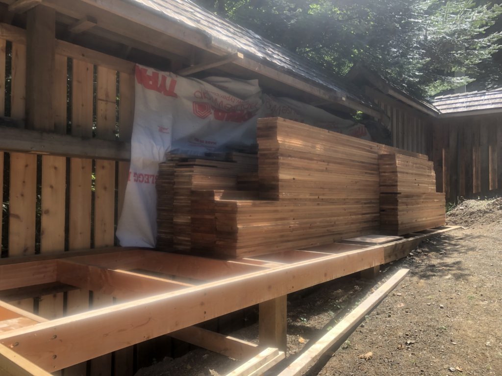

    Next up I still had a shit ton more cedar to store so I improvised a lumber rack on the side of my existing fence line for all the 3/4 and 5/4 cedar boards
    Under that rack I managed to tuck away my collection of clear cedar 6x6

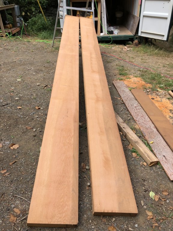

    Stuffed these beauty bookmatched clear cedar planks in the container on some shelf brackets up high

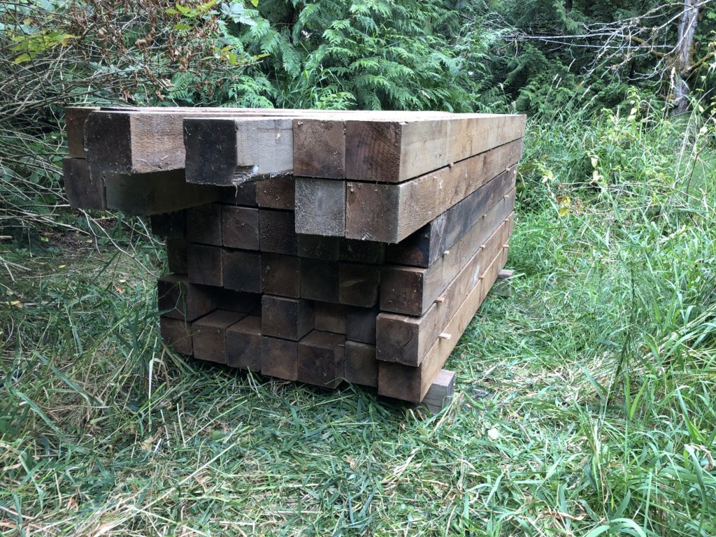

    The not so precious cedar 6x6 is roughing it outdoors

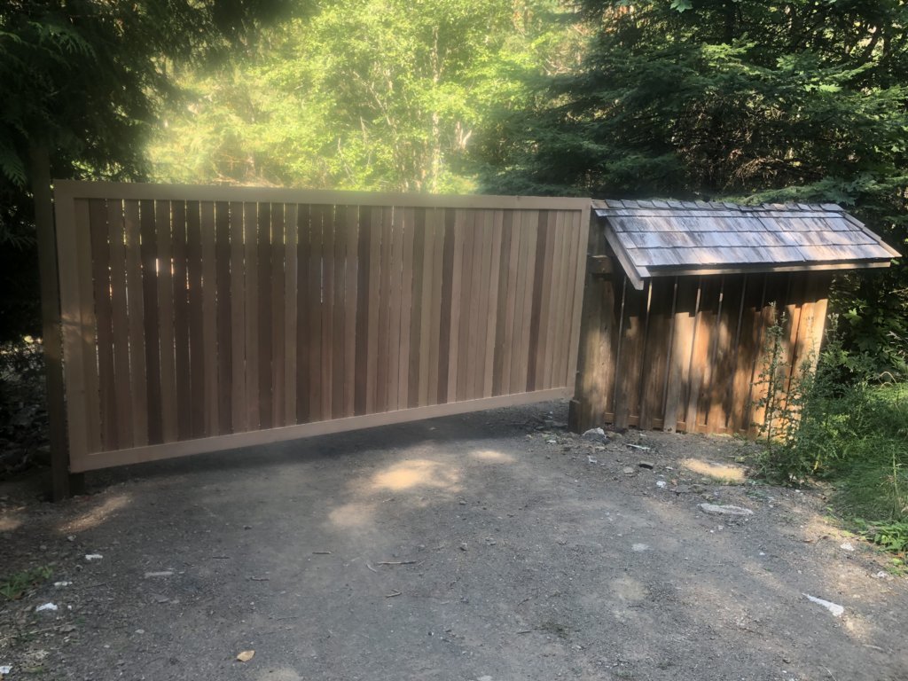

    and finally , my wife made me make a gate before I was allowed to start so the neighbourhood didn't have to witness my crap while I built the shop

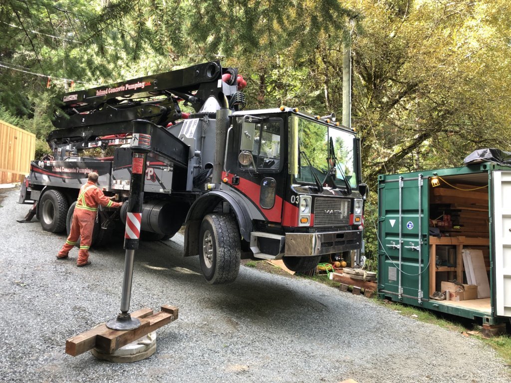

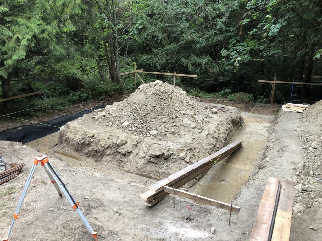

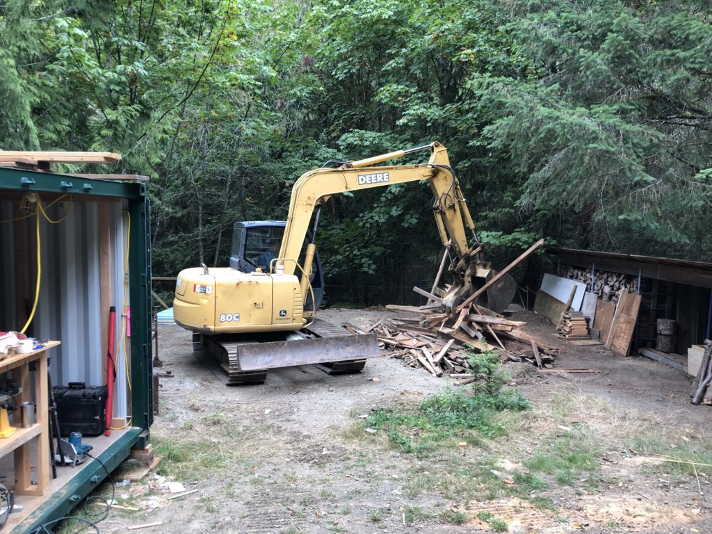

    I took down the old crap shack and got an excavator in to clean up and dig the excavation

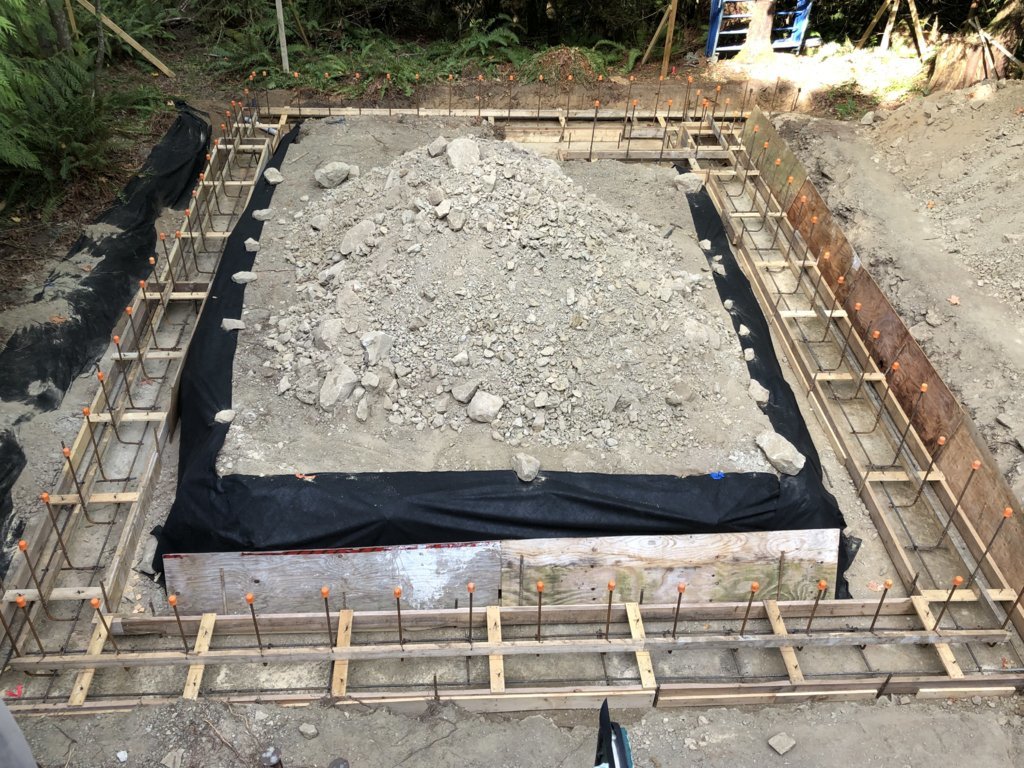

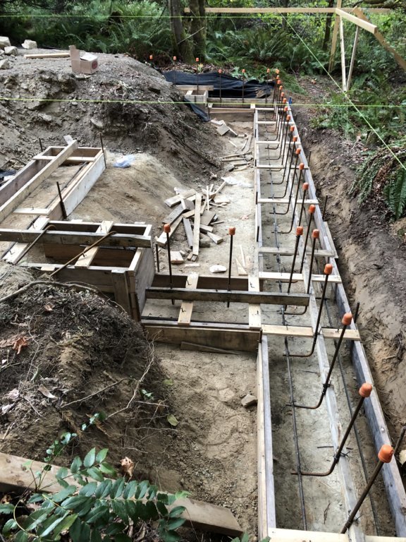

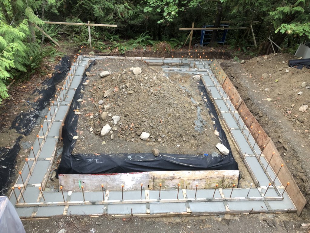

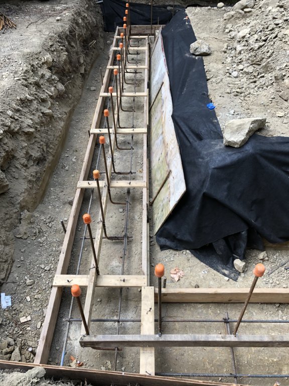

    Formed footings , reinforced with 15m (5/8") rebar
    and we poured footings with 28m boom pump

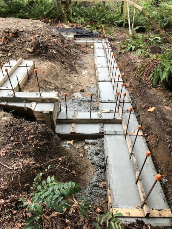

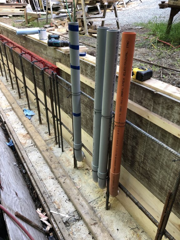

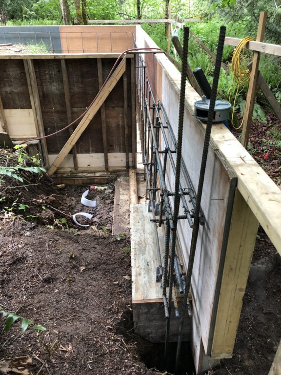

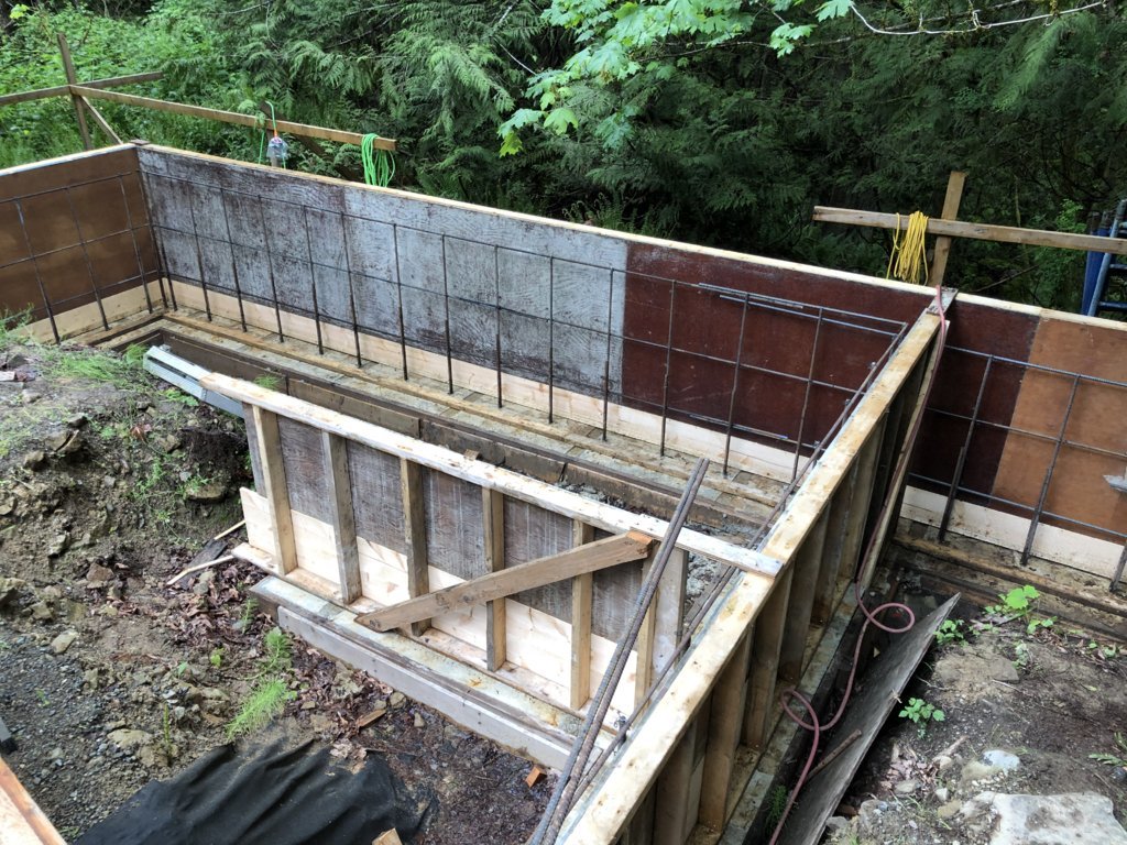

    Footing pour was in October of last year , I then got busy at work and with the rainy , dark season setting in I basically shut down work on the shop until last week when I resumed work on the foundation walls
    again , reinforced with 15m bar , 18" on centre each way
    In this location the back wall of the shop carries on and becomes a retaining wall for future covered outside storage overhang
    we're bridging over a big tree root here , hence all the extra rebar
    and yesterday I did the pipework for my utilities into the shop for electrical main in , power out for septic pump and spare plus teleduct for cable / tel
