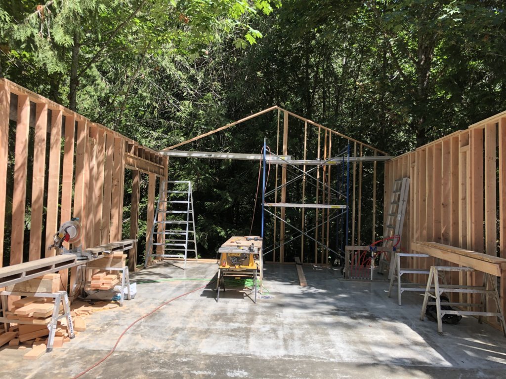

    Started back rake wall this morning

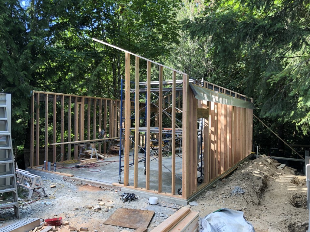

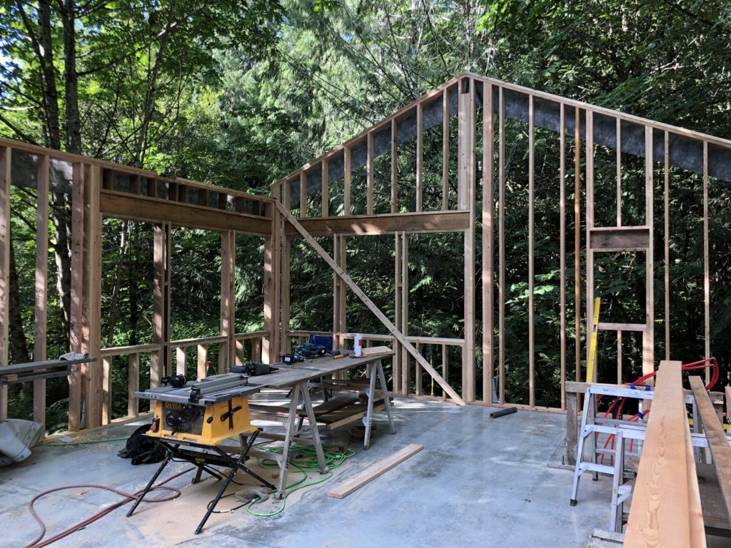

    Today I finished up the back rake wall framing , back framed the windows and plumbed and braced the rear rake wall
    I calculated my rake wall stud lengths for the front rake , and started building that this afternoon

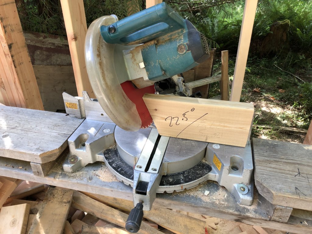

    This is my solution for old man eyes when I'm flipping the saw back and forth a lot from square to a bevel cut , cut an angled block and set the blade to that , no squinting at the bevel gauge because I can't find my glasses lol
    Will finish front rake wall in the morning , my 1/2" plywood gets delivered tomorrow so next step will be block and sheet the walls
