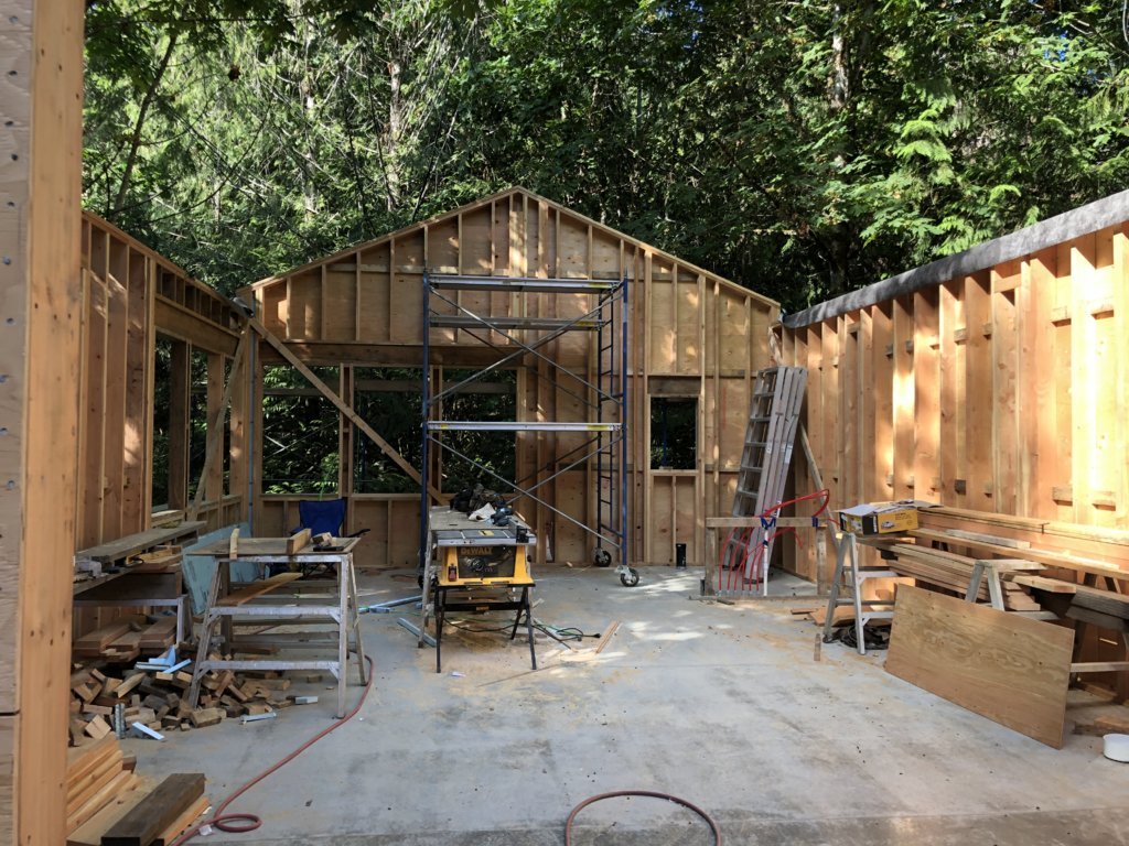

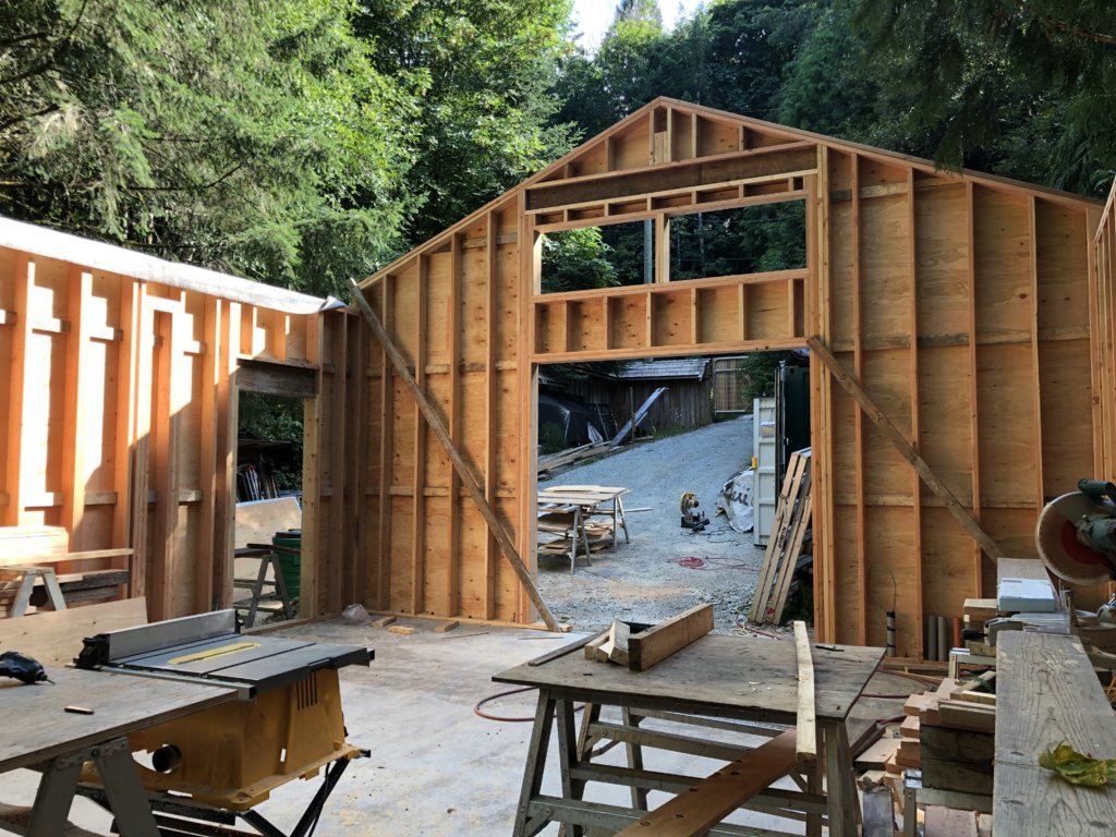

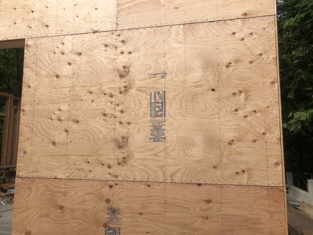

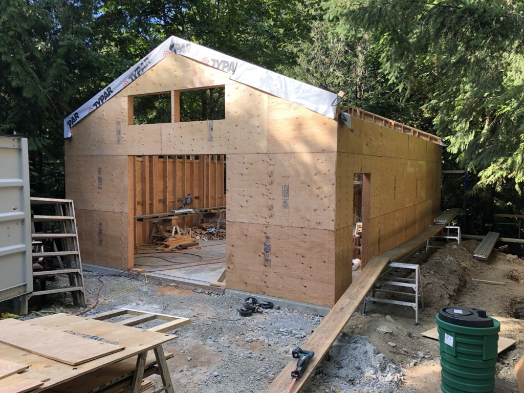

    Got all the wall sheathing pretty much complete , just a few odd ball pieces missing which I can clean up Monday
    Nailing schedule for the shearwalls is 2 1/2" on centre around the perimeter of the panels , 6" on centre in the field
    I managed to burn up a lot of nails I had laying around haha

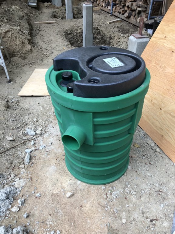

    Also my plumber stopped by today and dropped off the sewage pump chamber unit we are going to use
    Next week I will be starting the timber work for the timber trusses then I can start framing the roof

    You sheath before the rafters go on?

    Yes , usually the plywood is on the walls before we stand them . If the rafters were on it would be difficult to nail the plywood at the top plates

    Well that's not going to blow away in an earthquake.

    hope not
    this is pretty normal building practice in our area , I'm in the highest seismic requirement region for lateral restraint in Canada

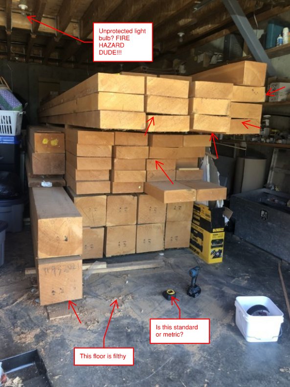

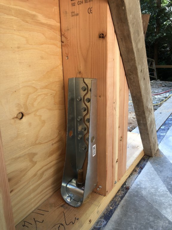

    Finished up installing and nailing of wall sheathing today , also installed all my Simpson HDU-5 hold downs , there are 9 total in the building
    Tomorrow we all get to go on a field trip to an OZTCO off site remote timber storage facility and pick through my timber stash to get the material we need for the beam work , should be fun , for your safety , please keep your hands , arms and legs inside the vehicle at all times .

    Are safety vests and hard hats required? Or can I show up in board shorts, flip flops and sunglasses drinking a beer and smoking a ciggy?

    Unacceptable cupping and twisting

    Why do the hold downs
    That it?
  18. Jul 28, 2020 at 12:12 PM
    #238
    Pchop
    Pchop Beavis Killer
    Sep 17, 2012
    #87171
    15,851
    Rob I
    Stuart, FL
    '09 Tacoma TRD
    Seismic

    brow
    brow Well-Known Member
    Apr 4, 2010
    #34580
    624
    Andy
    Minnesota
    2020 Dodge Ram 1500
    Very Jealous, my entire selection of decent wood consists of 4 8x8 cedar posts between 6'-8' that used to support my deck. One is destined to be my new mantle, the rest im just storing for fun i guess.
