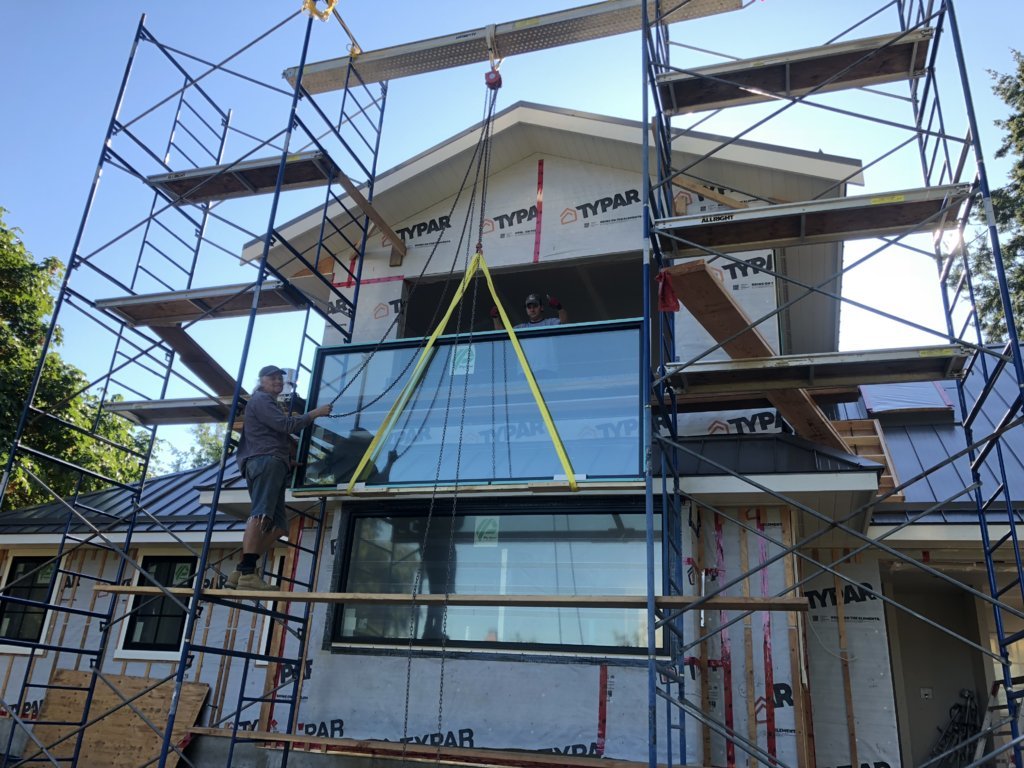

    Looks like a good idea, although not OSHA approved. Oh never mind I forgot you were above 49°N. I would do it like that too.
    BTW, I have never seen rebar or scaffolding with out rust. That must be nice to work with.

    I thought the rebar was pretty rusty , its been hanging around back there since our big concrete driveway job in 2017

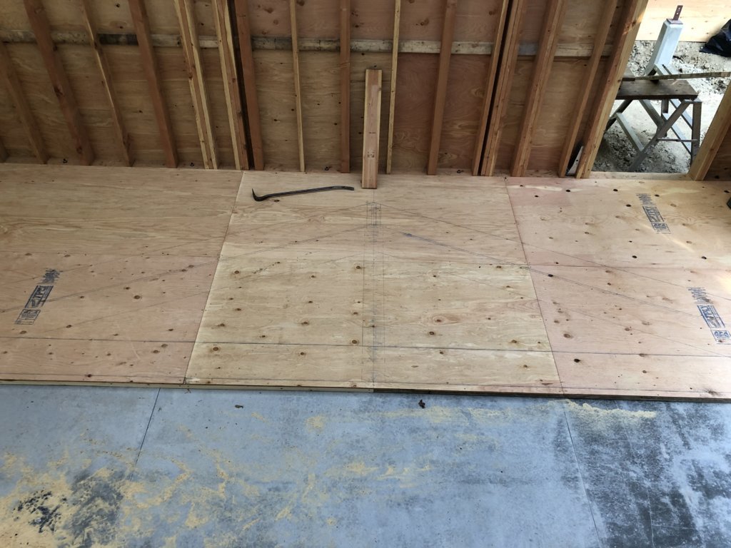

    Hard to see in the pic but today I made a 8'x24' plywood drawing board so I could lay out my timber trusses and rafter details full scale before I commit to cutting anything

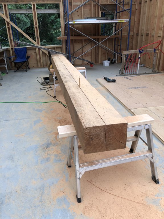

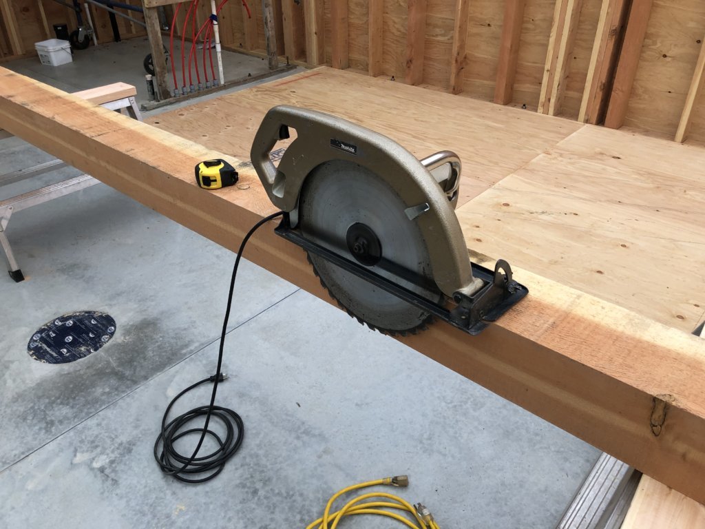

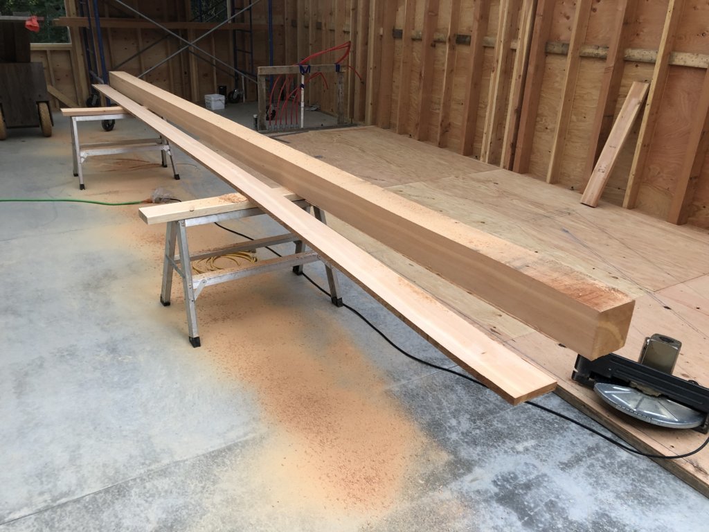

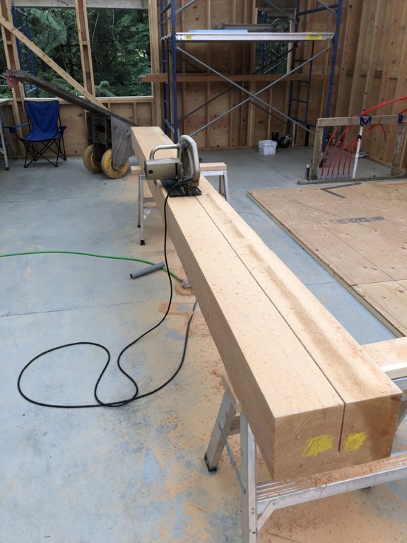

    Making 6x6 posts with my 16" Makita beam saw

    Yeah.
    I can smell that picture.

    Free hand or do you use a guide?

    rip guide

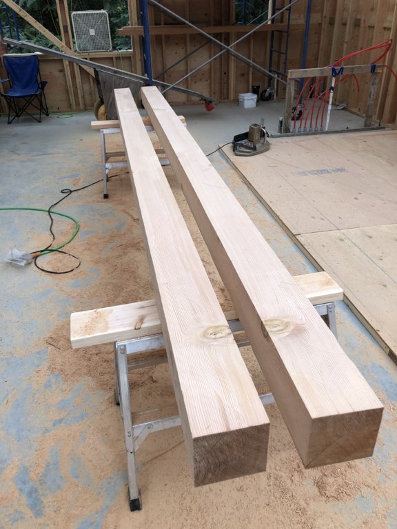

    2 down , 2 to go

    Well, it's certainly nice that you have a shop to build your shop in. :thumbsup:

    Cheaper to buy the beams than 6x6’s? Or are you going for an actual 6x6?

    He has a stockpile of beams that he high graded them from. He got them way cheaper back in '08 when the economy shit, probably expensive as fuck now.

    Last 2 came out of a single 8x14 I had

    The 14' 8x12 and 8x14 I ripped 3 of those 6x6 out of actually pre-date that 2008 timber purchase and the 20' 6x7 I got the other one out of is a remnant of some other timber that I can't remember which job it came from lol

    beams are cheaper because I already own them haha

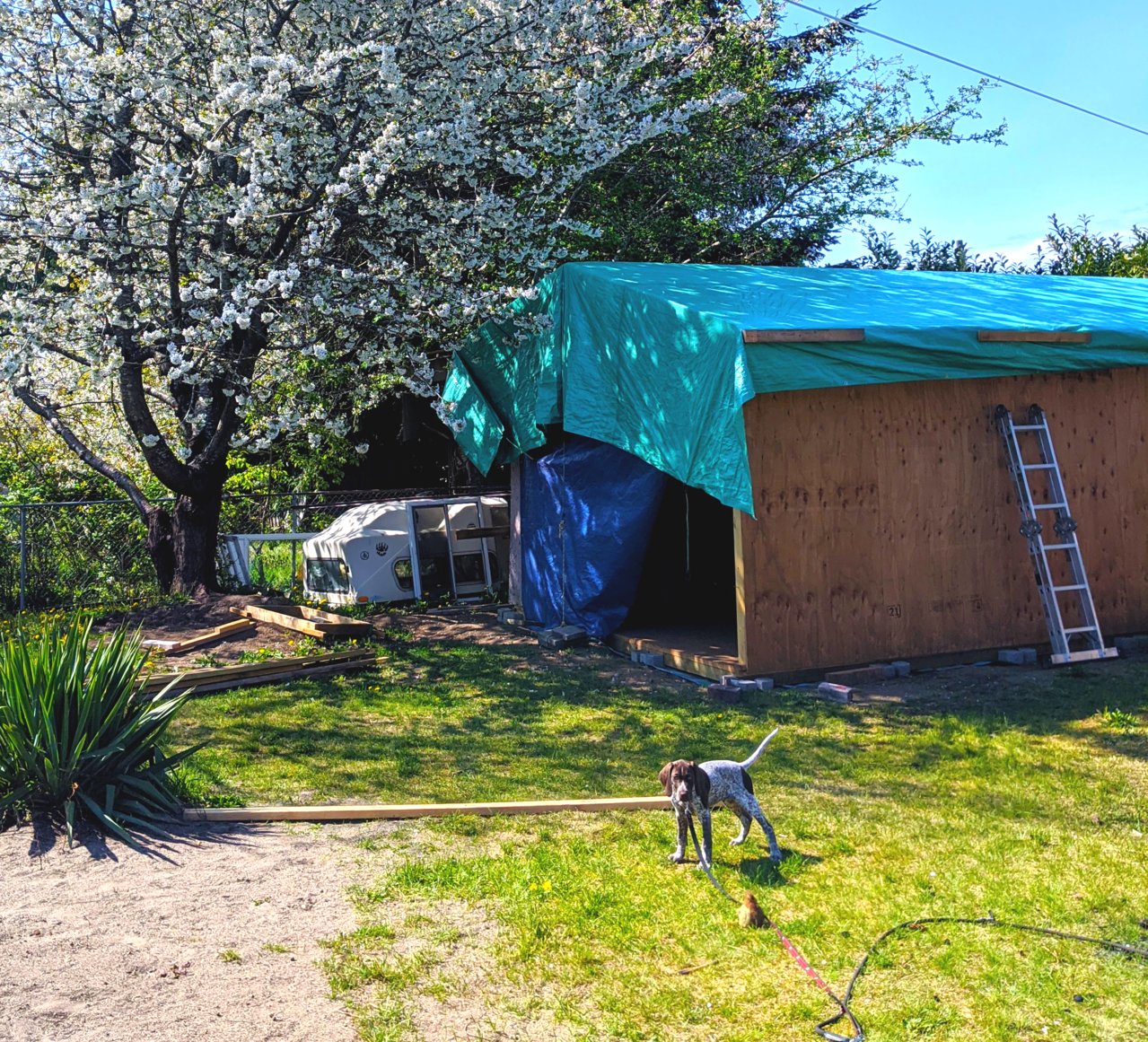

    pulled a tarp over it yesterday so I wouldn't be right in the sun all afternoon while I'm prepping these timbers

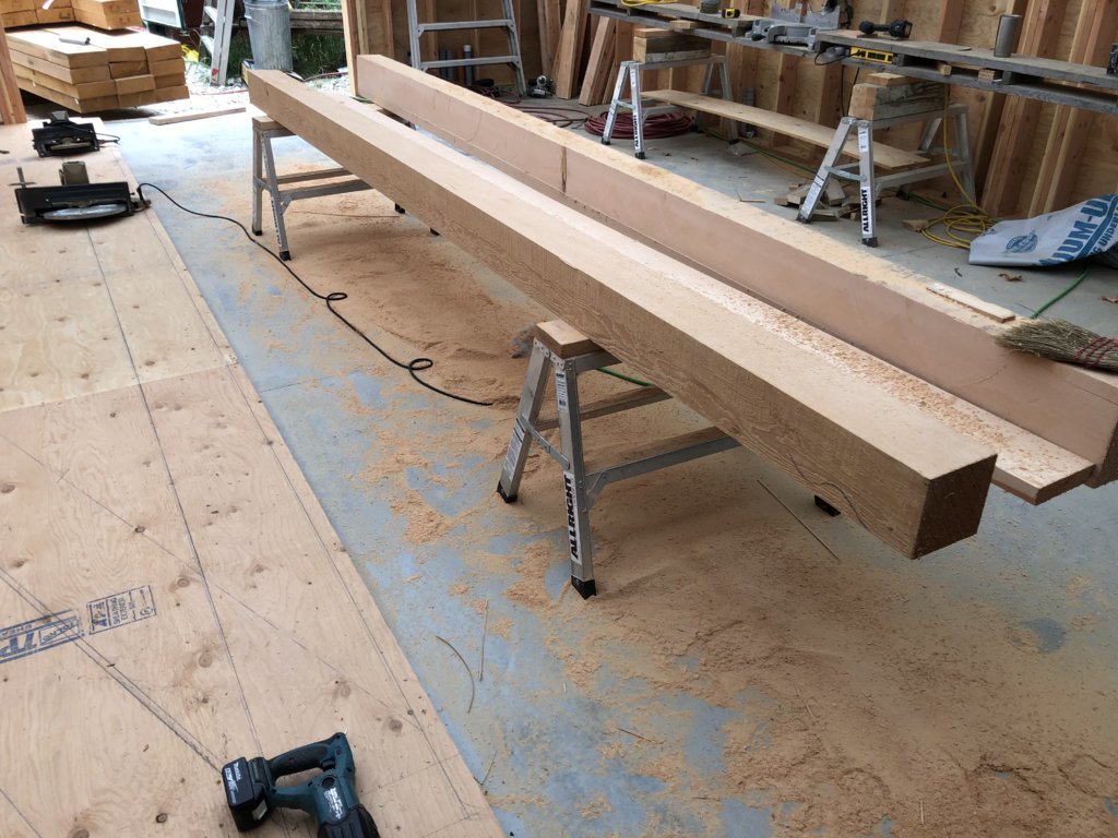

    The fruits of today's labour
    The 3 / 14' 6x6 give me all the 7' posts I need for the outside shed roof area and the 20' 6x6 will split into the 3 king posts I need for the timber trusses
    all pieces cut and belt sanded
    I'll start on the timber rafter elements of the trusses on Monday
