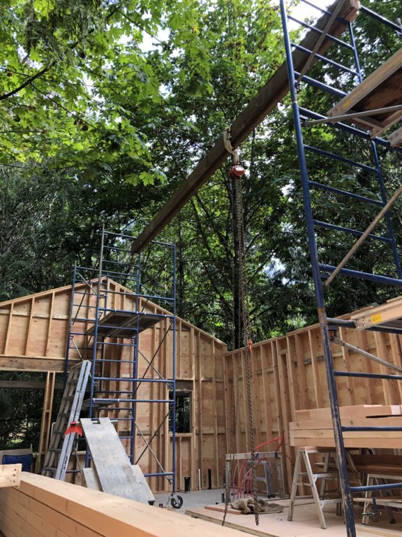

    Managed to achieve the goal for today of getting all 6 bottom chord timbers up on the wall plates
    tomorrow I'll cut out the plates running through the beam pockets , and start installing the timbers

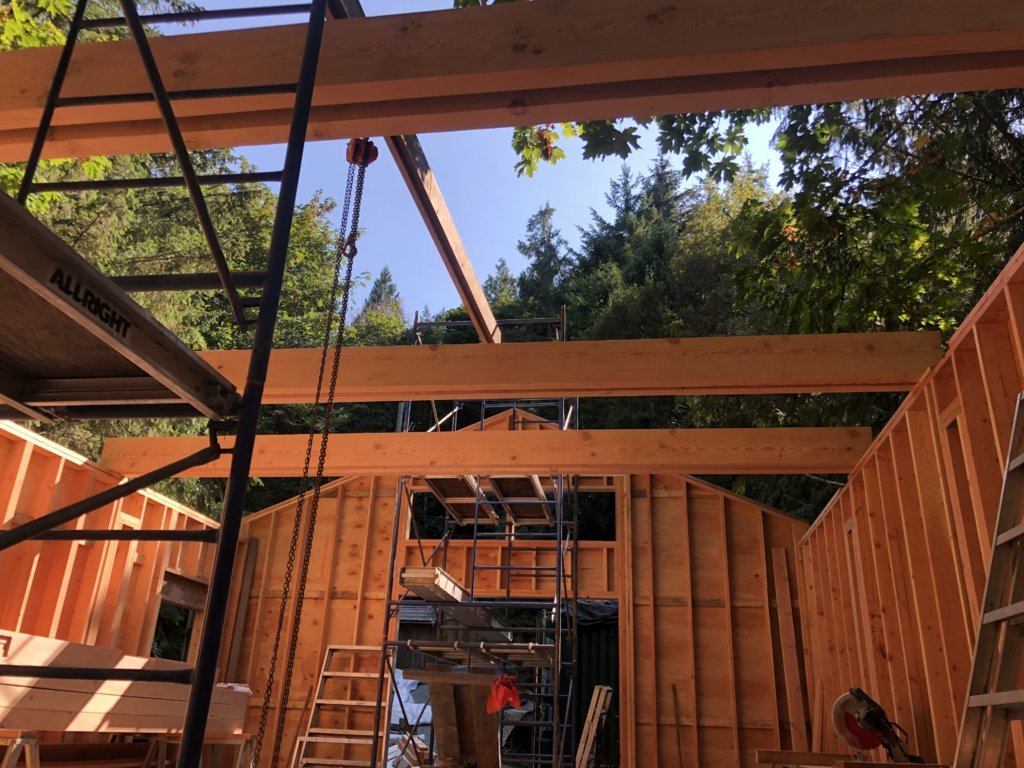

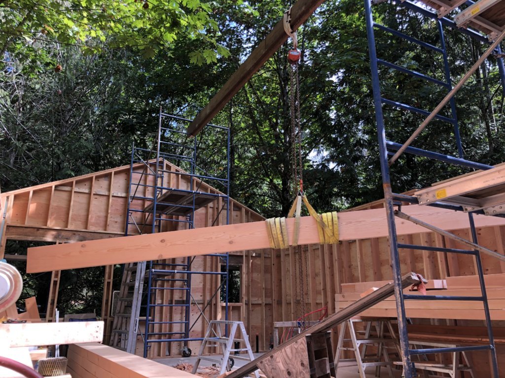

    So today I ran a string line on the exterior wall on the side that has the covered storage overhang and braced that wall straight down to my concrete columns , then I cut out the top plate I had run through the beam pockets and prepped the beam pockets for the timbers .
    All my timbers are 1" short of the exterior width of the building on each side (ie 22' wide building plate to plate , timbers are 21' 10") , this allows me to install a piece of 1" XPS styrofoam between the plywood and timbers while still allowing for 4 1/2" of bearing .
    This is to reduce the thermal bridging in this area and give me a way to have a continuous air barrier behind the timber interruption of the future interior air and vapour barrier .
    Not to get too Matt Risinger , but wood is R-1 / inch , so if the timbers filled the whole 5 1/2" deep beam pocket cavity (2x6) , the R value would be R 5.5 . XPS styrofoam is R-5 / inch so I almost double the effective R value there to R 9.5 (4 1/2" wood + 1" XPS) .
    The XPS is an air barrier so by taping in the seams of the cavity and the XPS , the insulator will be able to caulk the interior air / vapour barrier to the exposed tape edges and I will effectively have the air barrier continuous around the timber ends .
    1 bottom chord timber of each pair is installed and screwed into the framing which is now setting the width of the building to the 22' mark
    Tomorrow I'll install the timber posts and lift the timber rafters up onto the top side of the crossing beams as I need to disassemble my lifting towers in order to install the 3 ply 2x12 structural ridge beam
