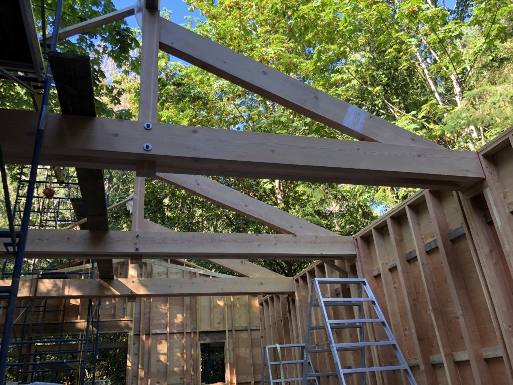

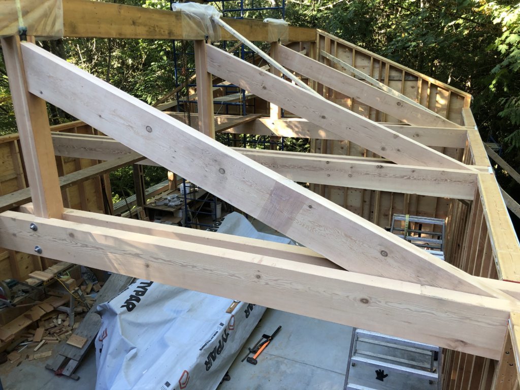

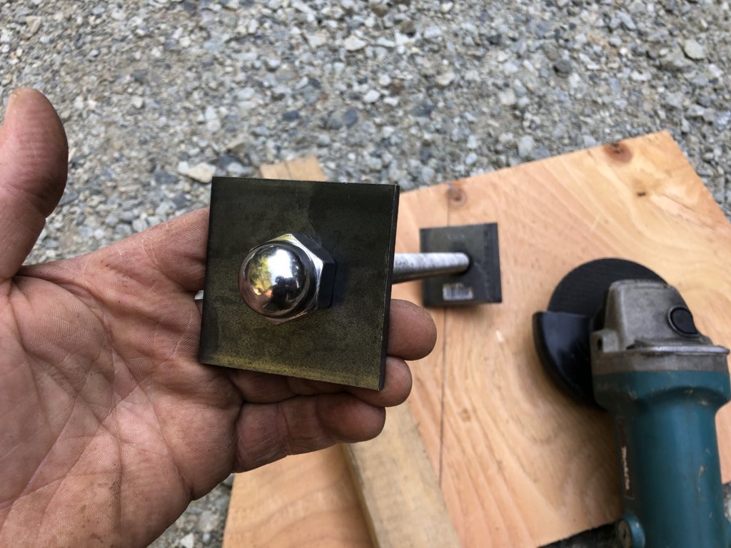

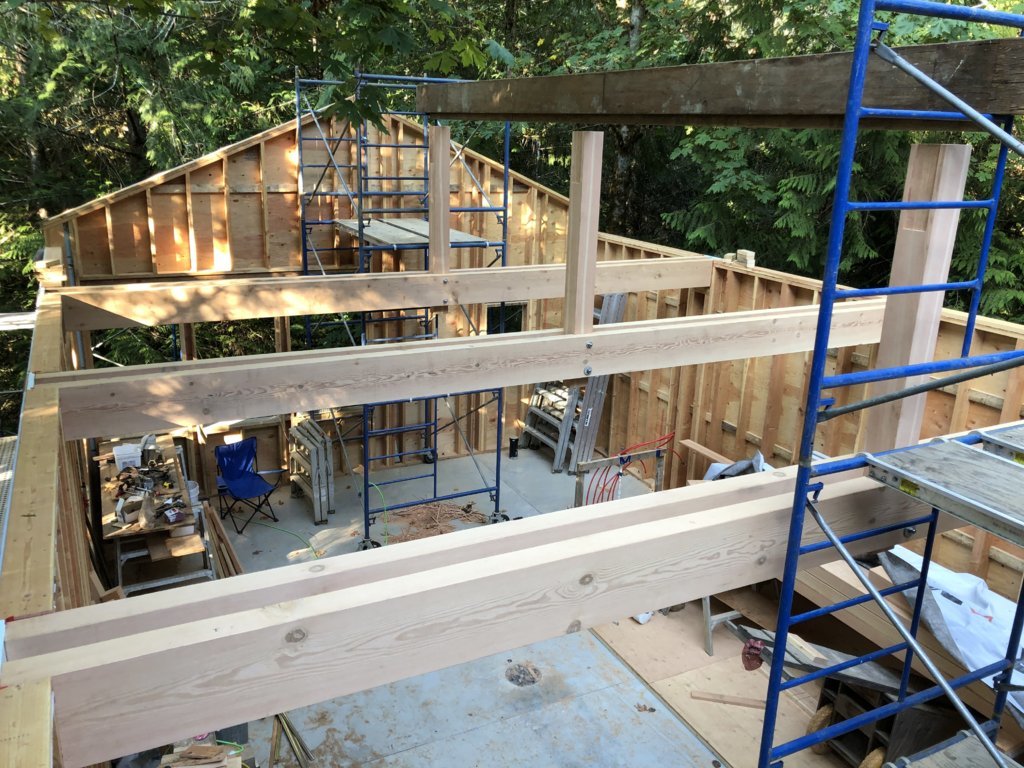

    Installed the king posts and 2nd bottom chord beams of each pair today
    To install the posts I first clamped the post plumb in its location and ran some #12 x 6 3/8" GRK R4 screws through the post 'tenon' and into the 4x12 bottom chord beams that I fixed in place yesterday . I then used the 5/8" holes I pre-drilled in the posts to guide the drill bit through the fixed bottom chord beam.
    After I drilled the holes through the single 4x12 bottom chord beam , I then dropped the 2nd bottom chord beam into place , clamped everything together and ran the bit back through the hole I had previously drilled through the post and bottom chord beam #1 to complete the through holes for the bolted connectors

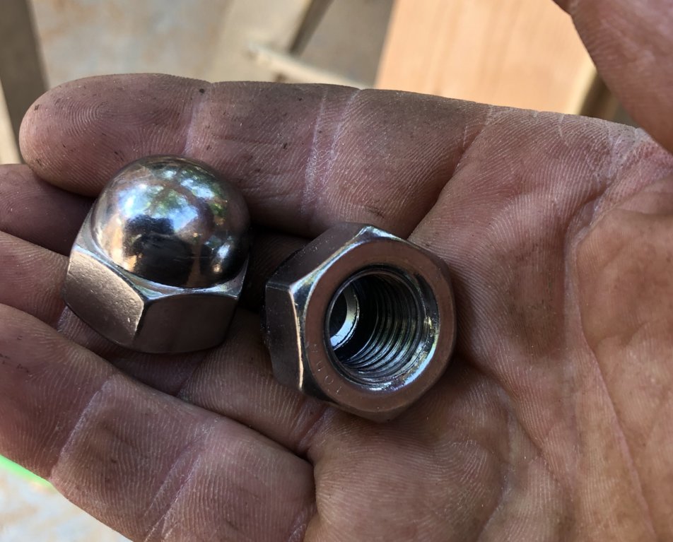

    I'm cutting my own 5/8" redi rod to make the 'bolts' and using 5/8" acorn nuts and 1/4" x 2 1/2" square washers . I'm going for an 'old timber factory / sawmill' look
    5/8" acorn nuts ~
    This is the finished connector look , all the hardware is going to get painted .
    All bottom chord beams and king posts installed and connection bolted together . Round washers are place holders until I get a chance to prime and paint the raw metal washers
    Tomorrow I'll disassemble the scaffold towers and start on the 3 ply 2x12 ridge beam .

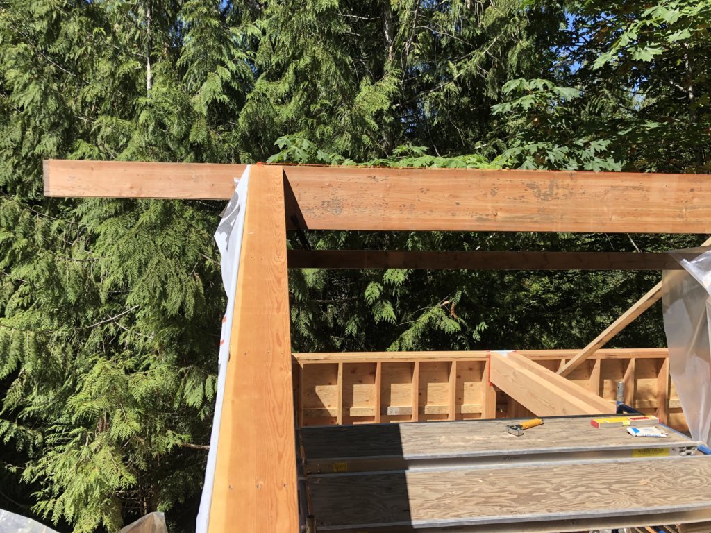

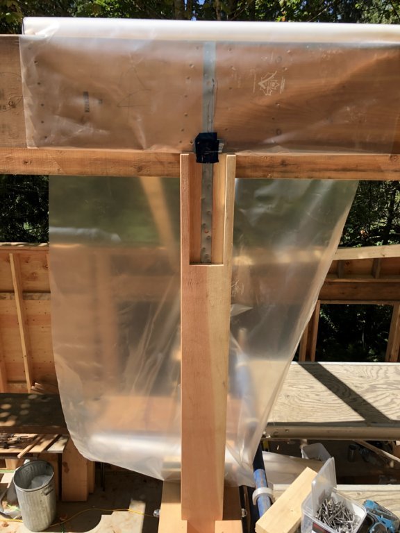

    Got my ridge beam installed today , its a 3 ply 2x12 .
    I installed 6mil poly vapour / air barrier on top of the king posts before building up the ridge beam . The poly will drape over the timber rafters for now but when we insulate it will get stapled up to the underside of the 2x12 structural rafters and taped to the rest of the vapour / air barrier so it is continuous across the top of all the timber 'trusses'
    The ridge beam is cut down and extends beyond the rake walls to carry the 3' gable overhang 2x6 rafters
    Simpson straps installed with 3" 10D ring shank nails to make the post to beam connection . Poly is taped where strap runs through it
    Going to put in a weekend shift and try to get the timber rafters installed

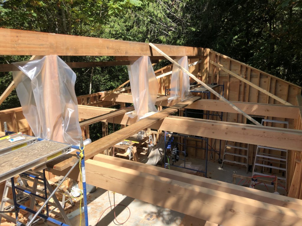

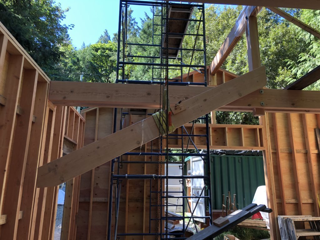

    Started lifting in the timber rafters today , had to switch up my original plan and re-set up the scaffold lifting towers
    Got one side in today
    After getting those 3 in place I moved the lifting towers to the other side this afternoon so should be able to get the other side in tomorrow

    got any pics of the rest of the crew
  13. Aug 15, 2020 at 5:57 PM
    #353
    OZ-T
    OZ-T [OP] I hate my neighbour
    Dec 15, 2009
    #27584
    50,586
    Peter North
    British Columbia
    Mr Chain hoist and Mr Scaffolding in pic #1
