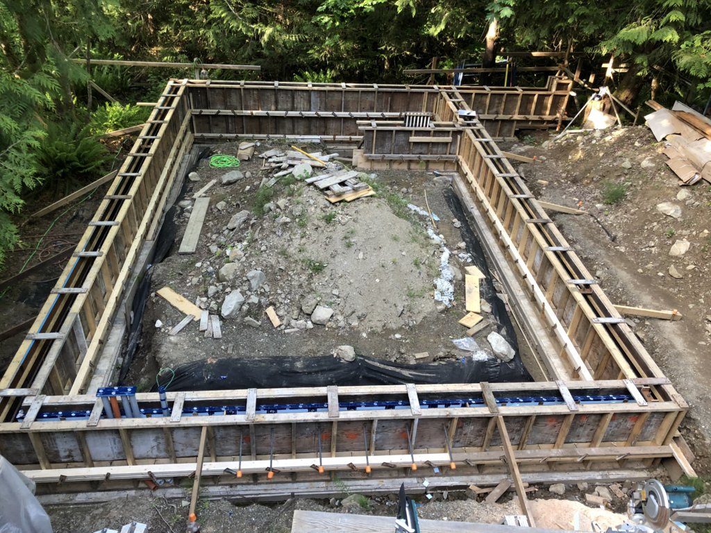

    Update :
    passed structural engineer's and building department inspections , pour scheduled for next Wed

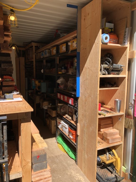

    Forgot to add pic of the hardware store I have set up in my container at the site
    welcome to OZco lol

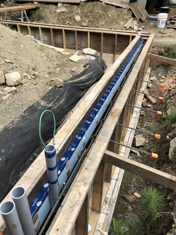

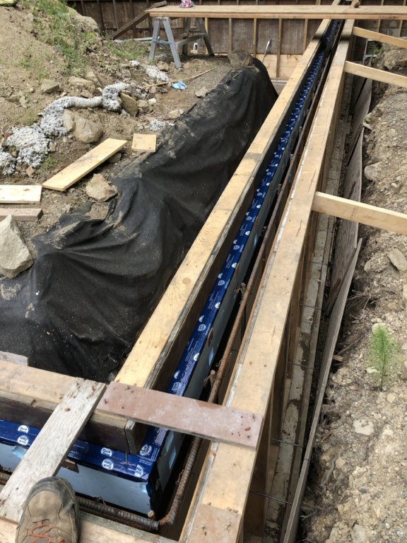

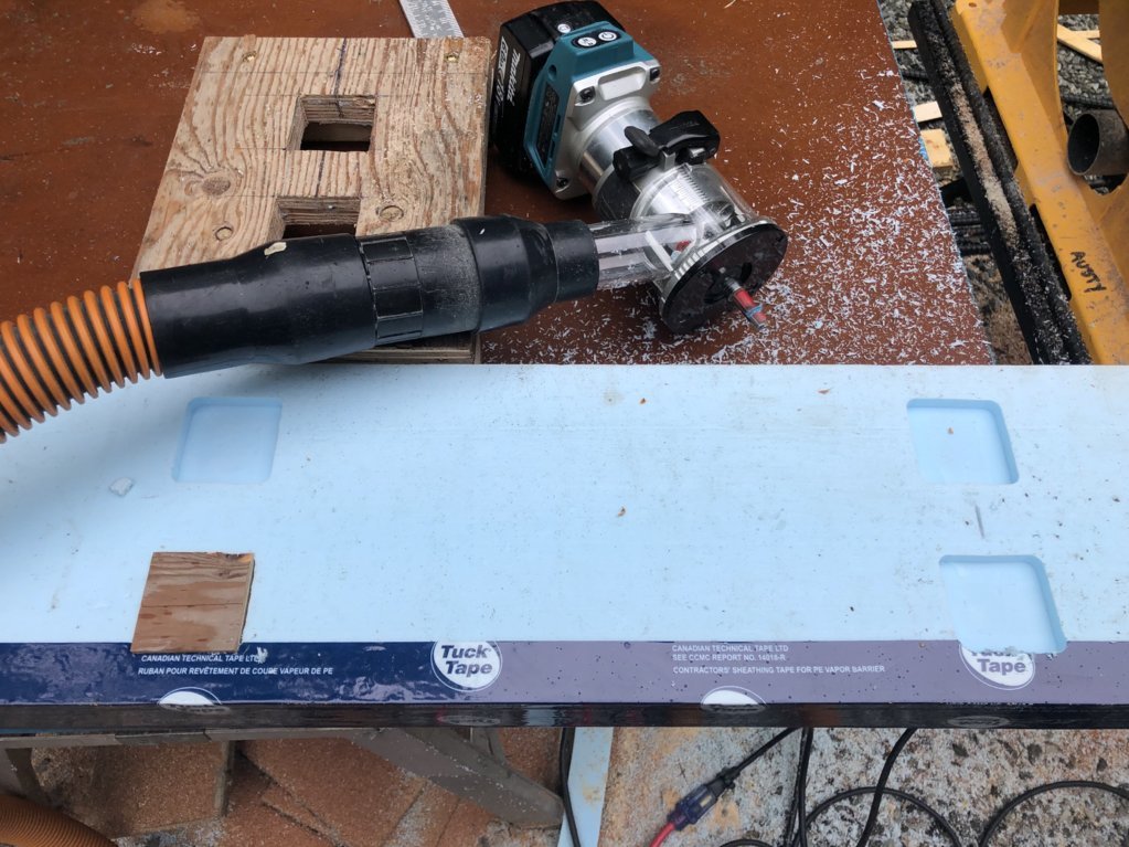

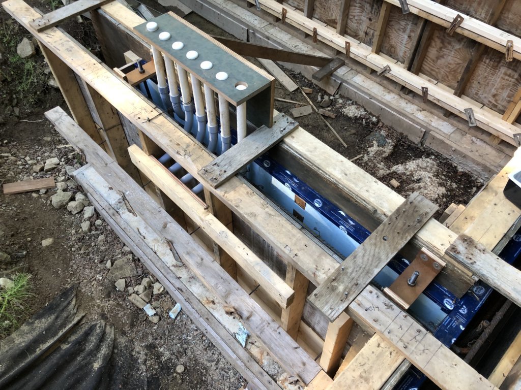

    Couple pics from last couple days just finishing up formwork ~
    I added a 2" conduit that will run inside under the slab to the tablesaw / outfeed table "island" .
    This conduit will transition to EMT and sweep into the side of the panel so there will always be an upgrade path for any future electrical changes
    Next up I needed to install the 2" styrofoam cast in slab edge insulation that will be poured into the foundation wall . Top of styrofoam represents top of slab / underside of wall framing so it also acts as pour height for wall and later will become screed for slab pour .
    I hold the styro in place with plywood blocks that are drawn into rebates in the foam with screws driven through the form ply , through the styro and into the plywood sucking the styrofoam tight to the formwork .
    I made a little jig to cut the 2"x2"x1/2" rebates in the foam and used my cordless router with a 1/2" top bearing bit , went pretty fast , I think it only took me about an hour to prep all the pieces for the entire building perimeter
    Cast-in slab edge styro in place . I tape the top of the styro so little styrofoam marbles don't get all embedded in the foundation wall concrete but more importantly later when we use it as the slab screed that the power trowel doesn't pull styrofoam crumbs into the slab
    Everything is buttoned up , tomorrow I need to hang my hold down bolts and secure some more pipework sweeps but other than that I'm ready for Wed pour

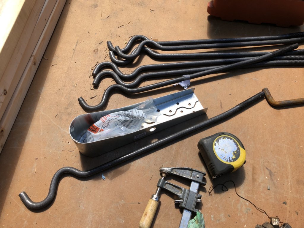

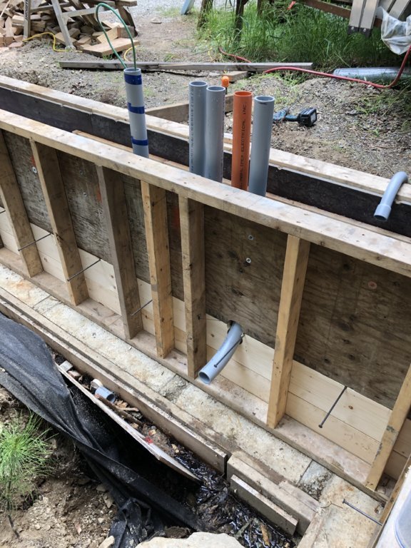

    Finished up the last details today
    Hung my hold down anchor bolts , there are 9 hold down locations in the building , we're using Simpson 5/8" SSTB 24" bolts and HDU5 hold downs
    Hold down bolts suspended at embed height
    This wall has a water line and sweeps that will allow the hydronic piping to terminate in a manifold in the wall
    All ready to pour
    Pour is scheduled for 8:30 tomorrow
