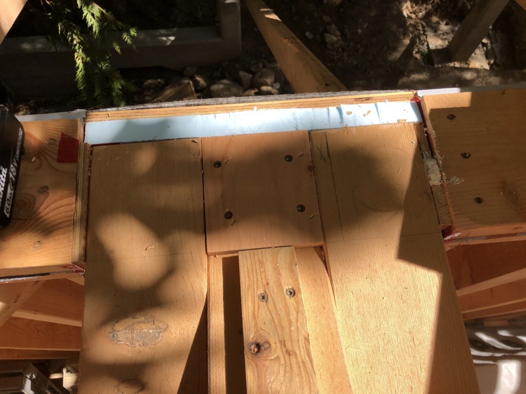

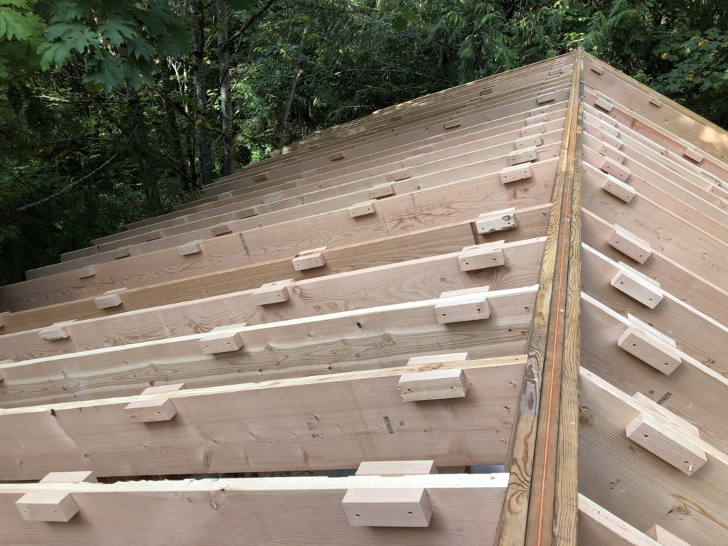

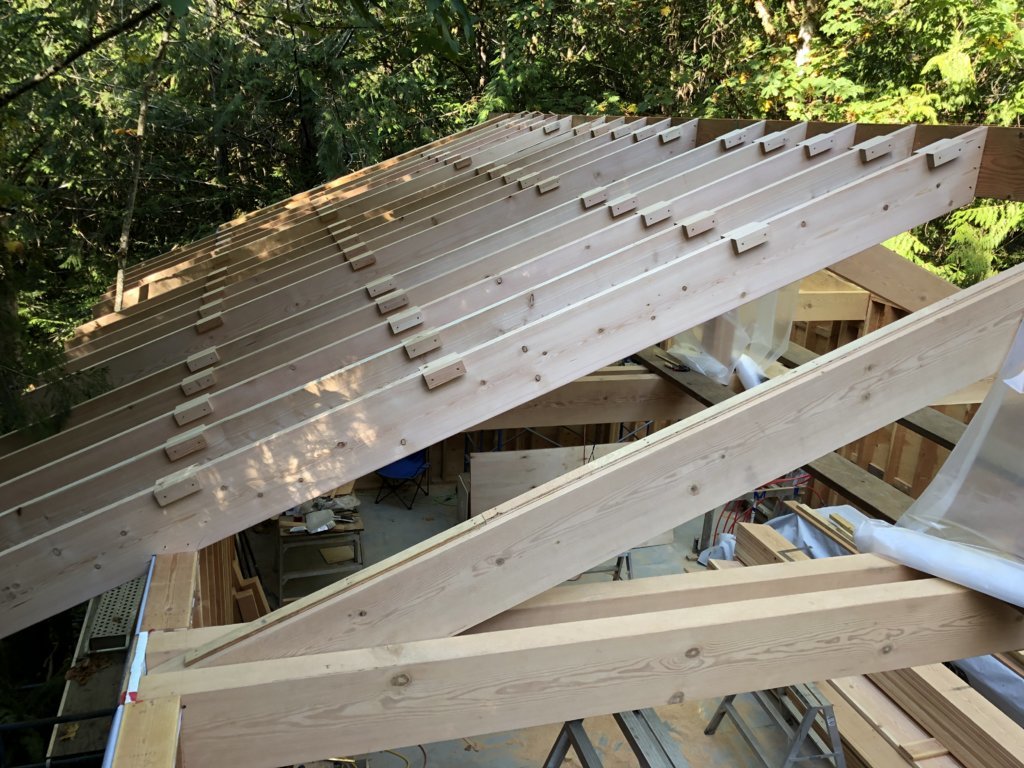

    Got asked about the rafter blocks in TW Live :

    Nice. Now we’ve seen before and rafter.

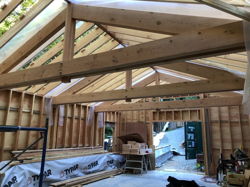

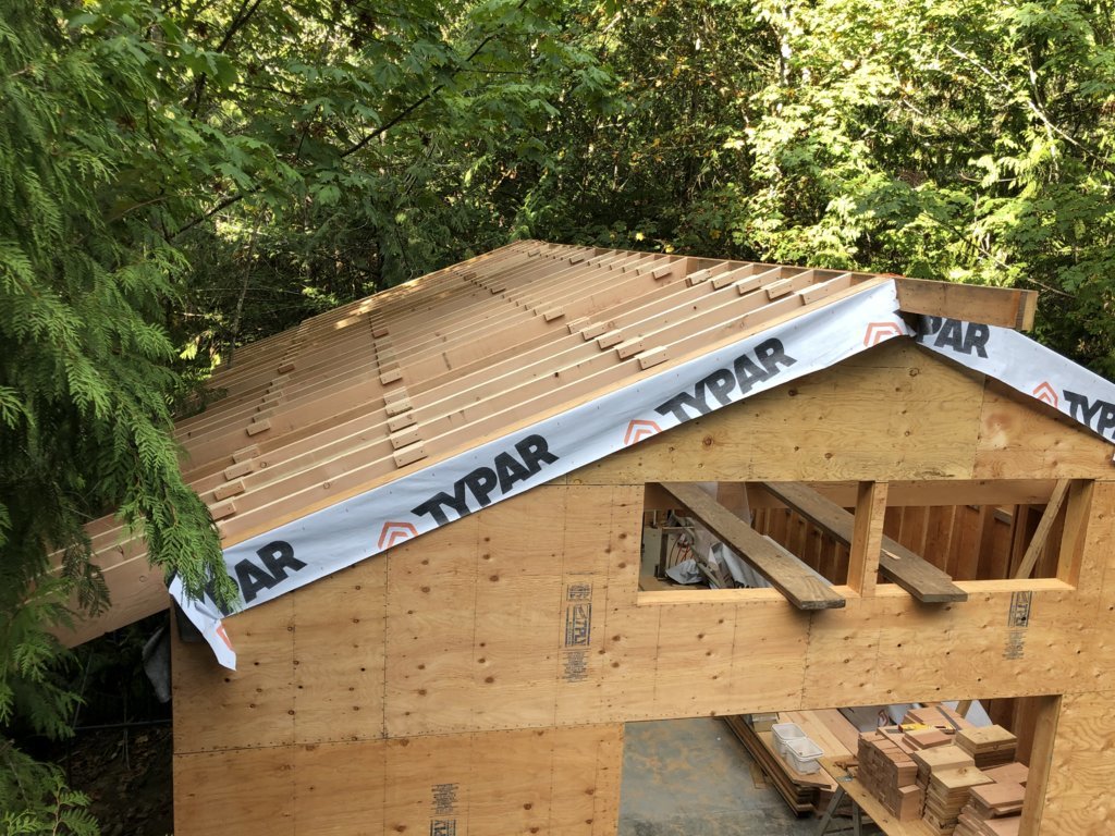

    Got most of the rafters in , should finish tomorrow no problem . I need to dick around with the vapour / air barrier and some blocking over the timber rafters so I'm leaving out any 2x12 rafter that lands in the timber rafters zones until last so I can move around up there without being worried about walking on plastic

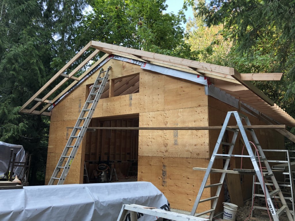

    I made a deal with my wife that I would only cut branches off the trees back there that were actually in the way , couple more to come off now that I'm up at roof height

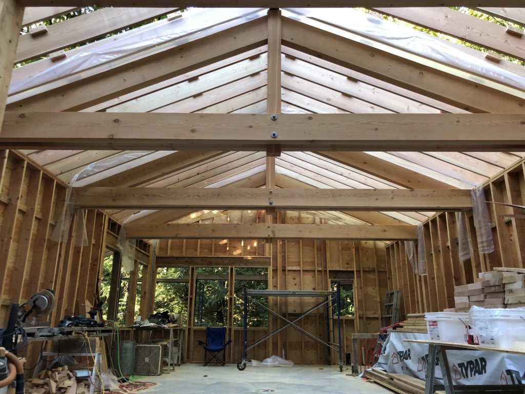

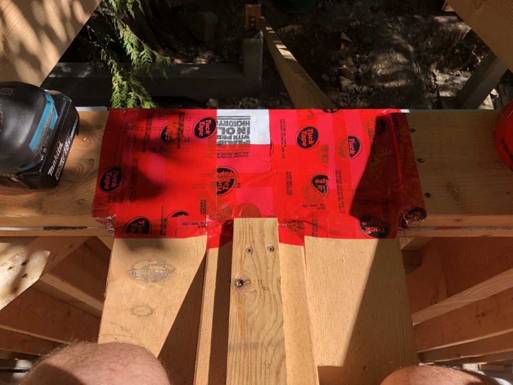

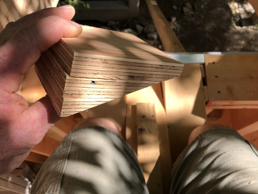

    Finished up the last of the 2x12 rafters today .
    Where the timber trusses terminate in the exterior walls , I needed to pack out the void left above the timber rafters .
    For this I used some 3/4" plywood cut at a 22.5 degree angle (5 in 12 roof pitch)
    Stapled and screwed blocks in place
    After that I folded the housewrap flap back up I had cut out to create the beam pockets and taped that all together and to the timber , completing the air barrier 'bag' around the timber ends .
    I forgot to take a picture but the plastic air and vapour barrier then comes down over the top of the timber rafter and is taped to the housewrap on top edge of timber build up then notches around crossing timbers to be caulked and taped to the rest of the vapour barrier that will be installed at insulation time
    Rafters all up

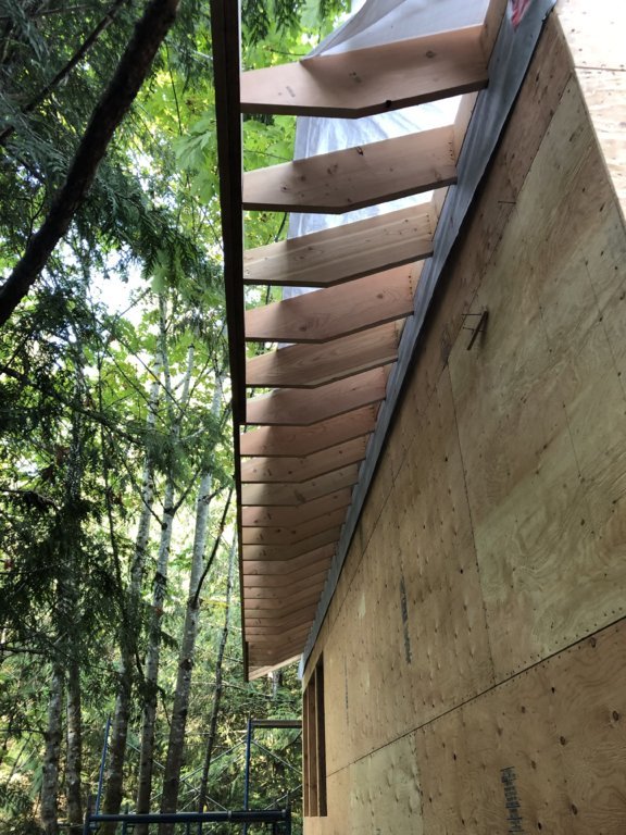

    Got all my frieze and pressure blocks installed between the rafters and also spent some time with a straight edge and cordless power planer making sure the bottoms of the rafters planed out to each other and more importantly that they were planed out so future ceiling drywall would tuck over timber rafters .
    I then string lined my overhangs and cut rafter tails and installed sub fascias
    Double sub fascia at either end works to help carry gable overhang rafters
    I also framed my gable end overhangs
    Tomorrow the tarp comes off hopefully for the last time and I start strapping and sheeting the main roof area

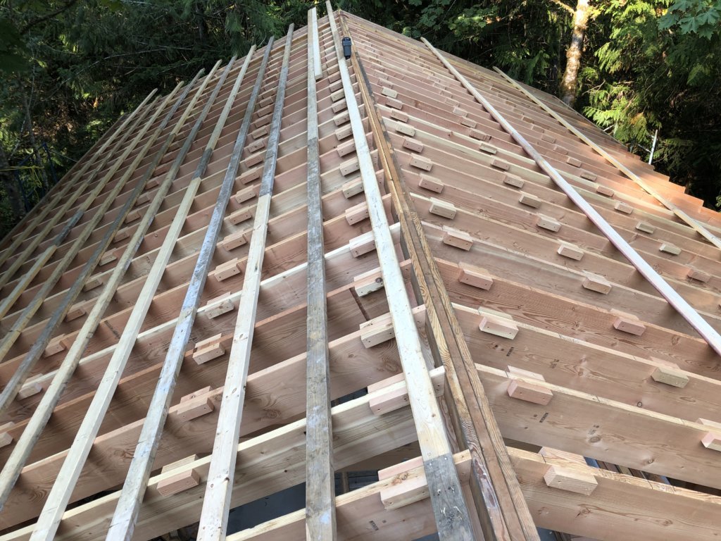

    Got 2x4 strapping installed on one side today and 2 rows on other side that are laid out on 16" centres ensuring the rafters are straight prior to installing the rest of the strapping .
    Feels good to be using up all this 2x4 I've been accumulating for the last few years , almost all of it has already participated in a few foundation pours
    Will get other side done tomorrow , then I can move on to plywood on Monday

    Wow, so this is a little different than the way we do it. I have a couple of questions. Are the 2x4s just to ensure proper spacing of the rafters or is this something for structural integrity(snow load)? Is this a code that must be followed in your province? The only time we do this is if we are using corrugated metal otherwise we nail plywood straight to the rafters. What kind of nail gun are you using? It is ring shank nails? Sorry for all the questions, I’m just really impressed and love the way things are coming along.
    wilcam47 likes this.
  20. Sep 4, 2020 at 7:42 PM
    #400
    OZ-T
    OZ-T [OP] I hate my neighbour
    Dec 15, 2009
    #27584
    50,587
    Peter North
    British Columbia
    the 2x4 strapping is there to provide cross ventilation for the rafter bays
    I use Senco Framepro 600's and 601's
    Framing nails are galvanized ring shank
