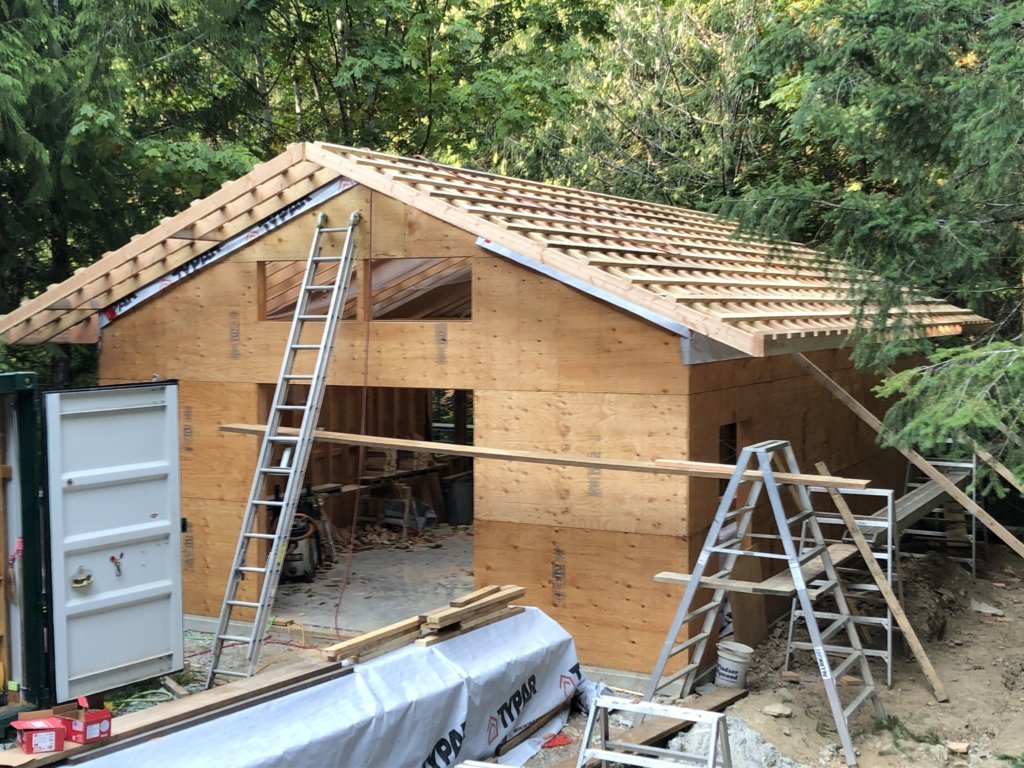

    So are you going with asphalt / fiberglass shingles, or metal roof, or what’s the plan?
    wilcam47 likes this.
  3. Sep 4, 2020 at 7:53 PM
    #403
    OZ-T
    OZ-T [OP] I hate my neighbour
    Dec 15, 2009
    #27584
    50,587
    Peter North
    British Columbia
    There is a code minimum for airspace above the insulation in the BC building code , some times adding strapping is the only way to achieve the minimum height depending on rafter size and insulation depth but also is best practice to allow for cross ventilation of the bays
  4. Sep 4, 2020 at 7:53 PM
    #404
    OZ-T
    Dec 15, 2009
    #27584
    50,587
    Peter North
    British Columbia
    metal , hidden fasteners
    its like standing seam
    robssol, SH7mi, wilcam47 and 3 others like this.
  5. Sep 4, 2020 at 7:56 PM
    #405
    OZ-T
    Dec 15, 2009
    #27584
    50,587
    Peter North
    British Columbia
    Slashaar, 1buzzbait, uurx and 5 others like this.

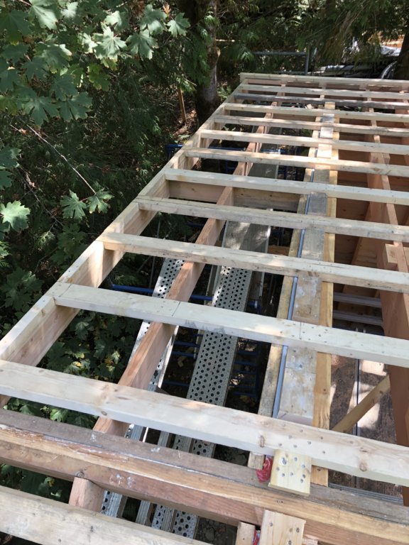

  12. Sep 5, 2020 at 5:24 PM
    #412
    OZ-T
    Dec 15, 2009
    #27584
    50,587
    Peter North
    British Columbia
    All strapping on and cut flush at gables , Monday I just need to add fill blocking between strapping at gable roof edges and above rake walls so shear walls are connected to roof diaphragm then I can start plywood

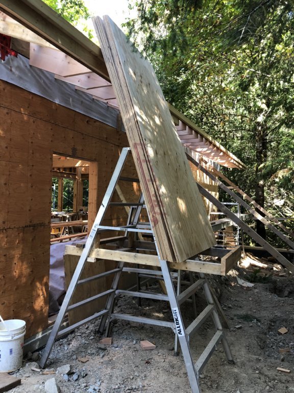

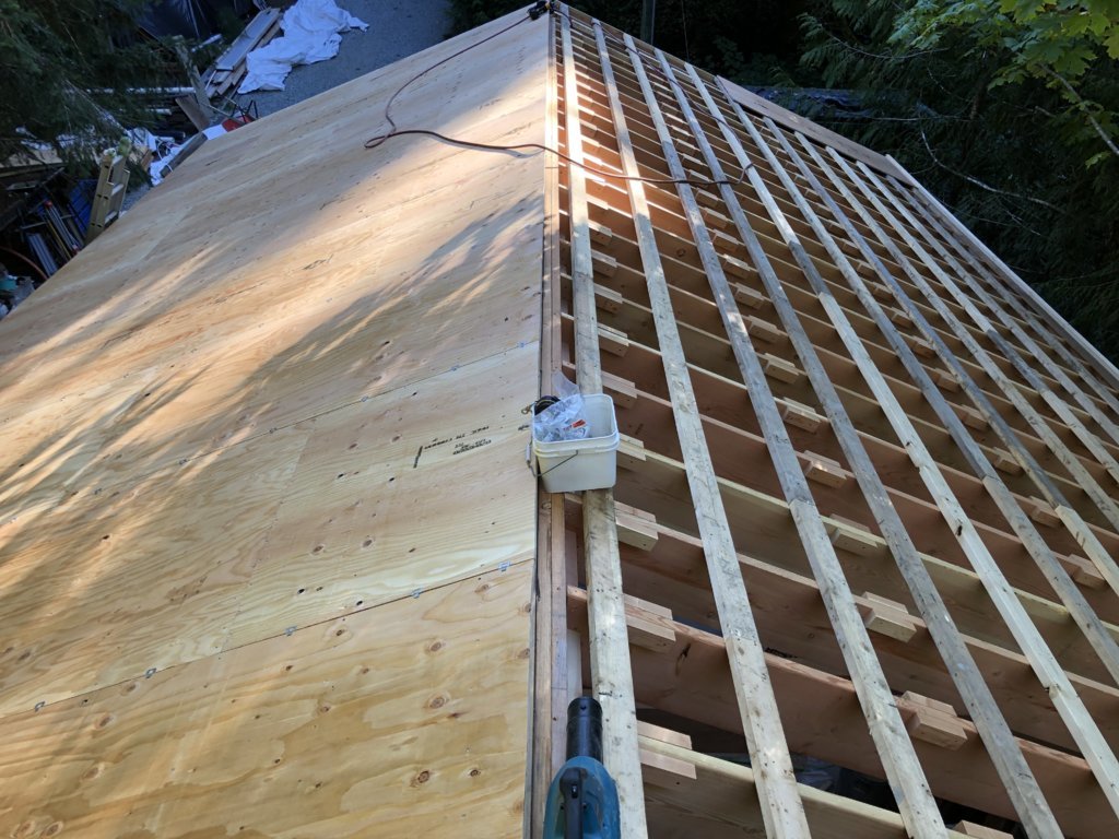

  16. Sep 7, 2020 at 5:22 PM
    #416
    OZ-T
    Dec 15, 2009
    #27584
    50,587
    Peter North
    British Columbia
    This morning I finished up the blocking that goes between the strapping at the roof edges and above the rake walls to connect the shear walls to the roof sheeting diaphragm .
    Got one side sheeted and nailed off , install the sheeting on the other side tomorrow .
    H clips by yourself are a pain in the ass
