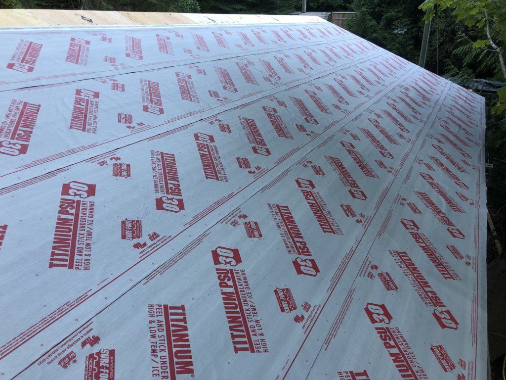

    I'm going to use a layer of exterior insulation for one , minor air sealing details are the other things

    In general, is making a building too tight a bad thing? I always though it was good to have some natural infiltration.

    Tight building envelope is good with proper mechanical ventilation .
    HRV systems are required in new home construction here

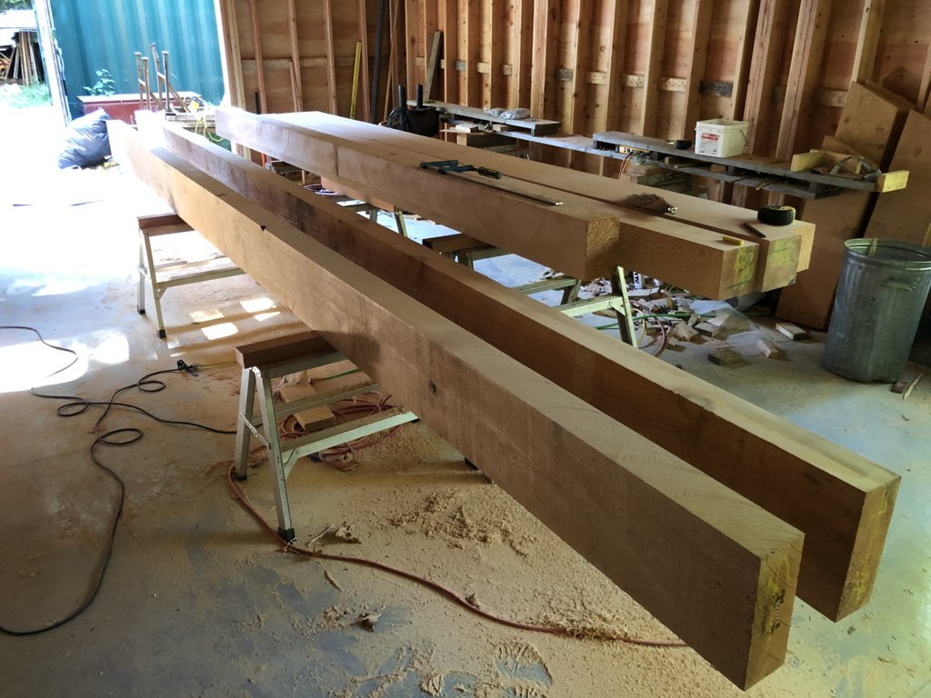

    This morning I went and picked up all my full dimension 2"x10" cedar fascia and barge boards . Have them sticker stacked with a fan on them inside the building to remove some moisture before they go up and then I moved on to starting to cut and prep the posts and beams for the extended roof overhang

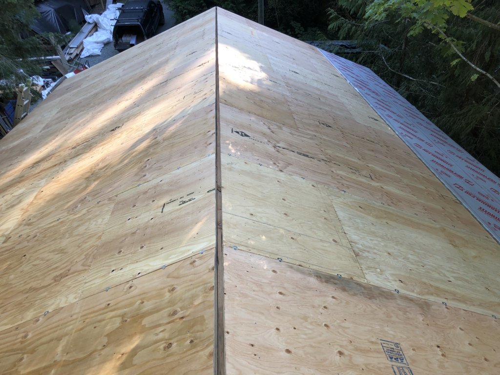

    Just curious about your roof sheeting. In the US on our roofs, we usually run OSB (long side) perpendicular to the roof's trusses or rafters and place the H-clips on the unsupported edges. Some areas don't even require H-Clips.
    It appears that your plywood is run with the long side parallel to your rafters. Just curious what the thinking is behind this application. Is this something the plywood manufacturer prefers because it increases the shear value. Or is this just a customary application in Canada?

    You must have missed the pics of the 2x4 strapping over the rafters. :boink:.

    Just found it. :facepalm: What can I say

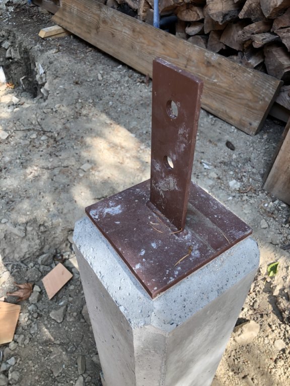

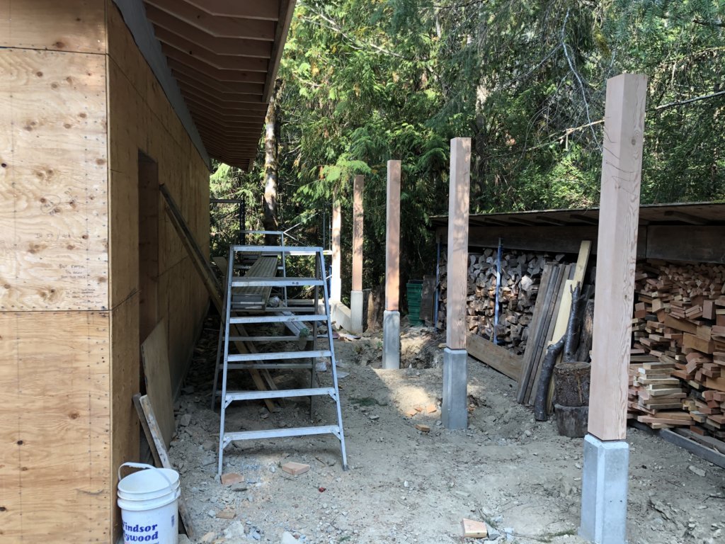

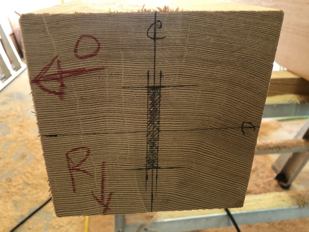

    Today I cut the 14' 6x6 I milled from the left over beams shown earlier in the thread into my 7' post blanks for the extended roof overhang .
    The posts all sit on these custom 1/4" steel knife plates cast into the concrete columns
    To cut the pocket for the knife plates its a matter of laying out the bottom of the posts from centre each way with the knife plate in the correct orientation of how you want the post to install . In this case 'R' is the road face and 'O' is out , away from building

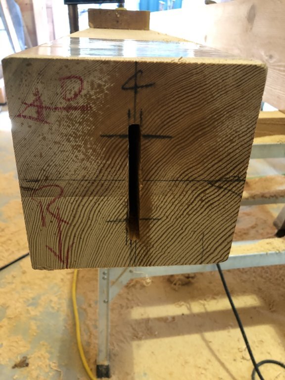

    Plunge cut with my Makita 16" electric chainsaw to depth of approx 11". I run heavy mineral oil in this saw instead of regular bar oil because it does not discolour the wood
    Posts all standing to test and adjust fit as necessary . Once I'm happy with them I will shoot top elevations of posts with builder's level , cut to length and notch for beam
