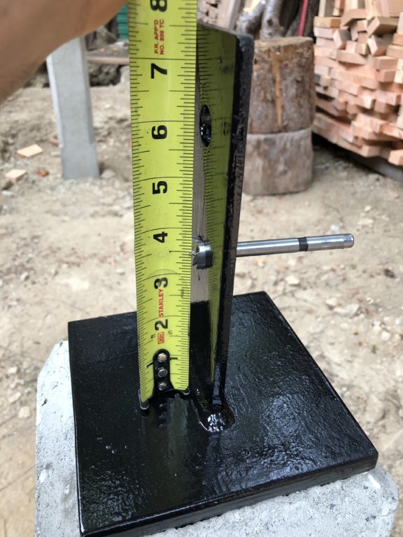

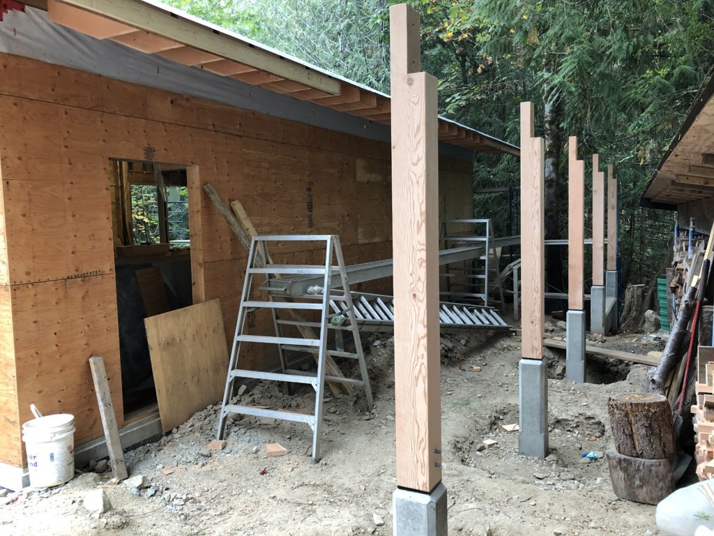

    Got all my posts cut to height , notched for 4x12 beam , and predrilled for through bolts into beam as well as through bolts that go through the knife plate at the bottom
    Have some 5/8" x 7" hex bolts through the knife plate connections to make sure everything is aligned until I get a chance to cut some more of the stainless redi rod bolts
    The margins are pretty tight as far as aligning the knife plate bolt holes in the post and knife plate .
    The bolts will be 5/8" and the holes in knife plates are 11/16" , so I only have 1/32" of play in any direction so measurements need to be pretty accurate .
    This is a good trick for getting an accurate measurement for the height of the centre of the 11/16" hole above the base of the knife plate . Instead of trying to eyeball centre I stick an 11/16" forstner bit in the hole shank first as they are usually chamfered on the backside of the cutter head . You can then measure to the drill bit centre tip and it is perfectly centred

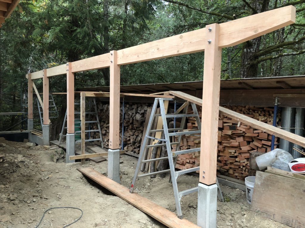

    Got my beams up and installed , cut redi rod and bolted connections . Again round washers are temporary till I get around to painting the square ones I had made
    Took this pic and then draped Typar over timbers , rain started about 5 minutes later haha

    How many man hours have you gotten in your project so far ?

    840 including today

    I believe you mean Cartolomew ? He's still on the payroll , in fact I moved the 20' 4x12's from the shop to the posts with his assistance today

    beautiful craftsmanship on this project. How is this plate attached to the concrete post?
    Were concrete pilings poured in place?
