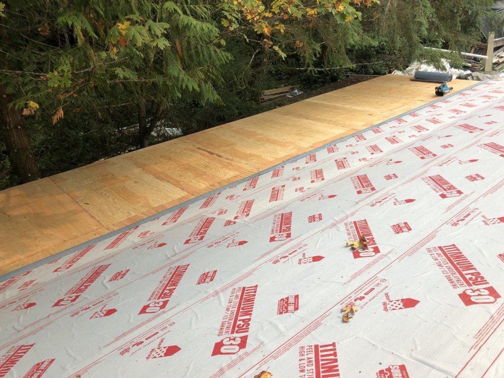

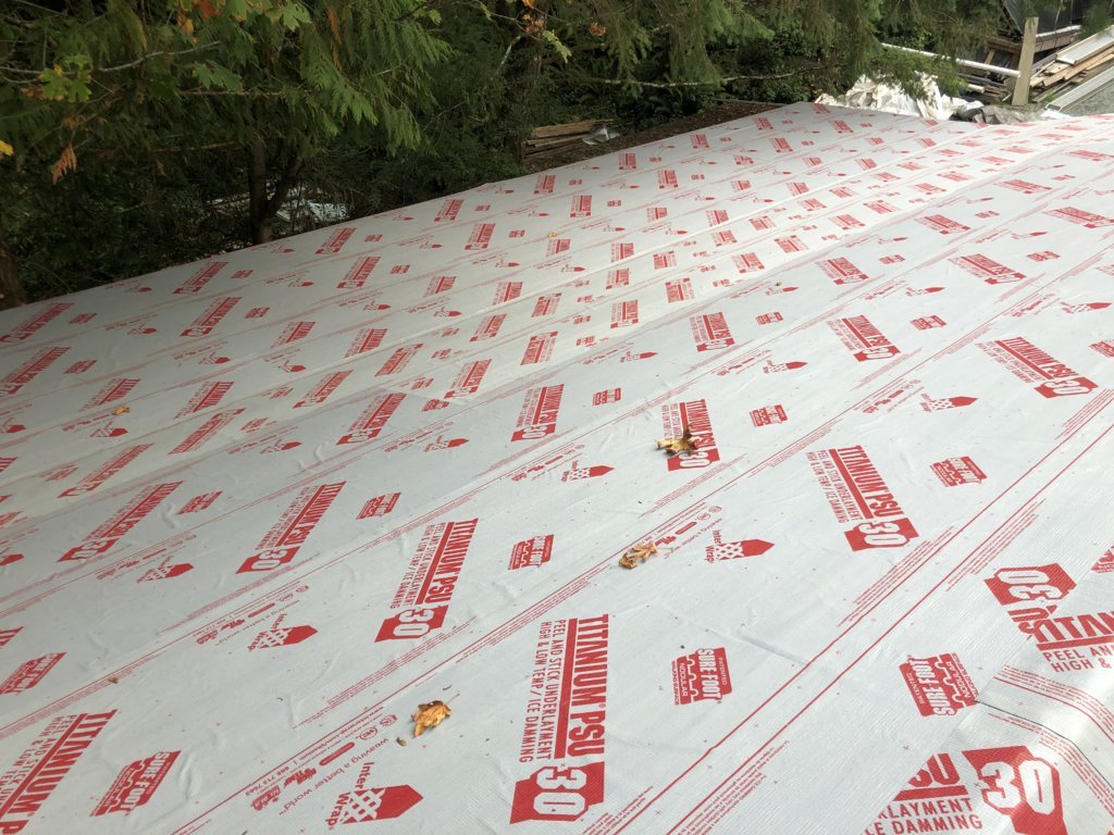

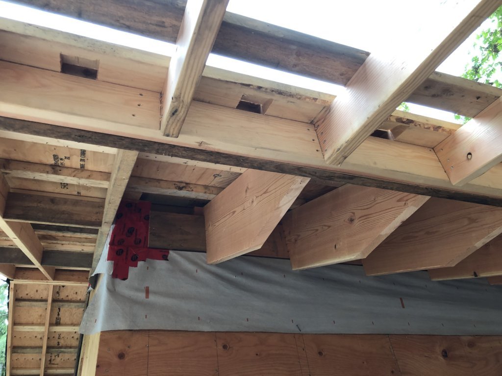

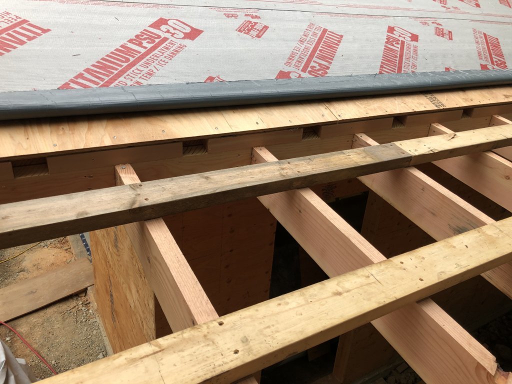

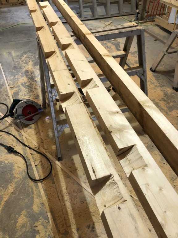

    Strapping went down this morning . On the piece that is at the top of the 2 in 12 pitch , I wanted to butt it up tight to the lowest piece on the 5 in 12 pitch so I could nail them together but wanted to leave an airflow path so the lower roof could vent through the upper roof to the ridge vent .
    Where there is the double sub-fascia , the rafter bays are not continuous so I left 3" vent slots in the lowest piece of strapping on the 5 in 12 roof aligned to the centres of the 2 in 12 rafter bays .
    You can see the 3" slots in this picture at the pitch transition
    To allow for air to get from the lower bays , over the sub-fascia and into the upper rafter bays to vent , I marked the vent slot locations on the upper piece of the 2 in 12 strapping and hogged out vent 'scoops' with the Polish Plane .
    Installed top piece of strapping viewed from below , you can see how the air can travel from the lower rafter bay up through the strapping 'scoop' , into the vent slots and over the sub-fascia into the upper rafter bays
    Plywood all on
    Got peel & stick down before the rain
    All dried in now

    Should work to create a draft venting the roof drawing cooler air from the shaded outdoor portion. I like it.

    Do you put a screen over those scoops or some other way of keeping the creepy crawlies out?

    the whole rafter system will be soffited
