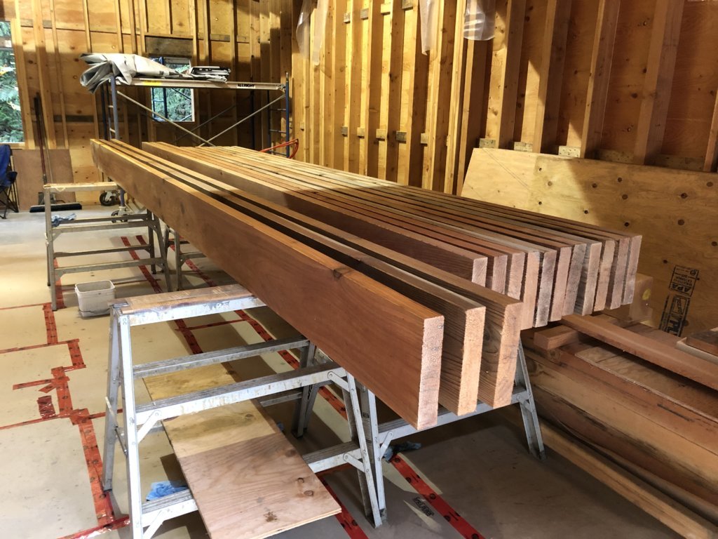

    Got all my fascias and barge boards sanded and edges broken , will coat them tomorrow and start putting them up on Monday
    Going to use Lifetime Wood Treatment on my fascias

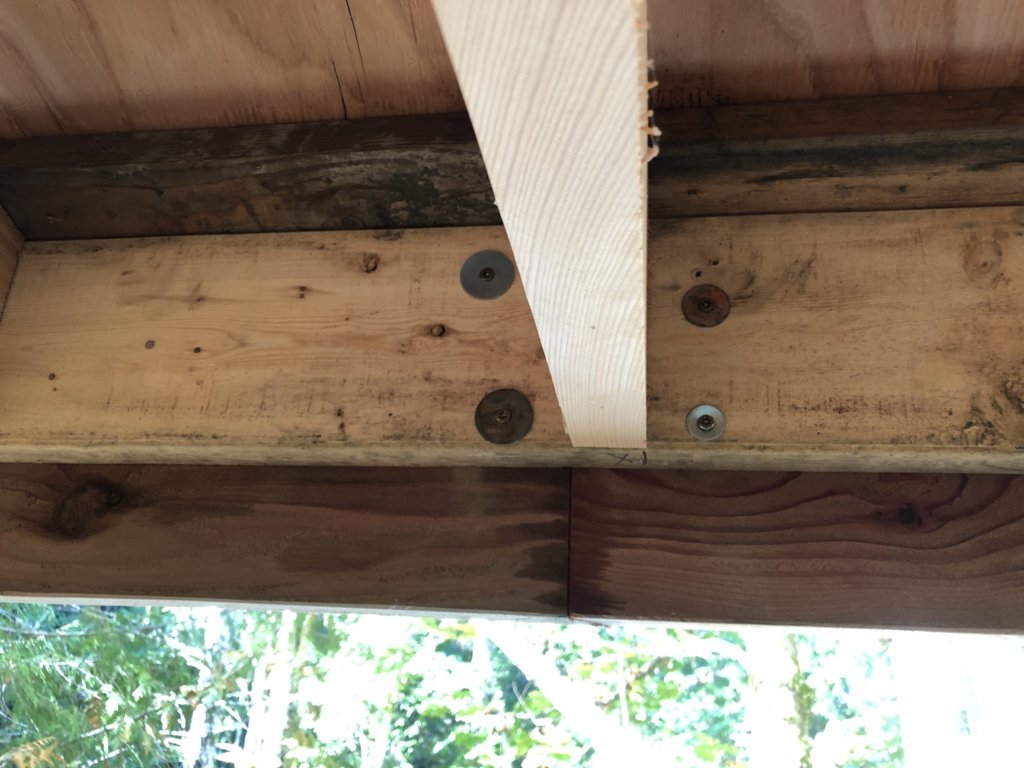

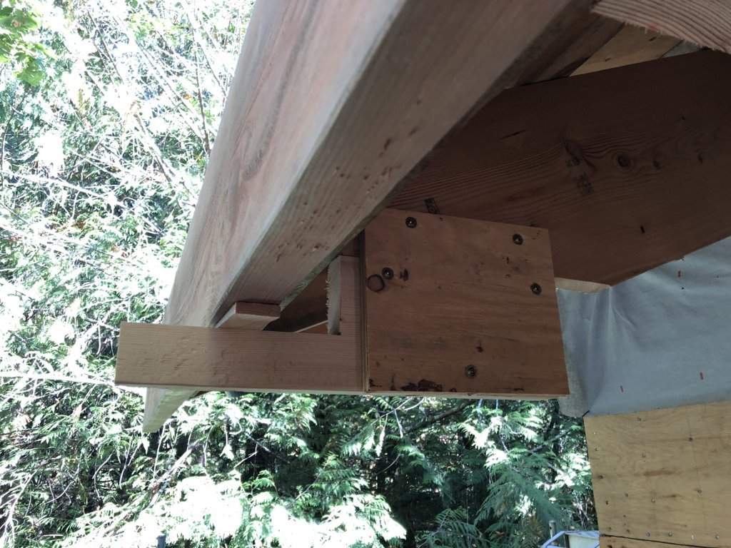

    For the fascias (boards running level) , I make a couple helpers that screw to the side of the rafter tails . The top outside edge of the fascias is in plane with the top of the roof sheathing so I can figure out the drop for the projection that I rest the fascia on and I leave them about 1/4" low and then shim the fascias up to plane , this gives me a bit of wiggle room to get a nice straight fascia line that doesn't necessarily follow the ups and down of the framing
    I fix the fascias through the back of the sub-fascia with screws and fender washers at joints and about every 5 or 6' . This serves 2 purposes , #1 , the fender washers don't let the screws embed into the sub-fascia so they will draw the fascia tight to the sub-fascia and #2 , after I get my pieces on in a long run (3 / 14' pieces make up my 40' runs) , if I need to adjust pieces up or down to straighten the run , I can back out the screws and make adjustments as necessary , up and down , or shim in and out . When I'm happy with the alignment I shoot 3" galvanized ring shank gun spikes through sub-fascia into fascia for final attachment

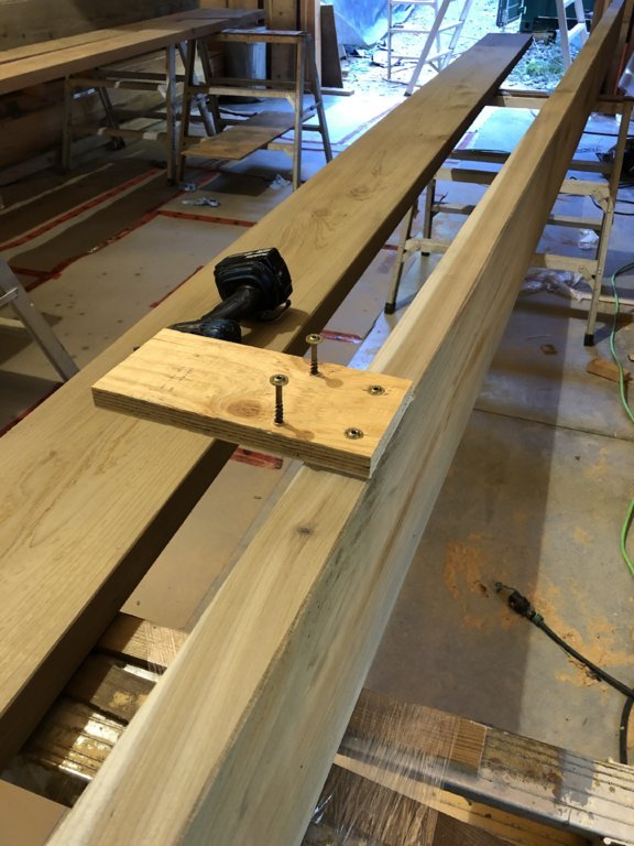

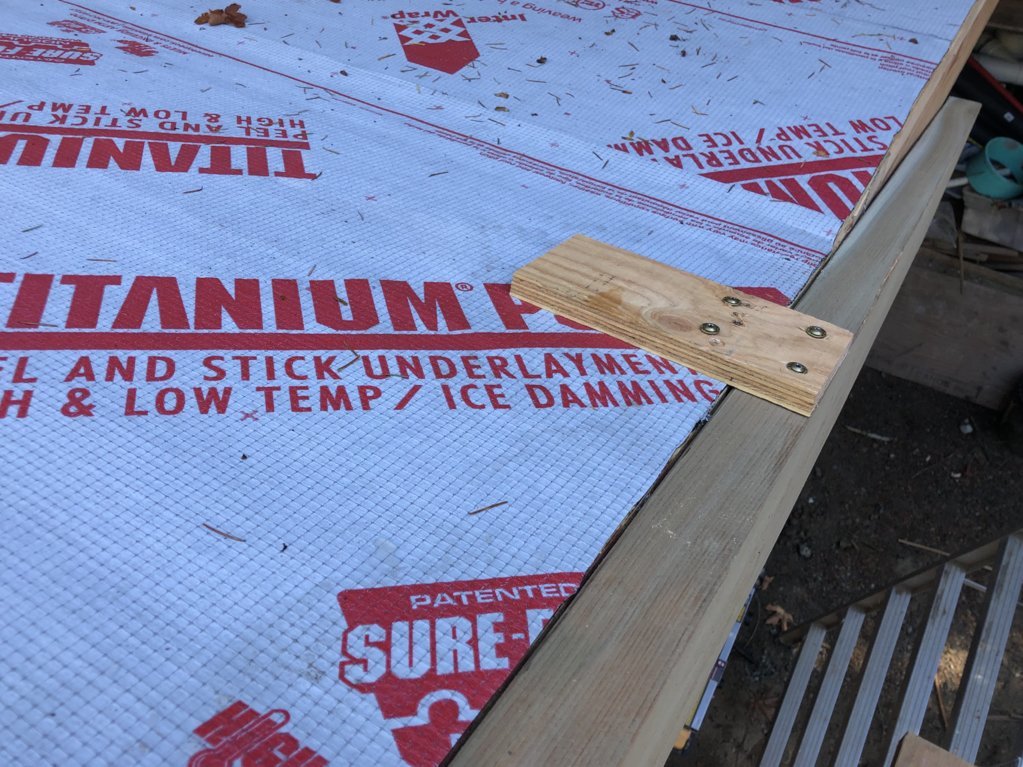

    Barge boards (boards running down roof pitch at gable ends) get similar approach
    I screw an approx 10" piece of 3/4" plywood about a foot from top and bottom of barge board with excess length projecting toward roof edge
    I can then rest the barge onto the roof , which planes the top to top of deck , and then run a screw down into roof deck in each to secure it from moving , I then can make any marks / adjustments / cuts as needed without worrying about it falling
    For the top cut when barge meets barge at the roof peak , I butt the barge boards together , and then run a circular saw through the joint cutting both at the same time and ensuring that the fit is good
    When I'm happy with fit , it gets screwed on / nailed through sub-barge same as fascias do
