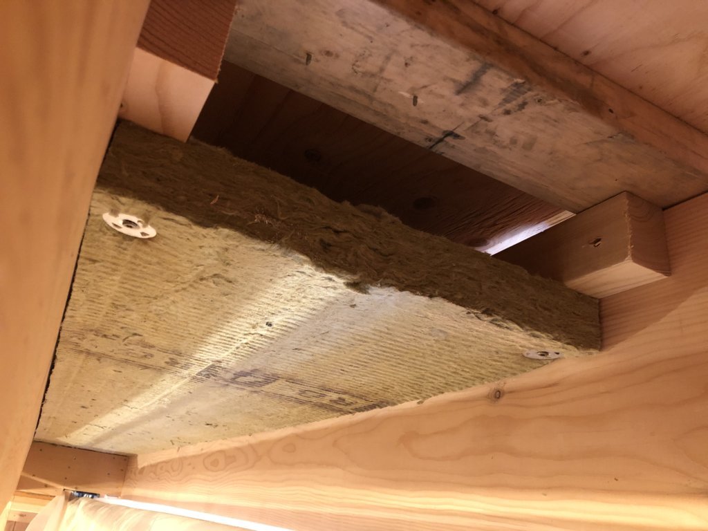

    I'm finishing up last of the back framing / drywall backing and blocking inside today . Putting my Rockwool Comfortboard baffles in the rafter bays above the timber rafters so I can install the blocking in those bays . Thought I would take a pic that better illustrates what they are doing
    2" Rockwool Comfortboard compressed mineral wool cut to 14 1/2" to fit tightly in 16" on centre rafter framing acting as a baffle to provide continuous airspace above code required insulation for airflow from soffit to ridge vent
    2" airspace above Comfortboard + 1 1/2" airspace provided by cross strapping . 7" High Density R-28 fibreglass batts install below R-8 Comfortboard for total rafter bay R-value of R-36
    Comfortboard baffles screwed to rafter blocks with barbed Schluter washers and #9 x 3 1/8" GRK R4 screws

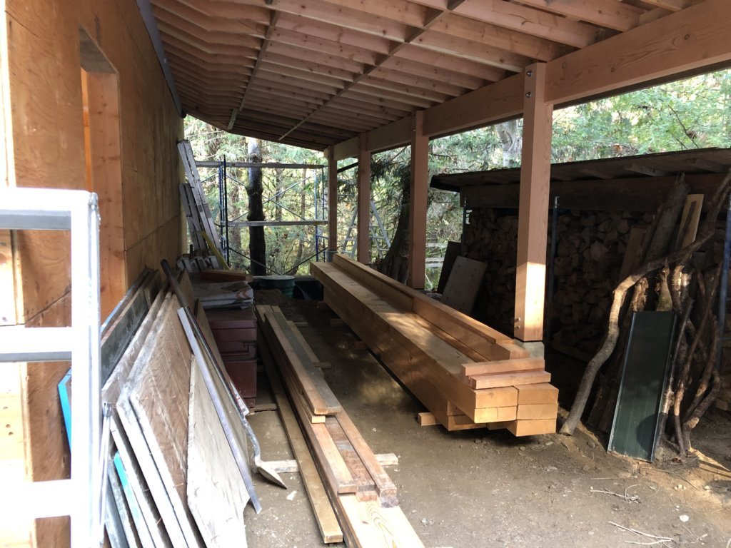

    Moved my extra timbers and some other assorted crap outside today to get ready to grind the slab and do the wiring and insulation
    We had our first frost this morning and it focussed the mind on getting my building insulated and heating system up and running
