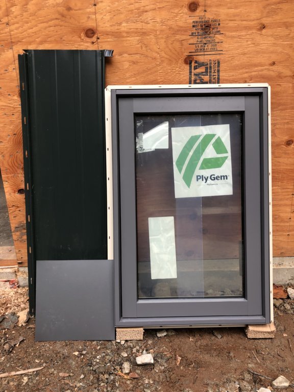

    This week was pretty low productivity on the shop but my windows arrived
    I'm using NAFS compliant Plygem metal clad vinyl windows .
    The exterior cladding of the windows is slate grey , my corrugated siding colour sample is left of the window , it's Weathered Zinc , and my roof colour in behind is Dark Green

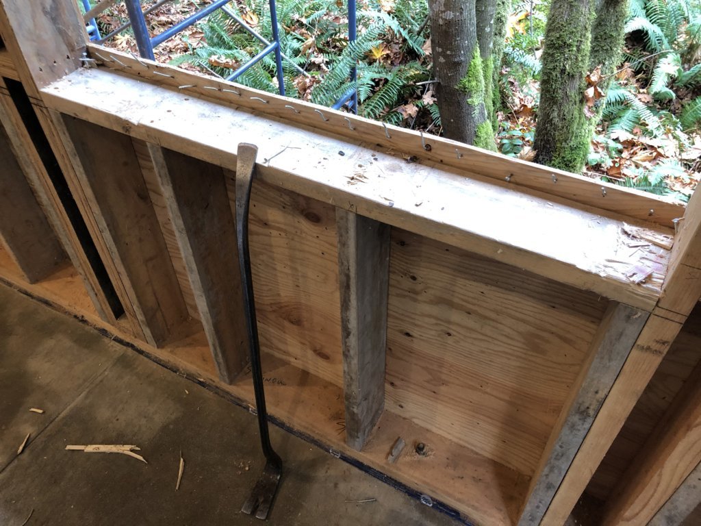

    After receiving the windows and getting a hard measurement on the frames I decided I wanted to drop my rough openings about 3/4" to lower the window bottom in relationship to where the workbench will flow into it in the window openings over the bench , so I needed to tear out the top of the two bottom plates of each window rough opening to replace them with 3/4" material . Unfortunately these window openings were nailed to the perimeter shearwall nailing schedule lol
    "and you may ask yourself , are there enough nails in this piece ? and you may say to yourself , my god , what have I done ?"
    none of the plates came out in less than about 4 pieces haha

    The good old “measure twice” and “nail it 1,765,000,439 times” method. :D

    If my engineer hasn't specified a nailing pattern I always ask him if he just want's me to go John Rambo on it lol
