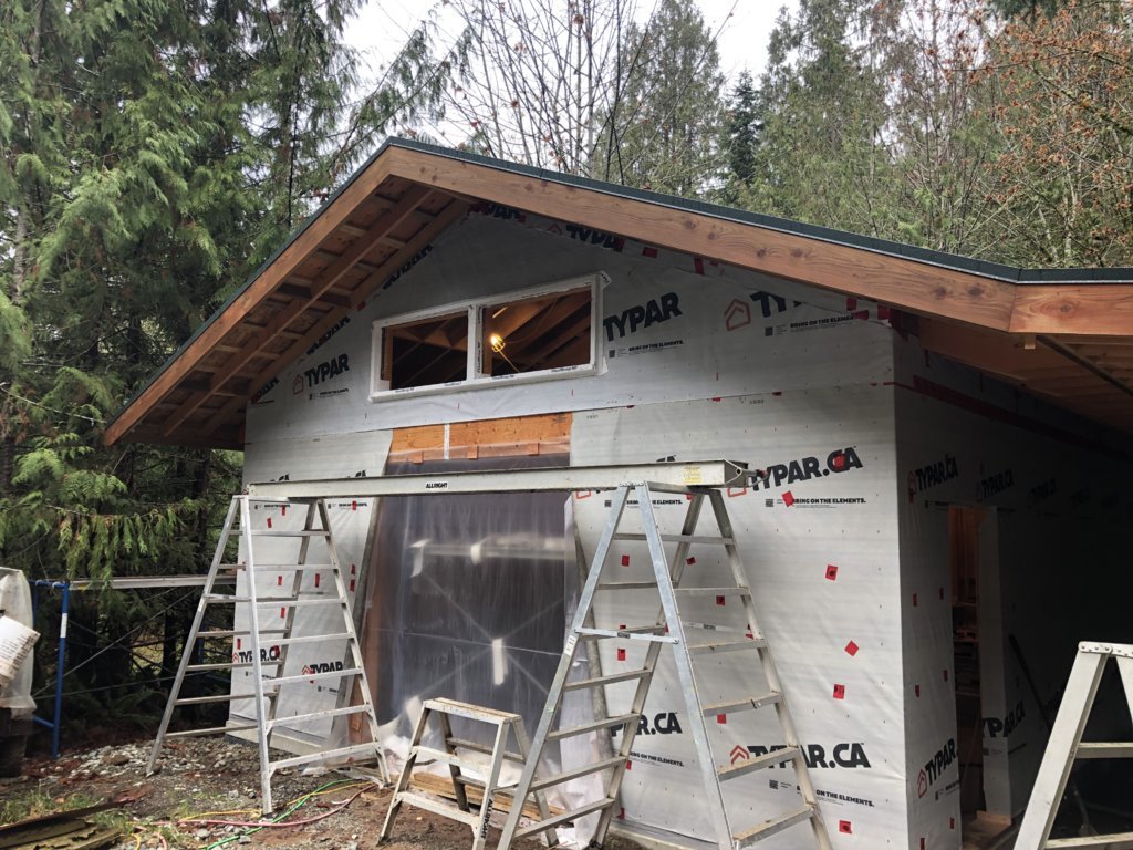

    its a 3' overhang on the gable ends and the flat soffit on left of building

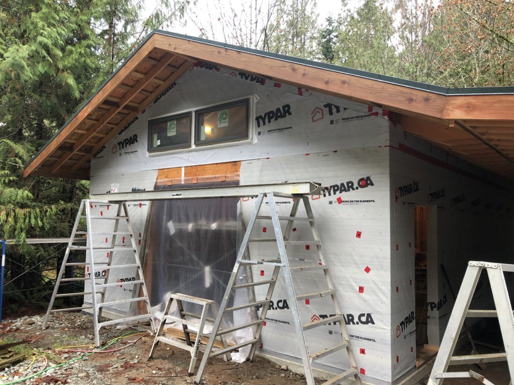

    Did you stain the gable ends or are they just wet?

    you mean the barge boards / fascias?
    They were coated with Lifetime Wood Treatment , but are also wet in those pics

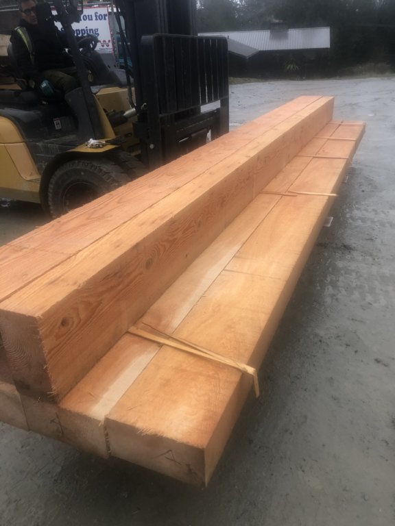

    Sidebar ~ was at my local contractor lumber yard this morning looking at some material for my next client project and ended up buying these ~
    too good a deal to pass up , 20' , #1 FOHC Structural & BTR , Doug Fir 6x12

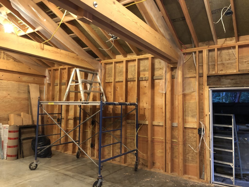

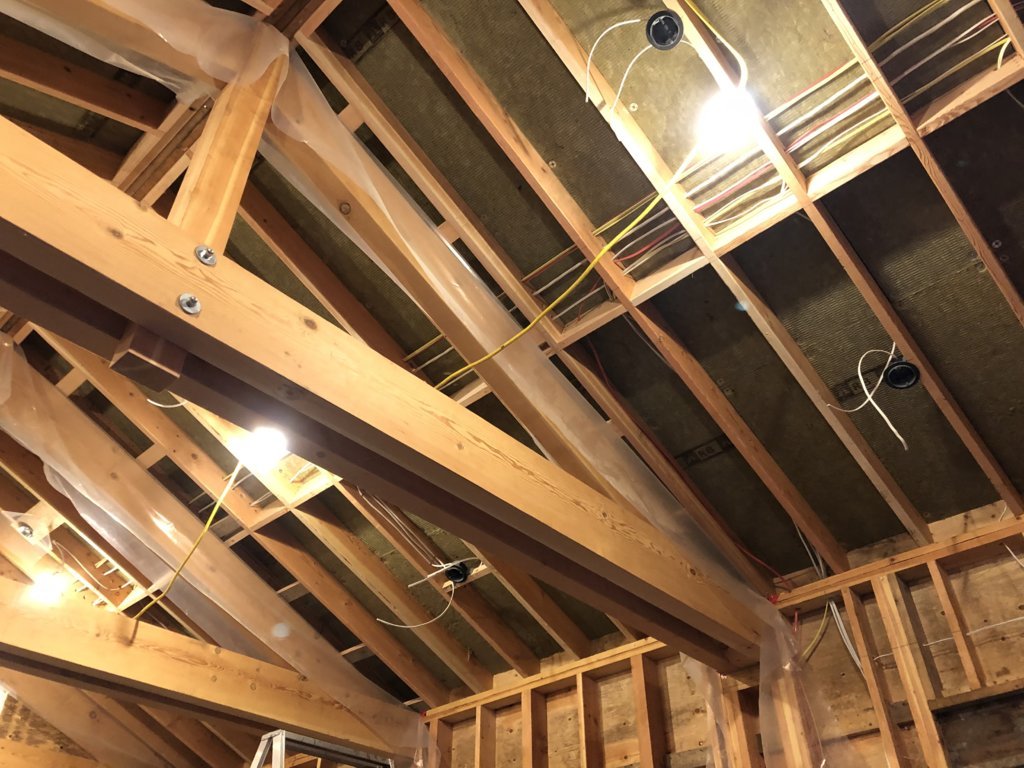

    Pretty tough to take exciting pictures of rough in electrical wiring , but I'm pretty happy , we got 90% of wire run today , hope to finish up everything tomorrow

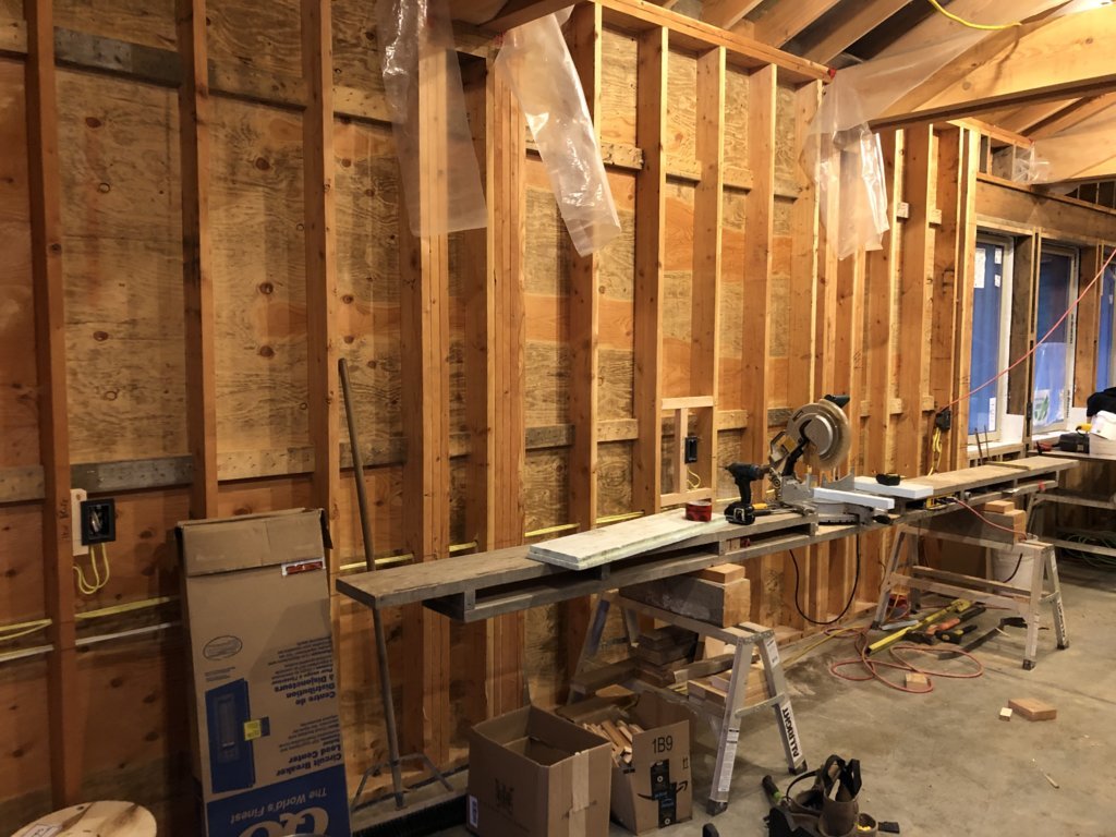

    You know you want receptacles in a very specific location when you use blocking to move them over an inch and a half!

    I spent last week boxing everything and making sure everything was where I wanted it , and then I had a meeting with my regular electrical contractor about routes for the wiring , spent about 3 days chalking lines and drilling holes so they were all perfectly lined up and looked up all the specs for the tools and utilities as far as electrical requirements go .
    Today it was me , my electrical contractor and his main guy . They were pretty giddy today , didn't have to drill anything , or look anything up or box anything , just pull wires haha
