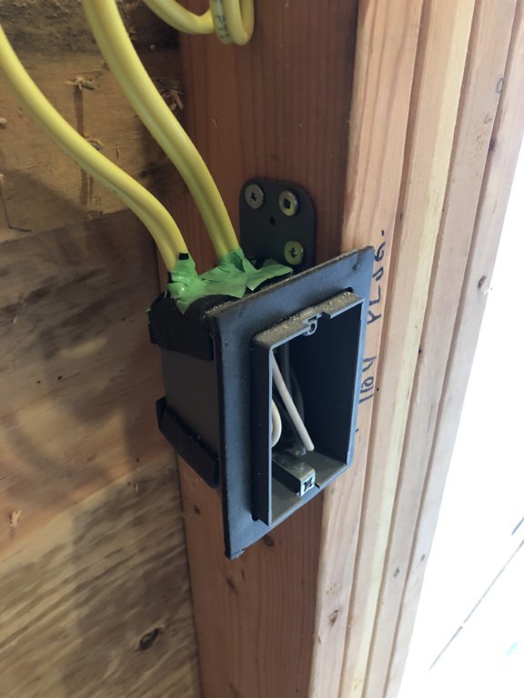

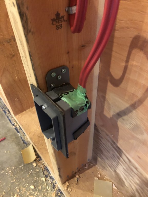

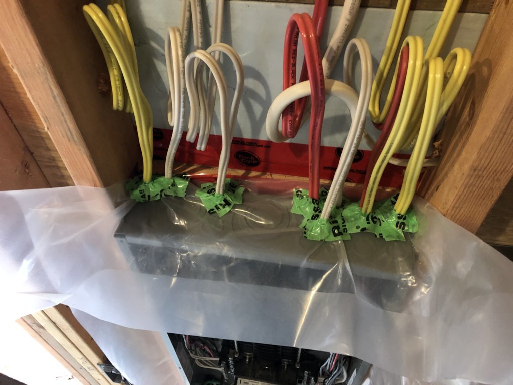

    So my insulation guy is likely to come end of next week so I'm finishing up last few details inside that need to be done before he arrives
    Using SIGA Rissan air sealing tape to seal up wiring entry to plastic vapour barrier boxes in exterior walls
    Also using SIGA Rissan to seal up wiring penetrations through 6mil poly vapour barrier that runs behind my 200A electrical panel
    Few other things I need to do for him is install venting through wall for bathroom exhaust fan and fresh air intake for woodstove , vacuum all stud bays and clean all my shit out of inside of shop so he can roll around on scaffolding

    Building code here requires the foam gasket plastic vapour barrier boxes for exterior walls or a plastic boot around a metal box . The foam gasket around the face of the box seals the vapour barrier to the backside of the drywall when it is installed . The plastic vapour barrier boxes also have a foam material that is intended to seal around the wiring penetrations which it sort of does but doesn't do a great job in all cases , especially if the electricians pull the wire into the box at an angle or tear an oversize hole in the foam when inserting the wire into the box . These holes allow outside air into the conditioned space through the plug or switch and cover so I'm just adding some extra air sealing with the SIGA Rissan tape .

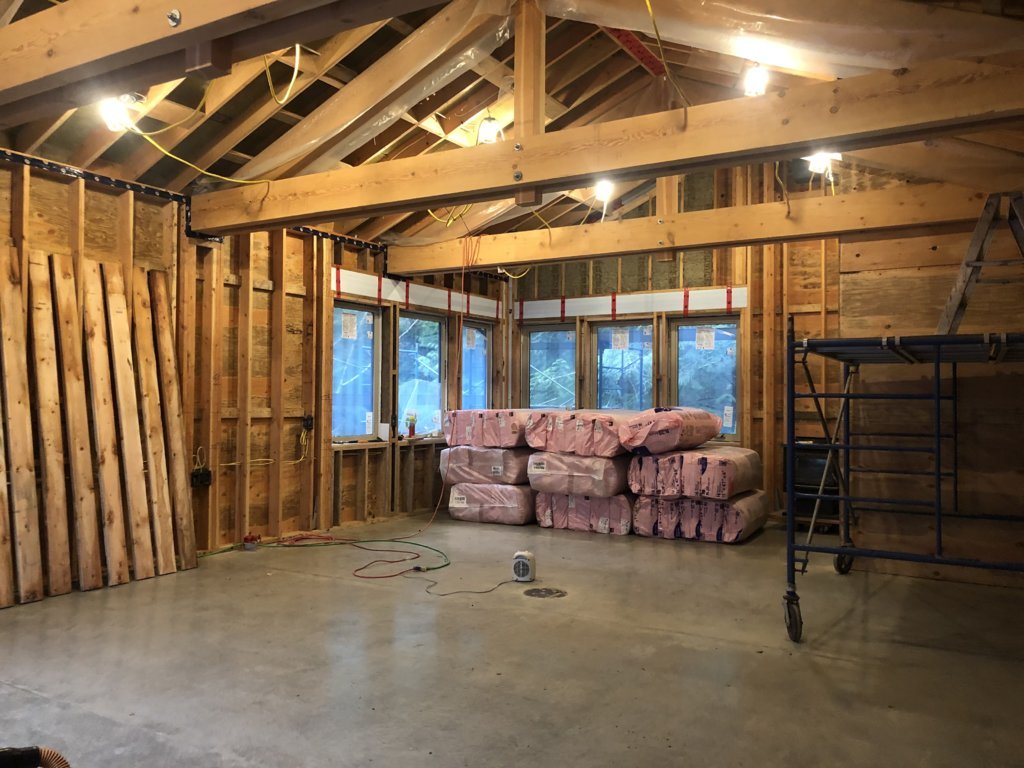

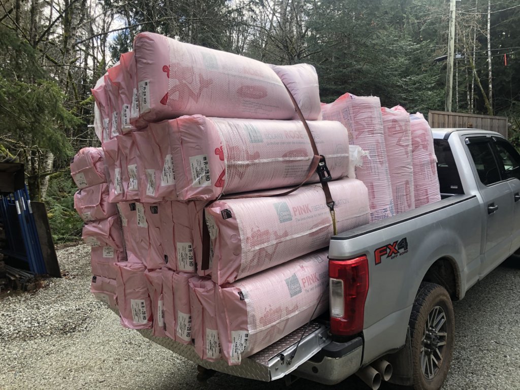

    My insulator bud dropped off material and had a recon of the shop today , he expects to be back Monday to install insulation and vapour barrier
