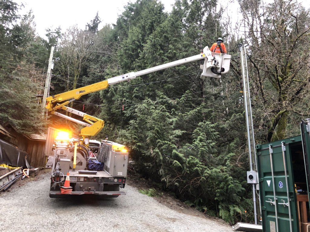

    electricians came today , built service and mast for drop pole and we pulled conductors into shop panel from drop pole through conduit , now we can call for electrical utility to hook us up
    Insulator was delayed , he'll be here tomorrow

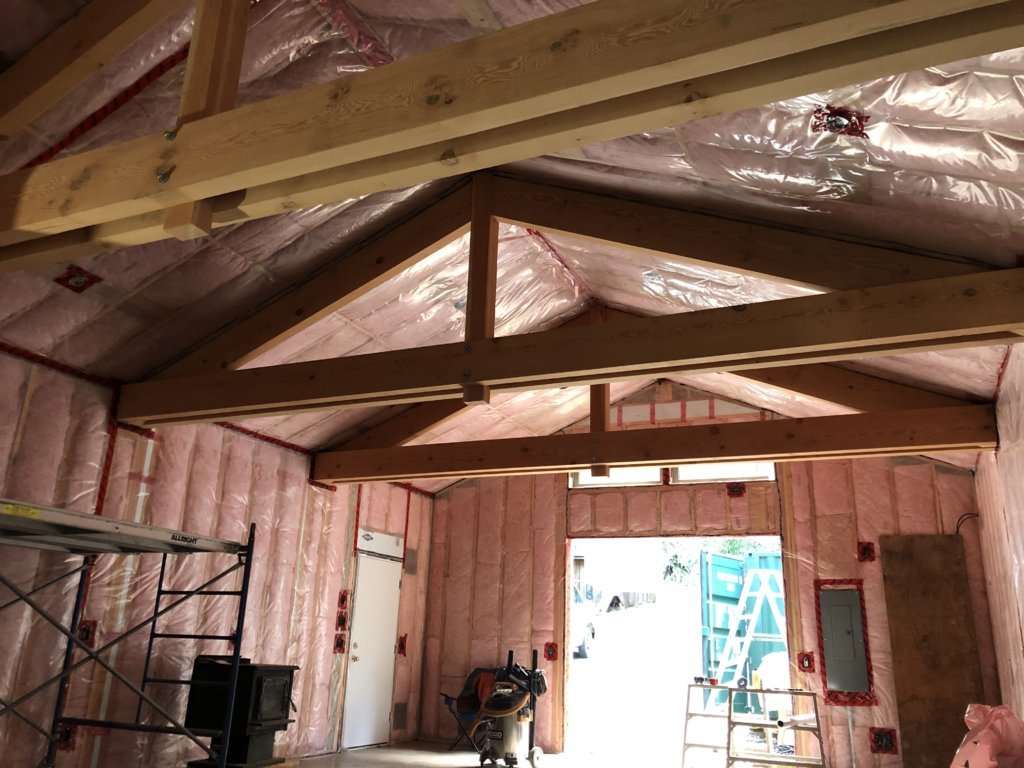

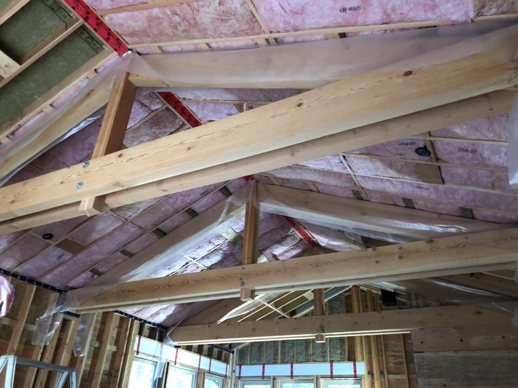

    My Insulator bud arrived about 1:00 , got about 1/2 of rafter batts installed , should finish roof & walls tomorrow

    Insulator has another couple hours to finish up in the morning but we achieved a pretty big milestone today , BC Hydro came and hooked up my service to the shop this afternoon

    I couldn't believe they were here , connection is usually 10 business days , I called yesterday lol

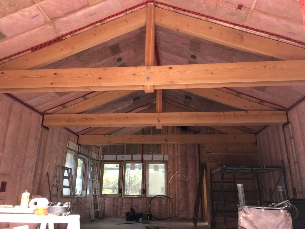

    Insulation / interior vapour & air barrier complete , hope to have inspection Monday
    Plumber came and finished boiler supply / return as well as condensate drain line and an in-wall copper compressed air line for me
