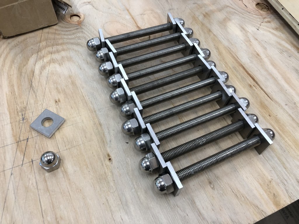

    Actual shop build related endeavour alert
    Finished separating the timbers I intend to use on my next client build from the pile so they would be on top when I moved the lot into the outside storage area and was about to start moving timbers in when I realized that I never replaced the galvanized place saver bolts in the bottom of my post connections with the stainless redi rod bolts that will be the finished product and that once the timbers were moved in I wouldn't be able to do the bolt swap without moving timbers out of the way so spent a couple hours this afternoon making the bolts
    I'll swap them in tomorrow then I can move the timbers in

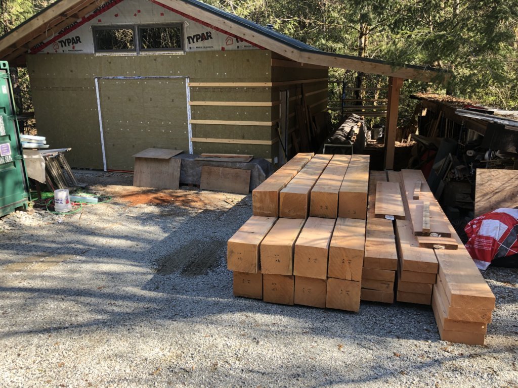

    Just realized I didn't post pics in this thread that my timber stash is moved back to the shop , thats what is going under the outside overhang area

    A wee bit heavy to move if that's Fir!
    Small gold mine at today's lumber prices.

    I've already moved it all by hand twice by myself

    Isn't cedar also a natural pest repellant? Or am I thinking of something else? Love the smell of Cedar.

    Highly recommend anti seize on those stainless nuts and bolts. Stuff galls like there's no tomorrow.

    it's Douglas Fir

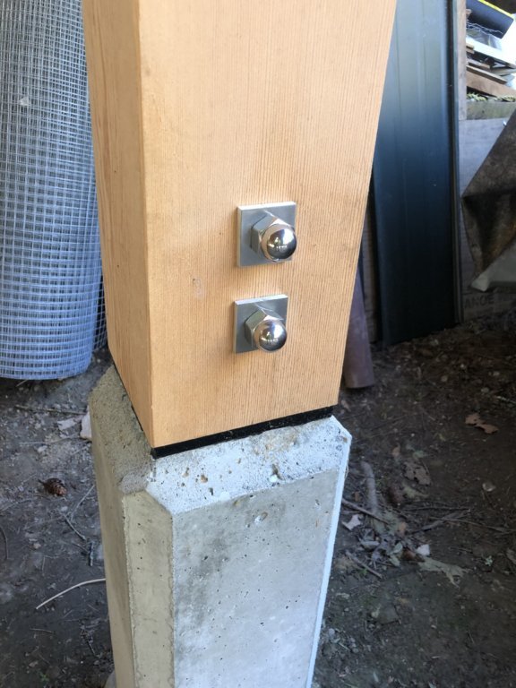

    Finished post hardware installation look
