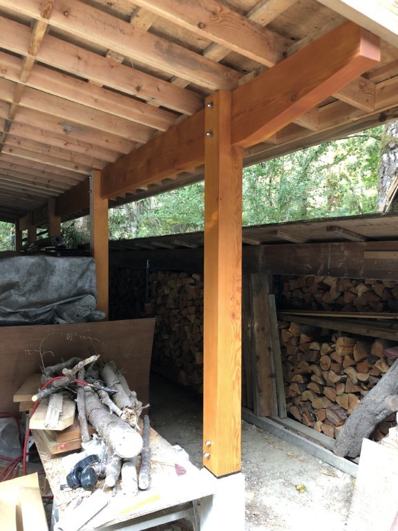

    I’m surprised you didn’t mortice those square washers into the post. Any reason why not, other than the amount of work required?
    You should be proud of your wood. It’s big enough to make your shop look small.

    Just crank the nuts down tighter! :p

    Acorn nuts only crank so far. I like the mortise idea though

    Not the look I'm going for , trying for a turn of the century timber framed factory look . All hardware will be black eventually .

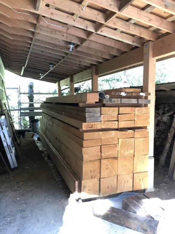

    Timbers are all moved in , I'm officially tired lol
    Everything from dunnage level up is earmarked for my client build , that job has a lot of short timbers so I am able to use up some of my long timbers that are too twisted to use at their existing length

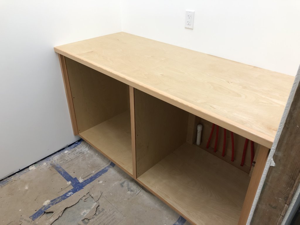

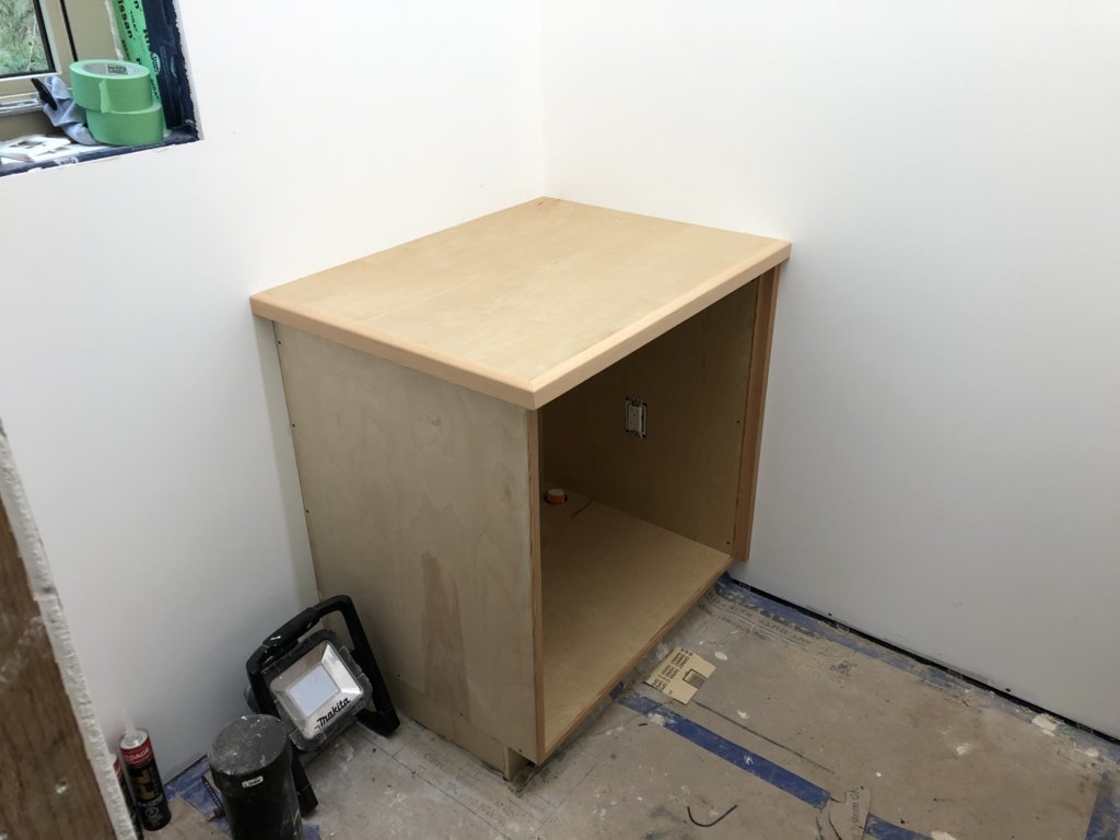

    Actually did something shop build related this weekend ~
    Made countertops for my bathroom / utility room cabinets and coated the cabinets and tops with 3 coats of polyurethane
    Plumber comes tomorrow to install boiler , hydronic manifold , circ pump etc so it was last call at the saloon to get cabinets sealed
    Sink box will get a finished applied gable later in case anyone was horrified by the exposed screws and kickspace platform

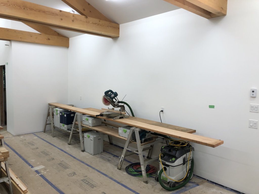

    got a temporary cut off station set up in the shop so I can start picking away at the soffits in my spare time
    Want to get soffits and siding done before rainy season sets in here if possible
    Kind of a bare bones set up but I've made do with less . I'm going to add some plywood support wings to either side of the saw
