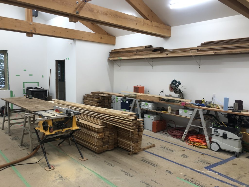

    Actual work on the shop is happening
    I'm off work from my client jobs till Jan 03 , brought home a bunch of tools and I'm trying to get my shop soffits done .

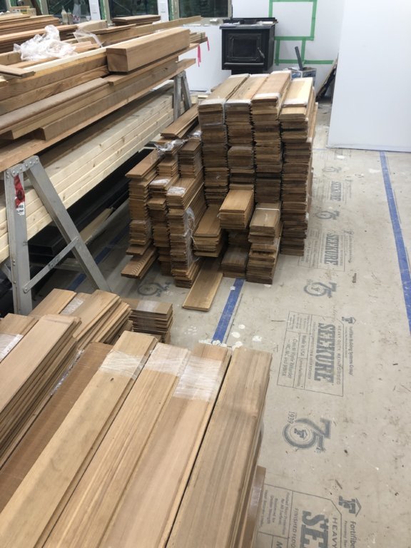

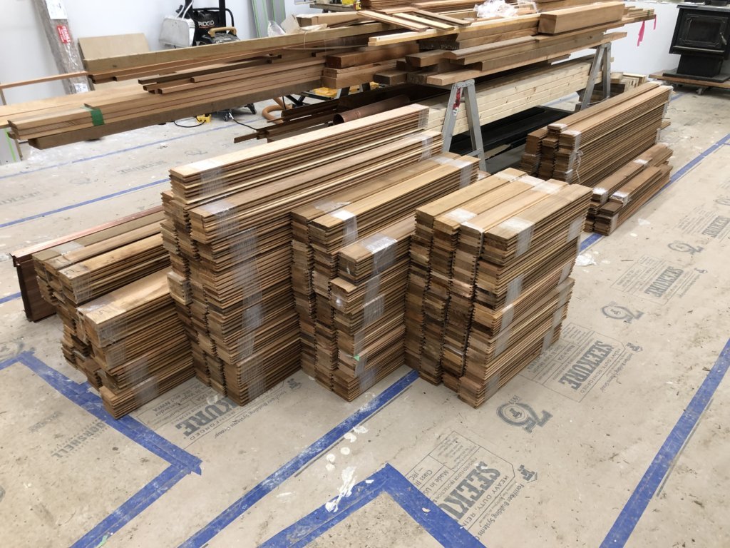

    I originally was going to try to use up a bunch of 1x4 t&g clear cedar I already had but that involved re-milling 1/2 of it so that it would all look the same and fit together . After much deliberation I opted to purchase some 1x6 STK (standard tight knot) cedar t&g . I had to pay about $2K CDN but I justified that with the time savings and my limited timeframe away from paying work to get this done . Ideally I will use up the 1x4 on client jobs and recoup my money.
    So I'm super stoked to actually be working on the shop again , unfortunately we are experiencing daytime highs of -7C (19F) right now so progress is likely to be pretty slow
    My temporary work set up inside for cutting alongside the stack of 1x6 cedar I bought

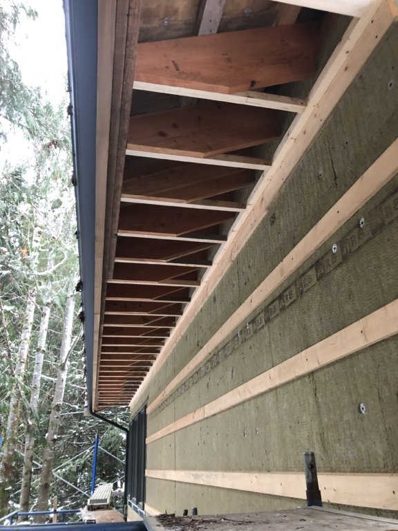

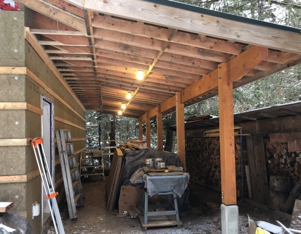

    Got all the flat soffit back framing done , will be able to start installing the soffit material tomorrow
