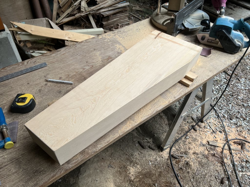

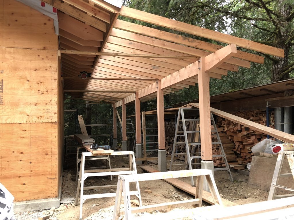

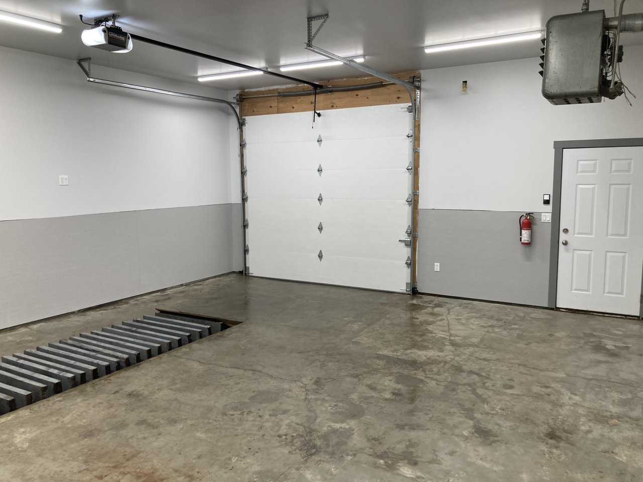

    Was determined to do something at the shop today after visiting my pops for Father's Day , so I cut the false timber ends that will go on either end of the shop at the ridge and at the exterior walls from some short 4x12 timber ends I had
    The beams have the same profile as the timber ends on the post and beam extended roof overhang shown below
    Needed 6 total , cut and belt sanded them with 50 grit this afternoon , still need to coat them with Sunfast before I put them up , but hopefully this is the start of the final push to get the shop to the point I can get my occupancy / final inspection

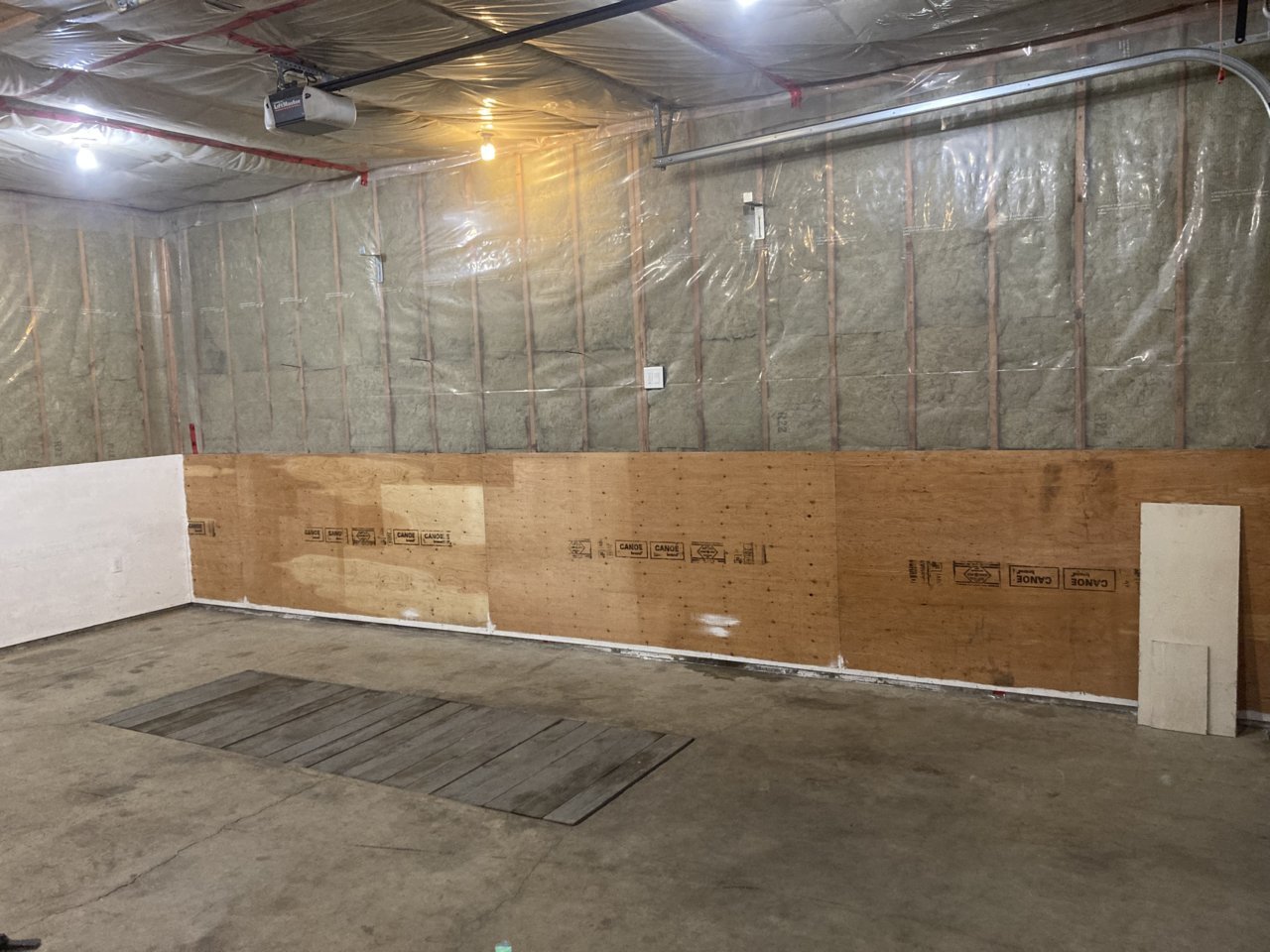

    I’ve been wondering how your shop has been progressing, since this “just happened” to mine. It looked like this inside minus the plywood I put on the lower 4’ soon after we bought the place 10.5 years ago.
    Yup, it took ten years to get started, ten weeks to finish.
    I just moved some stuff back in yesterday, still have some setting up to do over the next while.
    Keep at it man, having your space to do what you like, and set up how you want is a wonderful thing.
    I spent most of the day in my shop today on a motorcycle project, having good lighting and the shop being so clean I hardly dared to make a mess just made it so much better than before.
