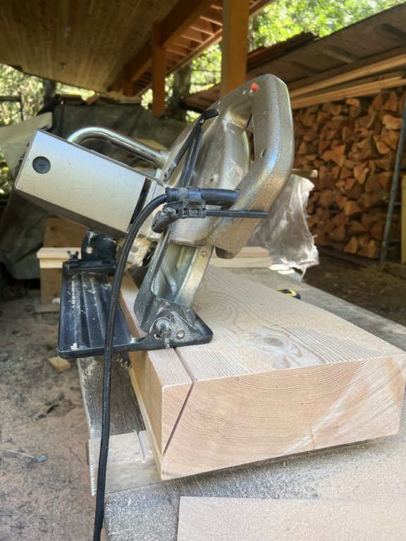

    This weekend's progress ~
    4 of the 6 false timber ends needed to be ripped to 22.5 degrees to match the 5 in 12 roof pitch as they install to the underside of the gable end rafters , I did that with the 16" circular saw

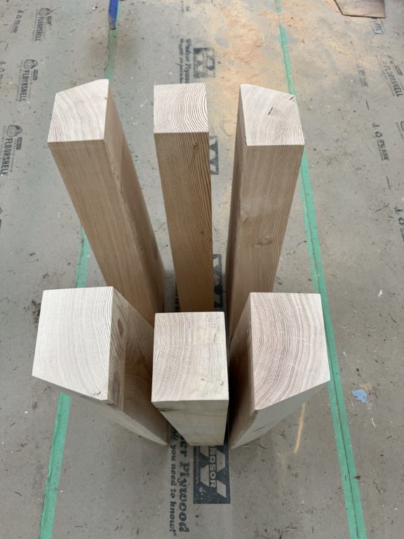

    The 6 false timber ends in sets of 3 for front and back of building . Pitched topped ones mount to underside of gable end overhang rafters in line with the exterior walls , flat top ones go at the ridge to underside of projecting structural ridge beam
    After taking this picture I coated them all with Cloverdale Sunfast

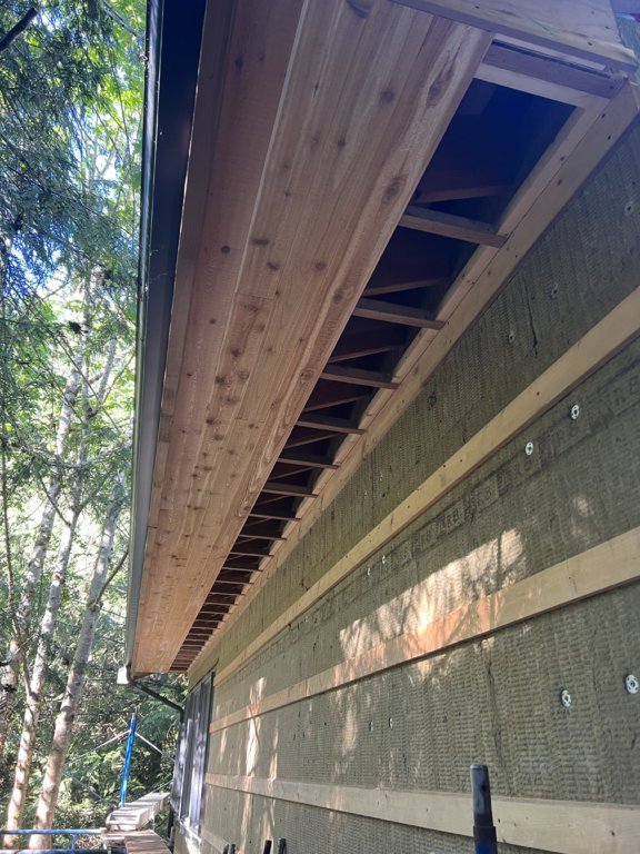

    Finished the soffit that was not installed to the right of the post and beam line (you can see it unfinished in first picture of me ripping the top of false beam above)

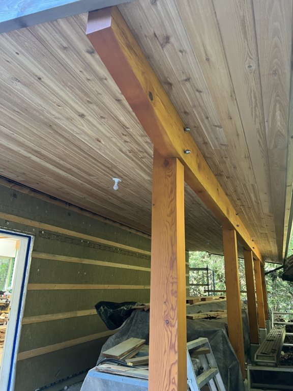

    Also got about 1/2 of the opposite side of the building done

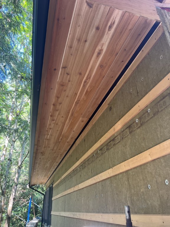

    Got back side level soffits and vent completed today
    next up a bit of backing in the gables and install false timber ends , then soffit up the gables

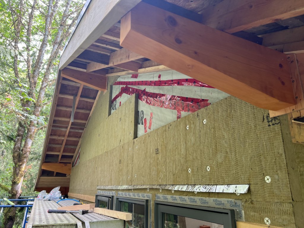

    Tough to get a decent picture with all the scaffolding up and in the way but I got the rear false timbers up , decided to start on the back to work out any issues before doing the front that will be seen all the time
    worked out well , nothing to worry about , had to apply a bit of the Comfortboard that was missing to install the ridge piece and add a bit of blocking but other than that , no surprises
    Moving over to the front to install the false timbers there then I will start applying the gable end soffits , front first with the better pieces , anything marginal will go on the back side

    Is the Comfortboard ok like that without siding or house wrap?
  20. Jul 2, 2022 at 4:03 PM
    #980
    OZ-T
    OZ-T [OP] I hate my neighbour
    Dec 15, 2009
    #27584
    50,587
    Peter North
    British Columbia
    you mean exposed to the weather ?
