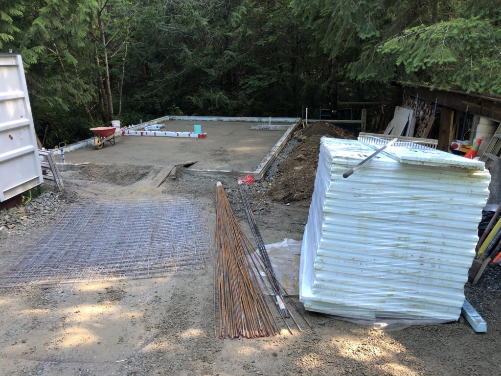

    Materials have arrived
    Slab prep commence

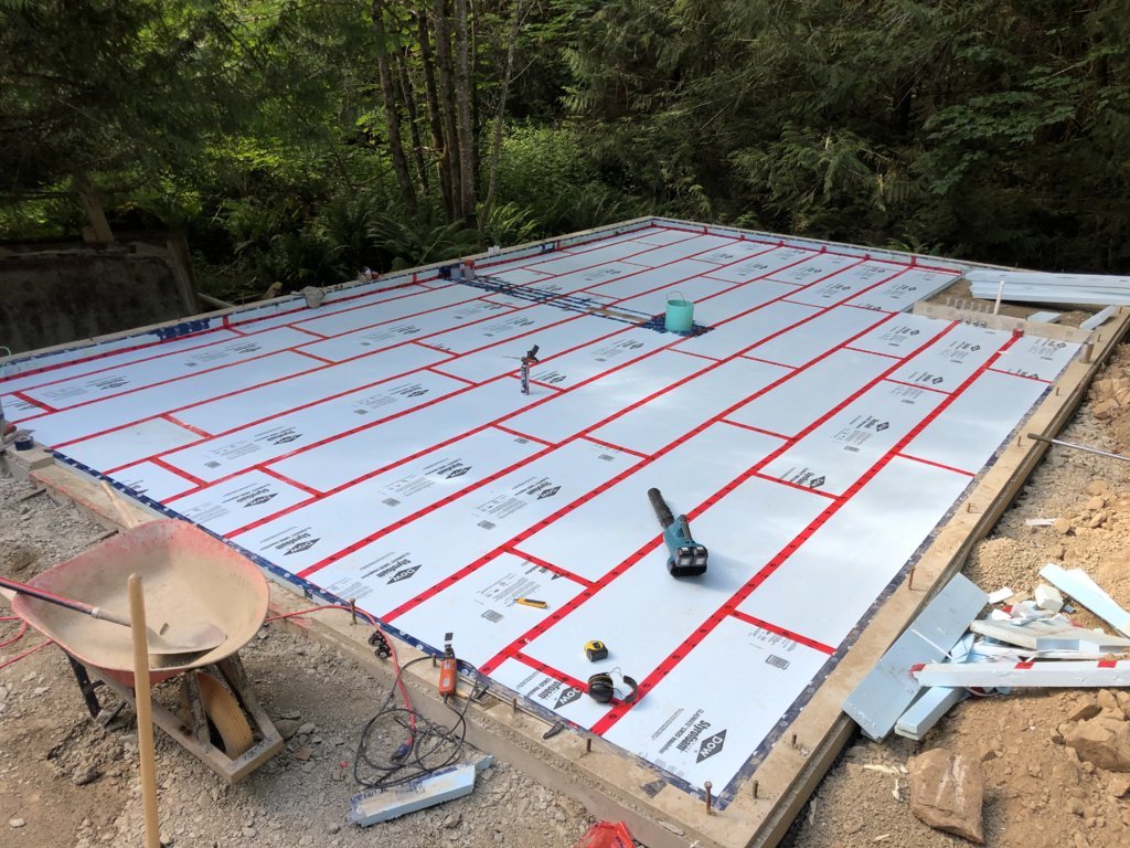

    Only got a part day in today but all the 2 1/2" R-12 XPS insulation is fitted and taped , dust collector pipe coffin cut down to insulation plane and vapour barrier in box taped to top of insulation plane
    10" sewer pipe in centre of slab will be cut down to top of slab height and will house 4" dust collector line and 2" electrical conduit for tablesaw island . It will have a lid .
    Bathroom area is on hold till plumber can install sub slab plumbing lines
    Tomorrow I will install the vapour barrier , rebar and remesh

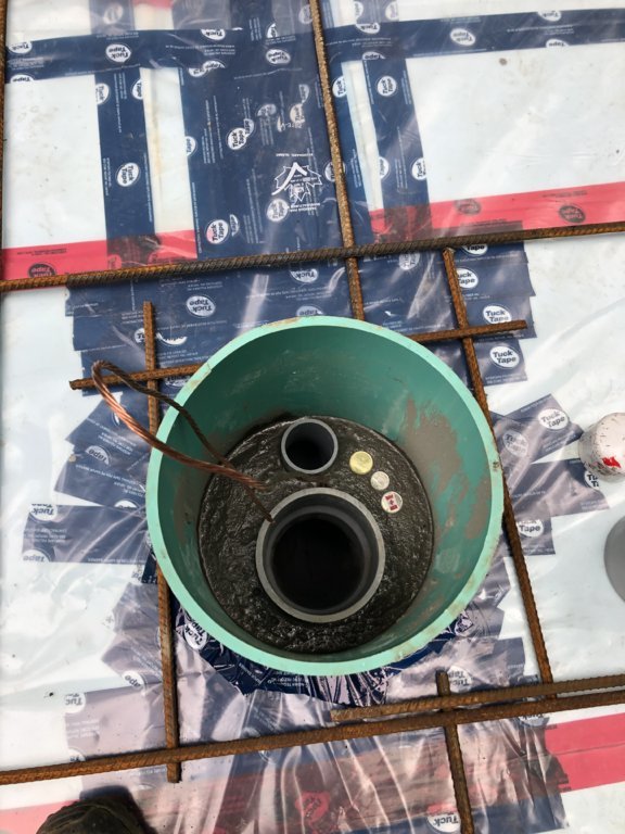

    Didn't get all my remesh tied in today but got the vapour barrier down and taped , rebar cut and laid out and started tying in the remesh
    Reinforcing is 10m rebar 18" on centre each way with 6"x6" welded wire mesh tied on top . Hydronic tubing will be attached to the remesh .
    Close up of the tablesaw island utilities sump
    2" electrical conduit and 4" dust collector line with grounding cable
    I poured some concrete grout in the base of the sump so it won't move around at all when we pour the slab and also so it will be rigid when I cut it to height
    Back at it again tomorrow

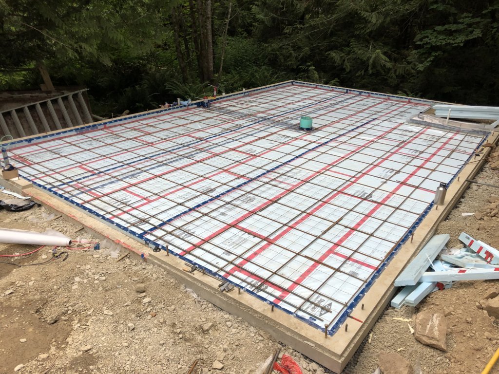

    Bathroom sub-slab plumbing installed and inspected
    Hydronic tubing installed on 9" centres , rebar chaired , pretty much ready to pour
