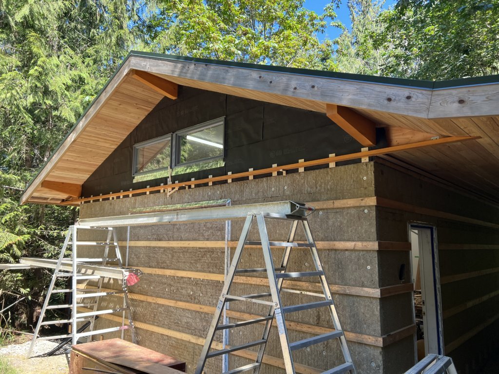

    In the last couple days I've been prepping the gable ends for the shingle siding by laminating 1/2" plywood over the Comfortboard to carry the shingles and I papered the plywood with 60 minute building paper for a moisture barrier between the shingles and plywood . I will install a plastic matrix rainscreen mat prior to shingle installation .
    I started fitting my transition trims that divide the shingles above from corrugated metal siding below .
    The transition trims are at the elevation of the flat soffits on each side of the building , the bottom of the transition trim at the same elevation as the soffit trim I showed earlier . This produces a single elevation all the way around the building for the top of the corrugated metal .

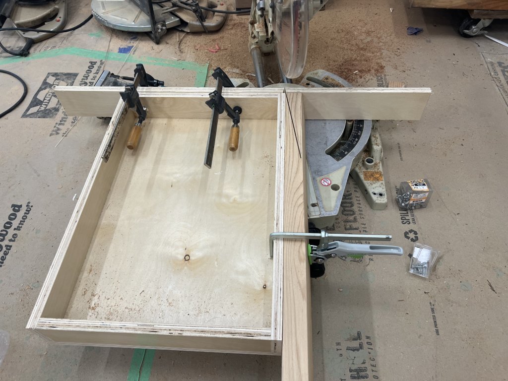

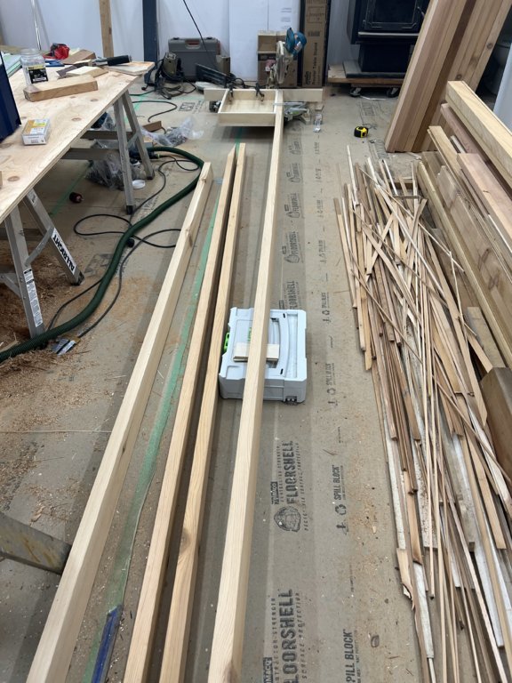

    One complication of the transition trims being at this elevation is that on the wide exterior overhang side , the transition trim terminates into the 2 in 12 soffit . This requires me to mill a 80.5 degree cut on the end of the board . Not easy to do accurately .
    This is how I solved that problem . I made a square shallow plywood box with my track saw to make sure it was perfectly square , with the total height of the sides so that with the chop saw fully depressed there was still 1/8" of clearance between the box and the chop saw motor and body of the saw .
    I screwed a plywood subfence to the chop saw fence through the stock screw holes in the Makita LS1013 fence .
    To that plywood subfence I could clamp my box , and to the box I could securely clamp my 18' 2"x4" trim stock perpendicular to the fence allowing me to cut an accurate 80.5 degree cut on the end of my trim by setting the saw at 9.5 degrees
    Excuse the state of the shop , its a pigpen in there right now

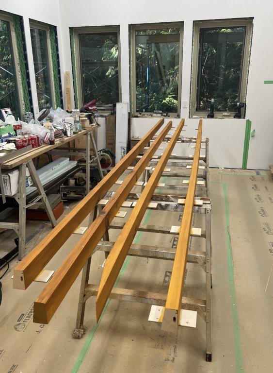

    Back transition trim test fit ~
    Front and back sets stained ~
    Tomorrow they go up for good and I can start on the window trims

    and they are up
    Sorry for the wide angle lens , couldn't get further away on this end

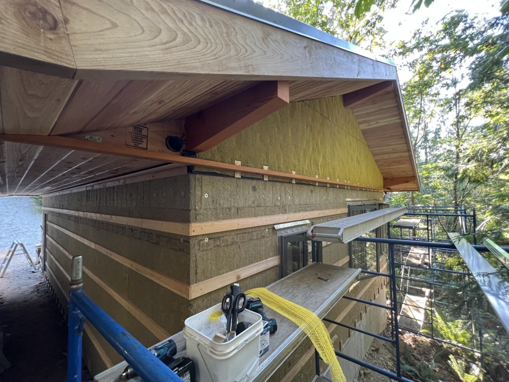

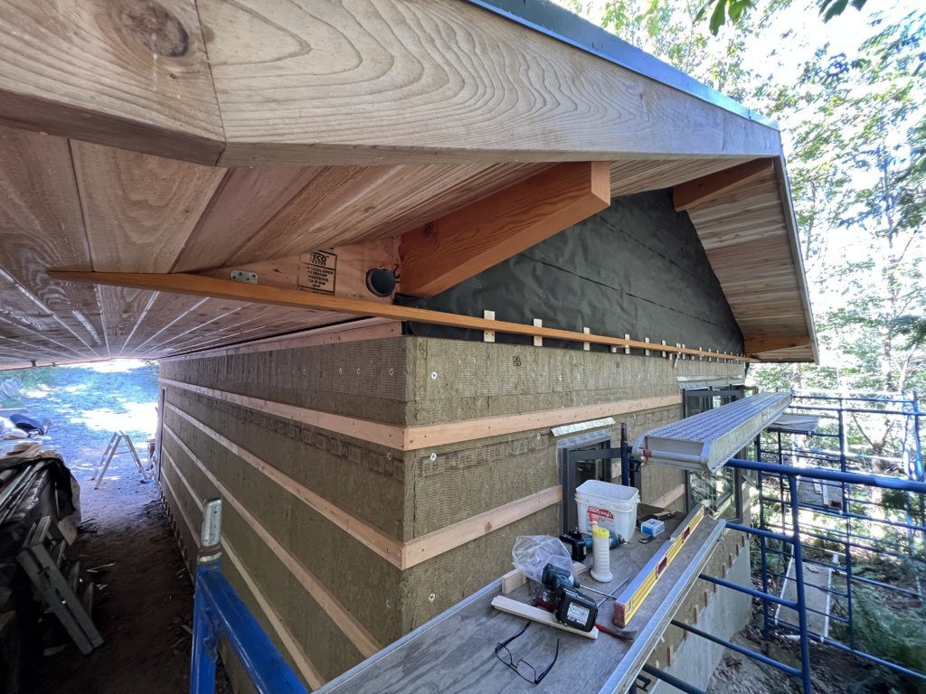

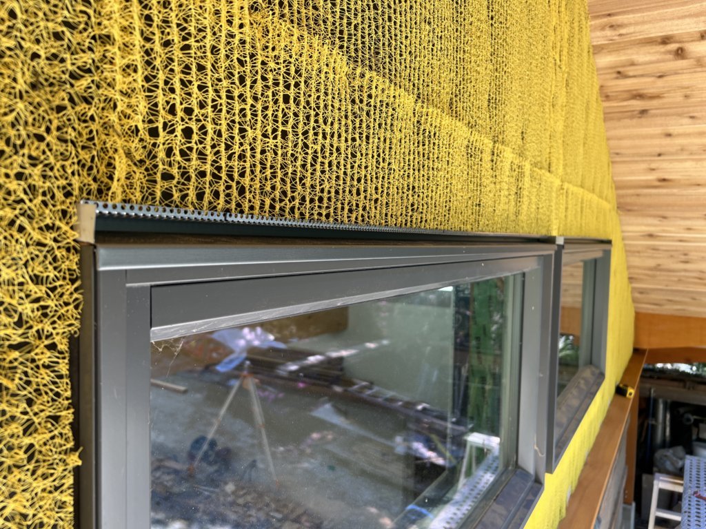

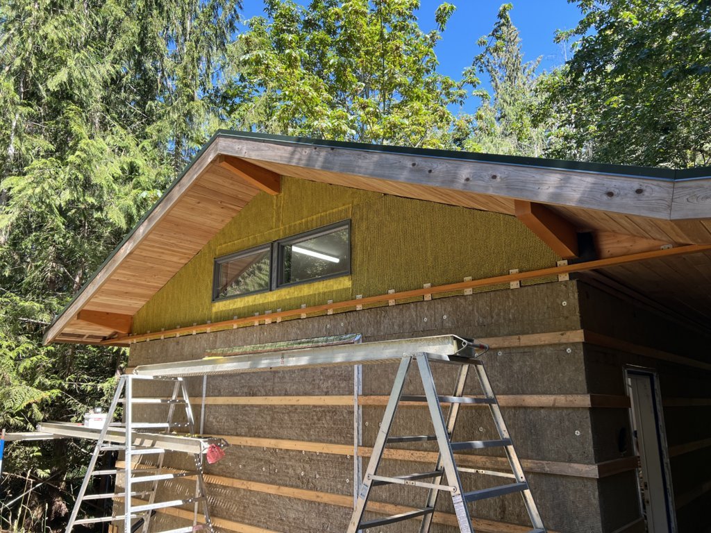

    Rear trim straightened , fully screwed off and Home Slicker rainscreen matrix applied
    I'm packing it in for today

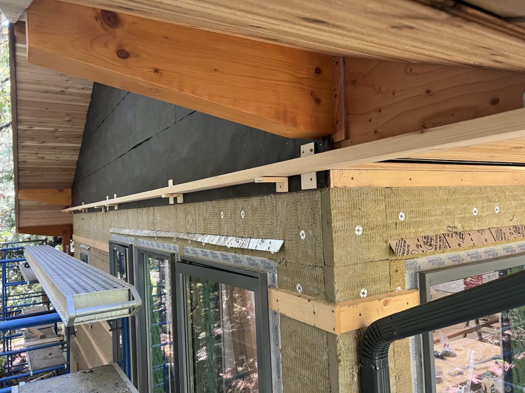

    Front trim straightened , fully screwed off and rainscreen matrix applied
    Close up of detailing above door or window penetrations ~
    our BC Building Code calls for a 10mm drained and vented capillary break (rainscreen cavity) between the WRB and the siding . Above doors and windows there needs to be a flashing that protects the opening in the building envelope directly above the door or window (above the trim no bueno) that is lapped by the WRB , creating a continuation of the weather barrier . The Comfortboard on my building complicates this a bit but how I achieved it was run a flashing tape through the Comfortboard layer , extending down 2" where the wall leg of the head flashing would eventually be installed , with the lower release paper on the foil tape left on . After the head flashings were installed I pulled the lower release paper on the foil flashing tape and stuck it down to the wall leg of the head flashing creating a continuous flashing back to the WRB .
    Our head flashings must also include an end dam to prevent wind driven rain from travelling sideways off the end of the head flashing and behind the siding . The end dam height must be 1/10 the value in mm of the 1 in 5 driving rain wind pressure in Pascals for your area from the official climate data for your region , in my case the end dams must be 13/16" tall .
    A perforated aluminum drain / vent is installed above the opening that the rainscreen can drain out of and air allowed into the cavity (in this case the Home Slicker plastic rainscreen matrix )
    PS ~ That flashing is the colour of my corrugated metal siding which I think is going to look pretty sexy , Weathered Zinc , matches my windows pretty well too
