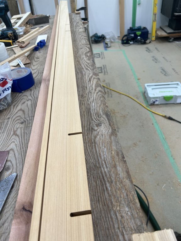

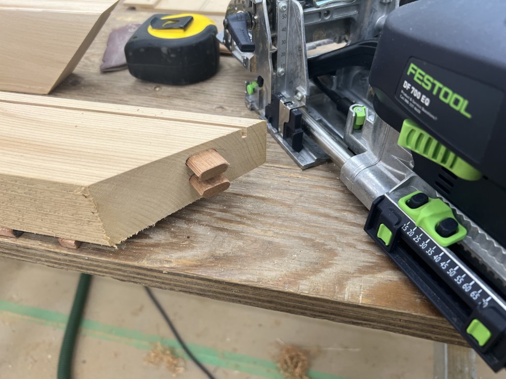

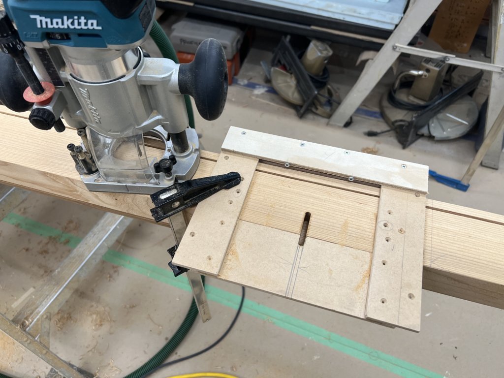

    Working on my corner window wrap sets today ~
    I'm using a couple 8mm sipo dominoes to reinforce the head and sill trims where they wrap around the corner
    Using a little jig I made and my Makita cordless router to mill slots in the back of the head trims that accept the "fin" of the end dams on the flashings over the windows
    All slotted , ready for assembly ~

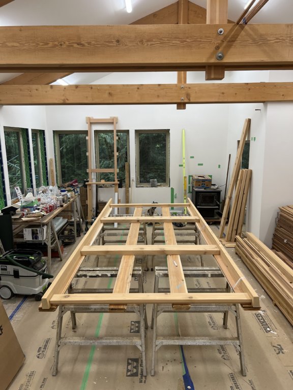

    I had to dung out the shop a bit to rig up a table to assemble these 2 large window trim sets and it was about 10 seconds after I took this picture when I said out loud to myself "how the fuck am I going to get this up on the scaffold , in place and attach 2 of these together by myself ?"
    "it was at this moment that he knew , he fucked up"
    lol

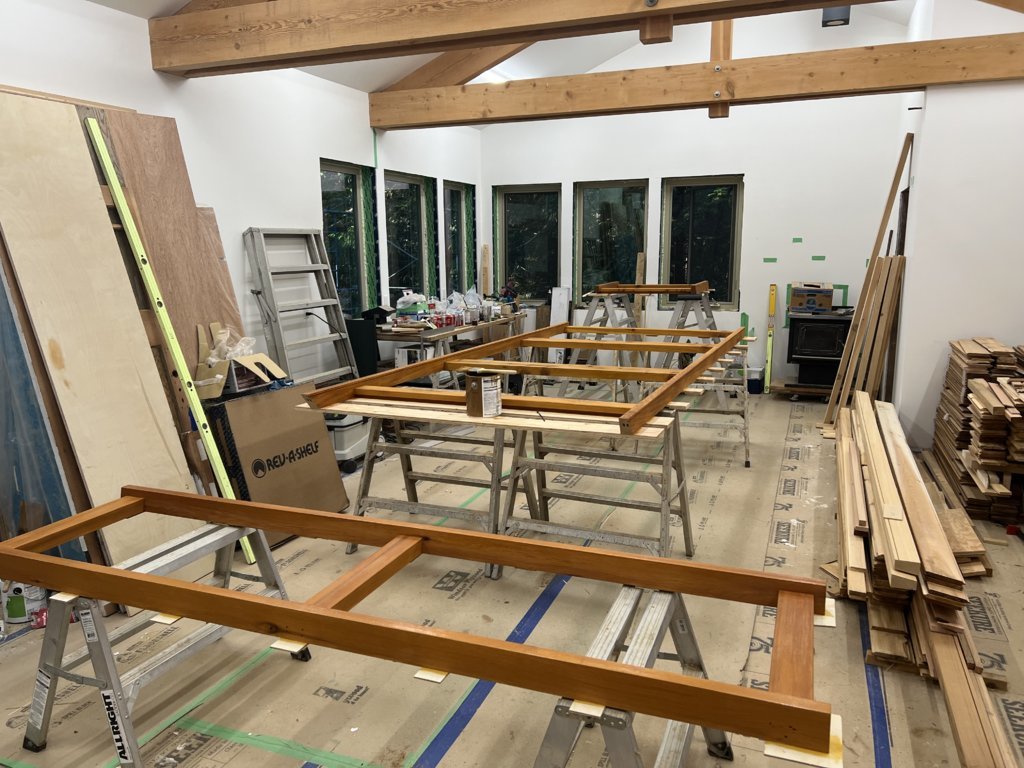

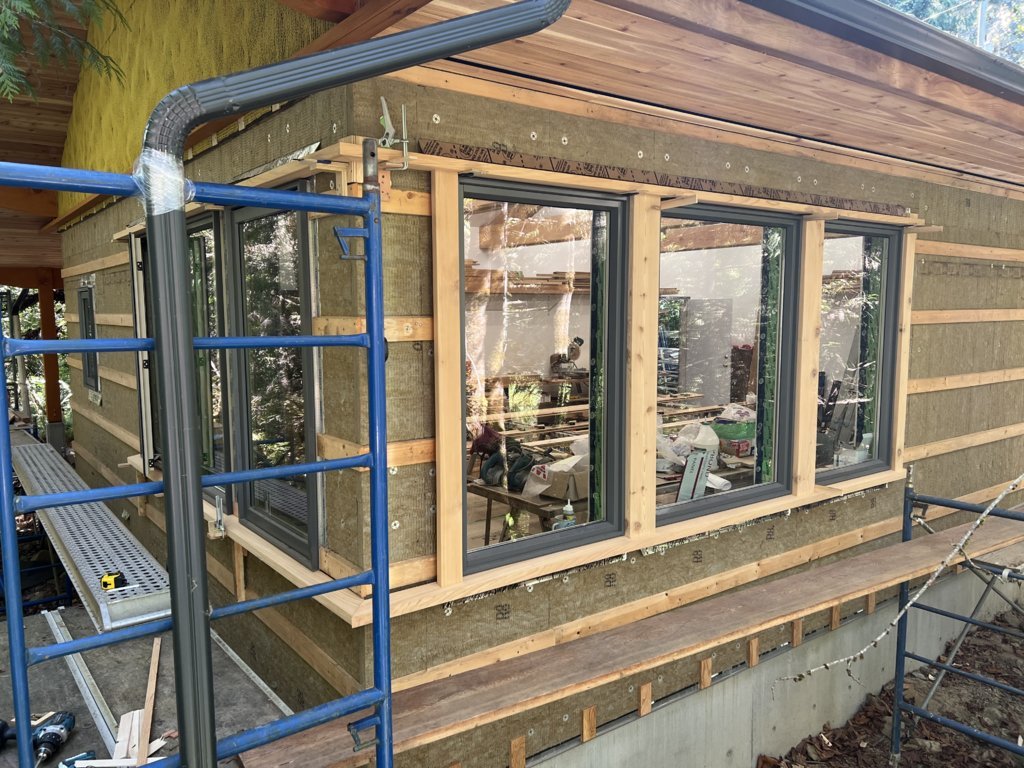

    K , got the one trim set I have built up for a test fit without any massive drama but having it there has prompted a change of plans ~
    I'm going to take this set back in to the shop and stain it and the 2 other window trims I have made up , then install them and THEN build and try to join the second side of this window wrap
    I tried dry fitting the top and bottom trims of the second set to this unit after it was up and there are too many variables with things moving around because they are not attached in their final resting position . In order the fine tune and join the two corner wraps , glue and clamp the domino connections etc , one side has to be solidly fastened to the building first
    Stay tuned

    Trim sets all coated , should be able to put these three up tomorrow
    Had to use all the sawhorses I had at the shop so I ended up with a Goldilocks and the 3 bears set up .
    Too short , too tall , & just right lol

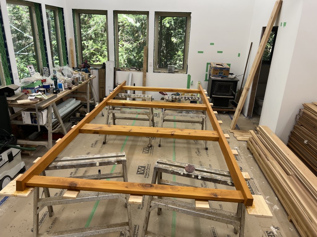

    Progress update for today ~
    ~ slept in
    ~ had to go get some materials
    ~ installed the 3 trim sets I stained last night
    ~ fit the top and bottom trims of 2nd 1/2 of the wraparound trim set to the 1st after I had it fixed in place
    ~ got the 2nd 1/2 of the wraparound mostly assembled
    ~ was tired so stopped working
    Tomorrow I'll finish building the remaining wraparound trim set and coat it which means it can't go up till Mon
    I'll probably do some siding prep in the meantime
    Coolerman, Pchop, Drainbung and 4 others like this.

    Second side of the corner wrap assembled and coated
    connect the dots tomorrow
    Coolerman, VE7OSR, SwampYota and 4 others like this.

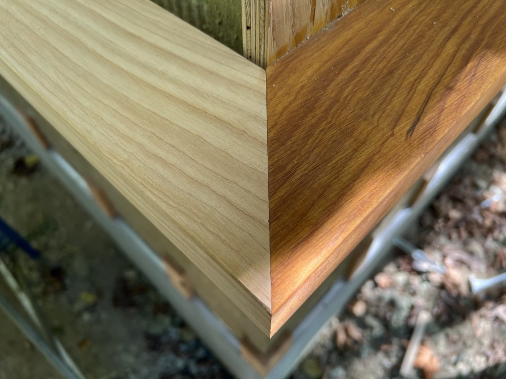

    Get a better picture later when I can get rid of the scaffolding but dots officially connected
