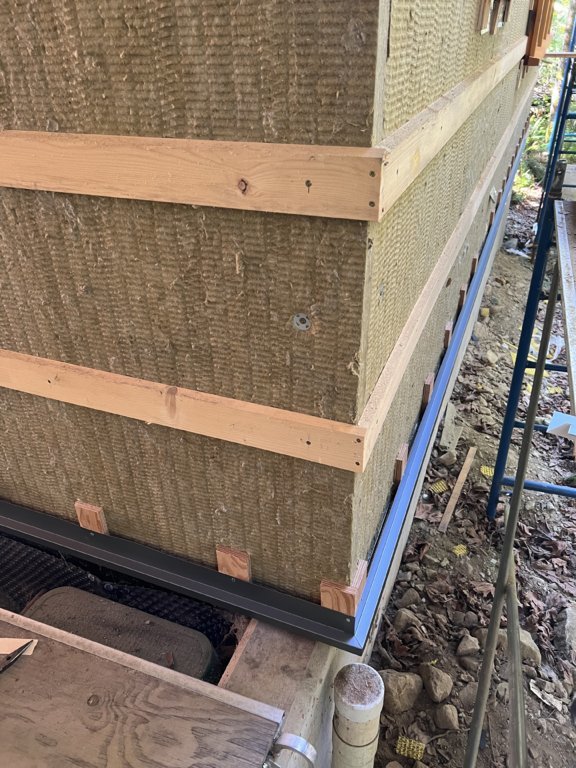

    Installing the base flashing for the corrugated metal siding today , I guess siding season has officially kicked off
    You can kind of see now how the vertical plywood blocks at the bottom of wall work to provide a 3/4" drain and vent cavity for the rainscreen while still providing attachment for the bottom of the siding & flashing

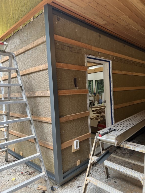

    Finished up installing all the flashings required to put on my corrugated metal siding over the weekend .
    Not sure what kind of automated brake the metal place has that can turn out these corners but I would like to see it in action
    Corners , base and upper J in place

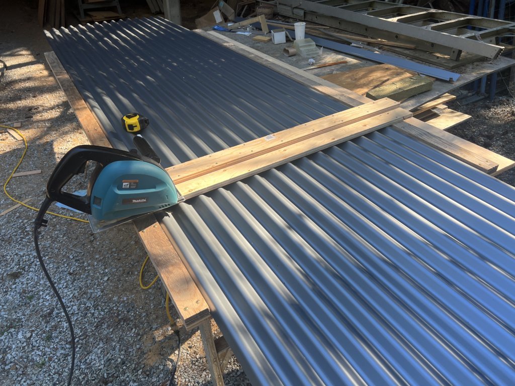

    Most of the metal I have for this building was an order that got cancelled at my lumber supplier's yard that I bought cheap on spec almost 3 years ago so none of the lengths are correct for my building which means I'm cutting every sheet to length so I made a cross cutting table for my Makita metal cutting circular saw with a cross cutting "track rail" the table of the saw rides on and blade cuts flush to the edge of the track rail . All I need to do is slide the metal under the track rail till my pencil mark is flush to the side of the rail and cut . Perfectly square cut each time , same concept as a track saw.

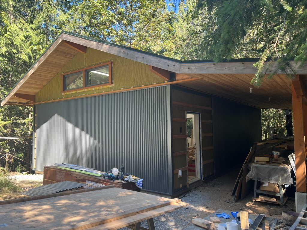

    Started installing panels this morning

    Why no man door casing or flashing?

    That is a temporary door from one of my job sites , I'm going to build a door later but I can't do that by code so it won't happen till after my final inspection but I decided I should install the real jamb now with that steel door hung in it and then just swap out the door itself later but in the meantime I will be able to complete the exterior trims and the siding around that door can go on and not have to come off later
    Just need to mill up some jamb stock and then I can get door hung at my local door shop so I'm just leaving that area for now

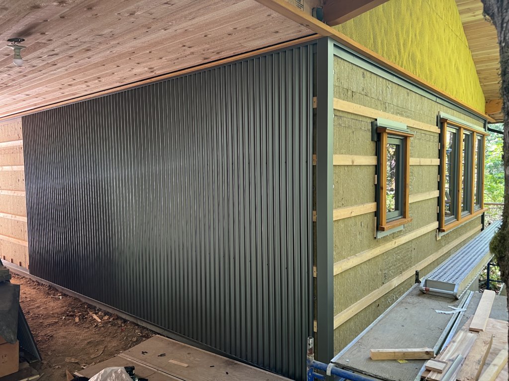

    More panel progress this morning

    Out of curiosity, what will be the final wall thickness once completed (from outer panels to interior drywall)?

    10 1/2"
