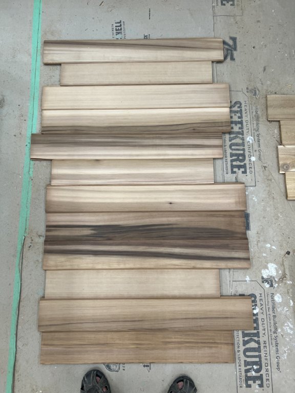

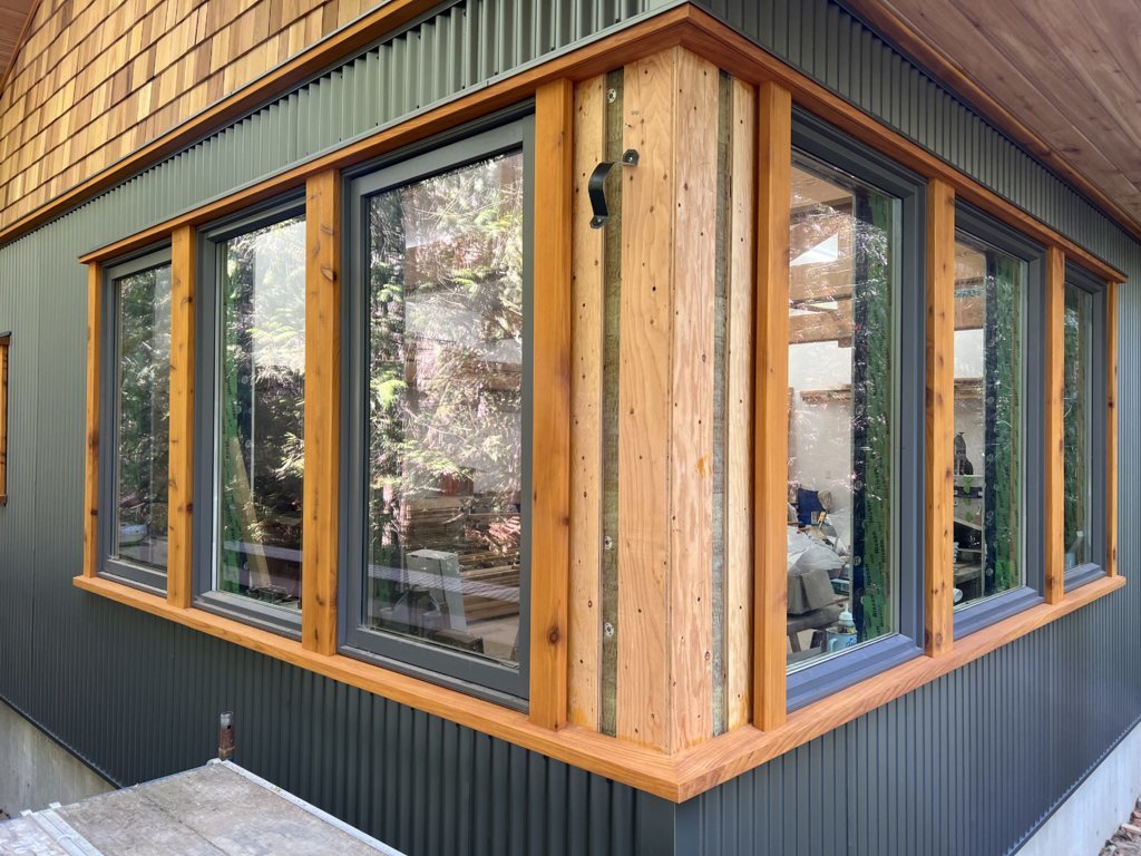

    Had some other work stuff going on this morning moving in to my new client job but had a chance this afternoon to select , order , number , sand and dress the 1x6 v-joint boards for my corner window panel

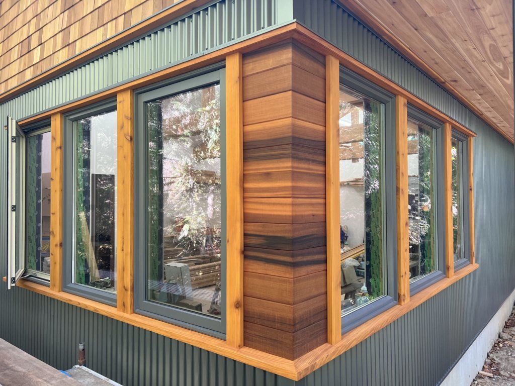

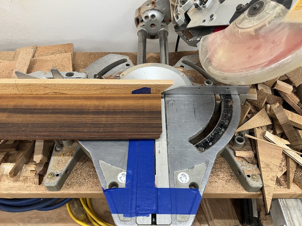

    Coated these boards with Sunfast yesterday so I could install them this morning

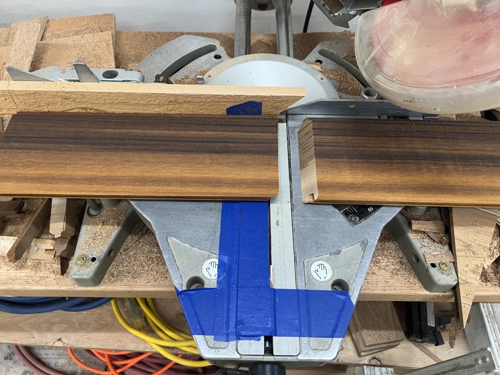

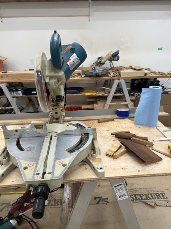

    For the grain wrap cuts , you don't want to have to flip the saw back and forth from 45 degree mitre to square , you want to set your mitre cut and not mess with it , fortunately for me I own 3 of these saws so I set one up for the mitre cuts and another for the square cuts

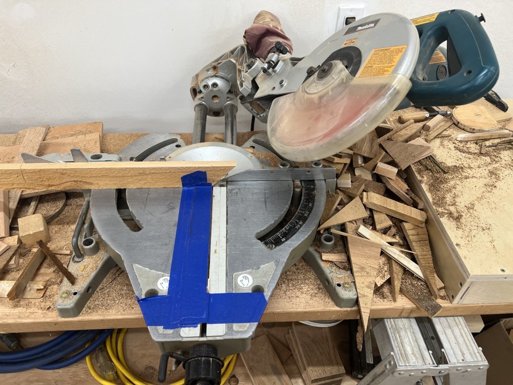

    I want the mitre cut to be just over 45 degrees , in this case I need almost 46 degrees because of the build up on my corner over the exterior insulation . These saws only go to 45 degrees so I tape a cardboard shim on the table to ramp the board so the saw set on 45 degrees actually results in the mitre angle I'm trying to achieve

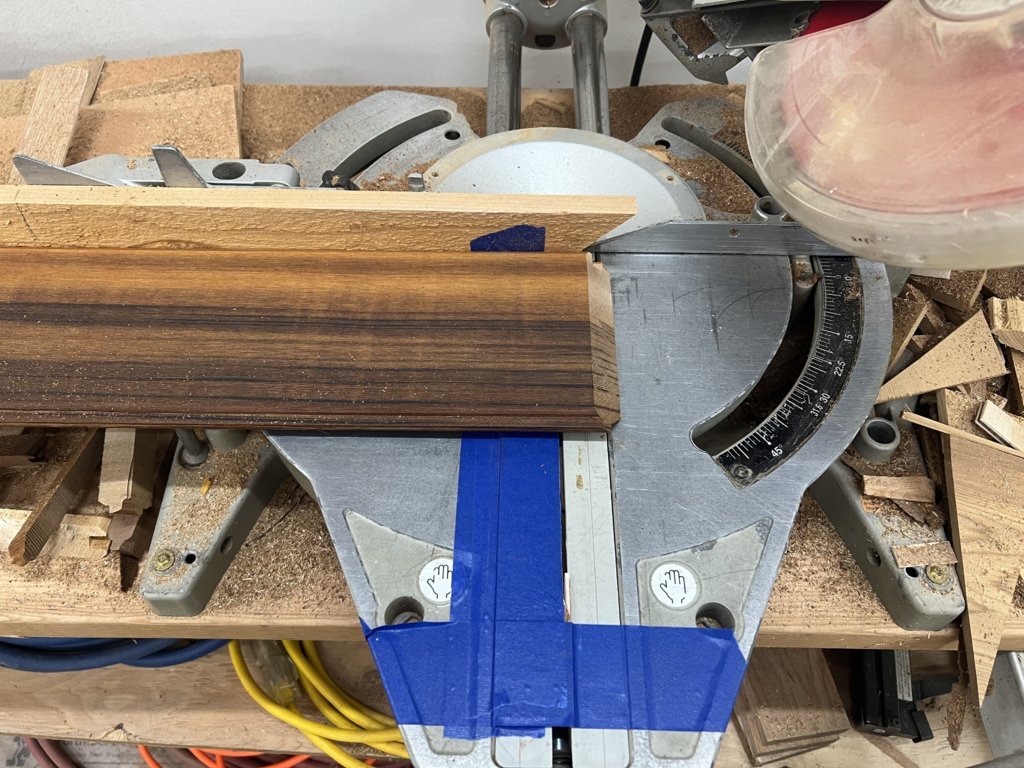

    To make a grain wrap , I figure out the total length of board I need for both sides of the wrap , and add a bit of waste leeway , in this case my blanks needed to be about 30" for my approx 14' pieces on either side of the corner
    I then cut my mitre at the 1/2 distance of the board (I have a pencil mark on my temporary fence showing me where to put end of board so my cut is approx 1/2 distance)
    I set that piece aside and flip the board so its getting cut on the ramped side of the saw
    On the second cut you want to cut as close to the short side of your original mitre cut as possible so that you minimize the amount of material removed between the pieces for the most accurate alignment of the grain

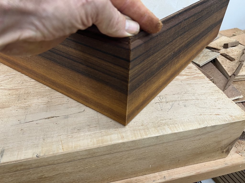

    Holding the 2 pieces together to demonstrate how that works to wrap the grain around the corner
    The pieces get cut to length as required at installation , shortening them on the square ends so the wrap in not effected
    Repeat 12 times

    It's kind of funny. For normal installations, the second and third boards from the top would be the ideal ones to use because they're clear but for this one, they look kind of boring in comparison to the others with some character.
    Obviously looks amazing, though!

    exactly why I laid out all my boards ahead of time , I actually went through 18 bundles of 3' cedar 1x6 I have to pick out these boards so they would flow together how I wanted , and technically they're all clears haha

    1) That does not surprise me
    2) I can absolutely see what you were going for and it looks fantastic.
    I guess I was referring to the lack of variation in color for those two instead of the lack of defects in all of them. :)

    I was going to ask about any concerns of water intrusion on the feature panel corner, but then clued in that it’s T+G with a sloped trim at the bottom. So that takes care of that.
    Looks Ah Maize Zing!
    Is the exterior complete now? (Until the doors that never happened?)

    T&G and its over a rainscreen cavity
    just need to do around the man door after I get the steel door rehung in permanent jamb . Door shop had to order a wider sill than they usually stock was supposed to arrive last Friday , will find out tomorrow
