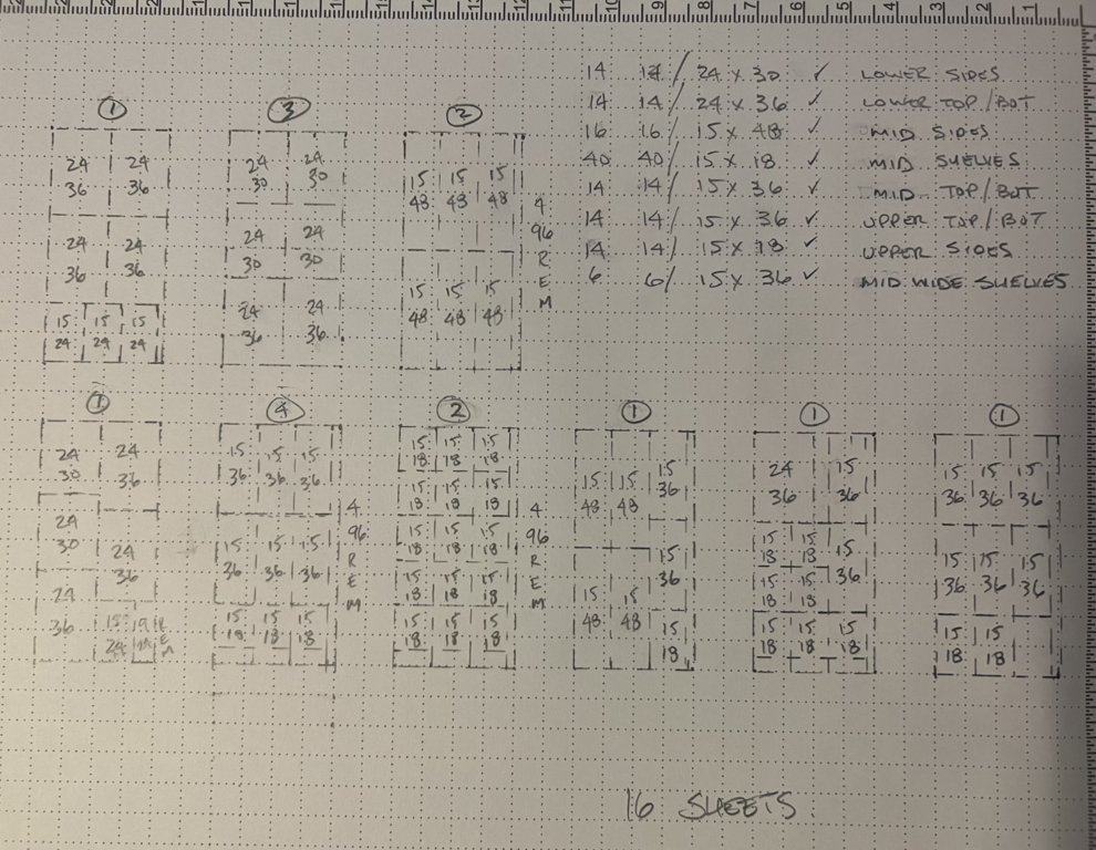

    Got my chopsaw / workbench / Festibule wall and base cabinets laid out and a cut list made up
    I'm just building the cases in phase 1 , doors / drawers to come in phase 2 or 10
    I need 16 sheets , planning on using 3/4" C2 Birch plywood

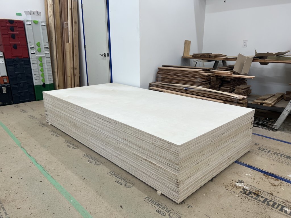

    Picked up the future shop cabinets today while it wasn't pouring rain for the first time in 3 weeks

    Good Lord, that stack is probably worth more than several used vehicles I had... o_O

    I got a good deal , $65/sheet CDN , 24 sheets

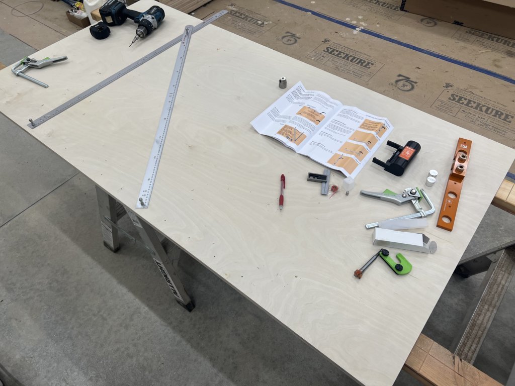

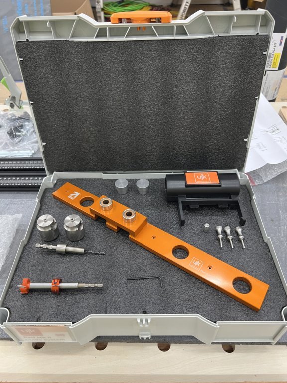

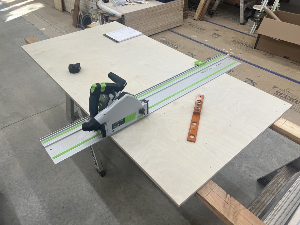

    In a round-a-bout way , I guess this qualifies as working on the shop
    Today I started building a track saw cutting station with the UJK Parf Guide Mk2 system , going to use it to crosscut all my shop cabinet parts
    Got my top cut to size and all the 3mm holes in my 96mm centres grid drilled out. The top is made of 18mm (3/4") C2 Birch plywood
    Where my rail is sitting in pic #2 is where I think I will generally use it , top is roughly 3' x 6'
    I'm planning on buying a Benchdogs.co.uk rail fence system for repeatable cuts
    Still need to enlarge all the 3mm holes to 20mm for the bench dogs but that may be next weekend

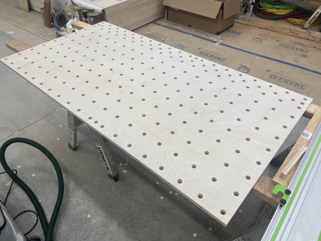

    Finished up my track saw cutting station today

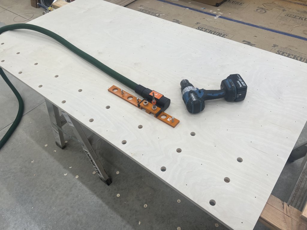

    I used the 20mm drill bit to make a shallow scoring cut on the bottom side of the top at each 3mm through hole location . This isn't in the instructions , I saw Ron Paulk do it in one of his videos where he used the Parf Guide system , its to avoid tear out of the plywood veneer on the bottom when you through-drill the 20mm dog hole . The bit is like a brad point forstner and the pilot part is 3mm to centre in the 3mm guide holes but has no drilling ability so you are not supposed to use a backer board below as you normally would for tear out
    Top flipped back over , starting to enlarge the 3mm hole pattern to 20mm holes
    All holes enlarged to 20mm , top is basically ready

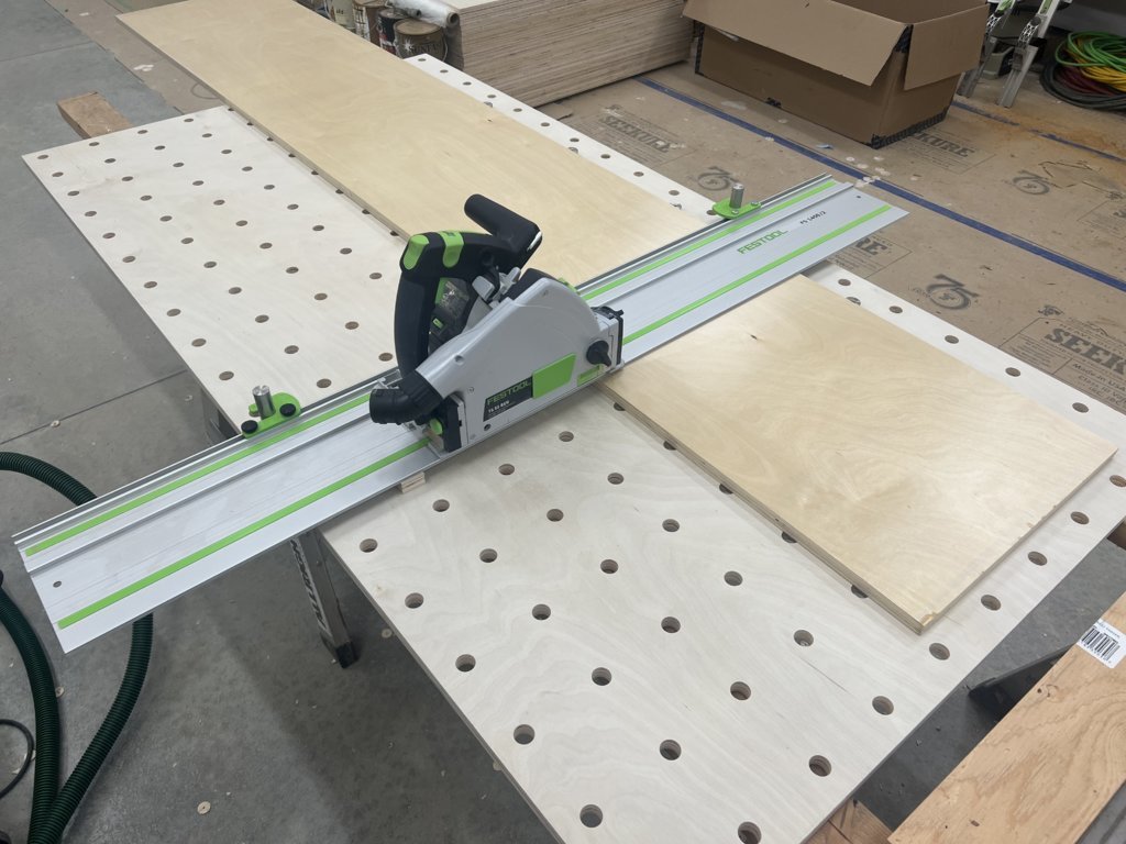

    Example of how you can use this to accurately crosscut material perfectly square . The plywood rip I'm cutting is butted up to some short 20mm dogs in a row at the top of the cutting station and my guide rail is butted to taller 20mm dogs at very top and bottom of the hole pattern assuring that the resulting cut will be a perfect 90 degree square cut
    I'm using Stanton Dog Locks to solidly register my guide rail against the tall dogs but you can do this same operation just pushing the guide rail against the tall dogs during the cut
    My 1800mm Benchdogs.co.uk rail fence is supposed to be delivered on Wed , I'll take a pic of it installed after it arrives

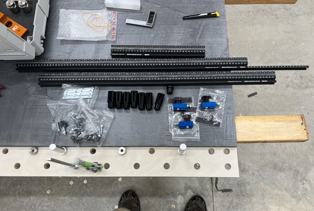

    My Benchdogs UK fence arrived today , it left England 4 days ago lol
    I feel like a kid at Christmas unwrapping all my new toys
    I'll assemble it on the weekend
    I also got an orange TLOC latch and a kaizen foam systainer insert for a SYS-1 systainer I plan to store my UJK Parf Guide Mk2 parts & pieces in
