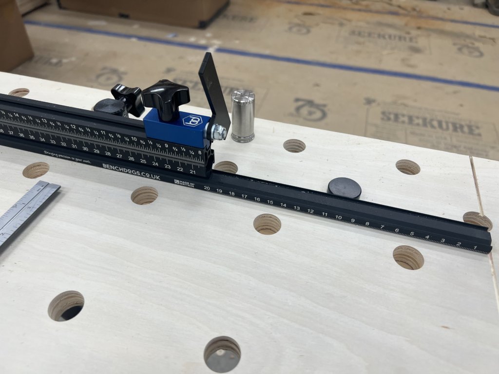

    Got the Benchdogs UK fence assembled , mounted to the cutting top and calibrated
    Made a few test cuts to dial it in , its pretty cool
    The version I got is 1800mm long with the optional right hand fence , has a dual metric / imperial scale , under rail support and comes with 3 flag stops for repeatable cuts
    All ready to start milling cabinet components

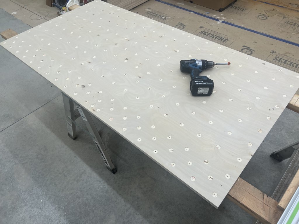

    How did you lay out the holes in the cutting top?
    By hand, with very careful measuring, or did you have some sort of jig/guide?

    UJK Parf Guide Mk2
    skip to around 5:25 if you want to see how it works
    https://youtu.be/8sLtHYEo-nw

    its extremely accurate and fairly quick once you get the hang of it

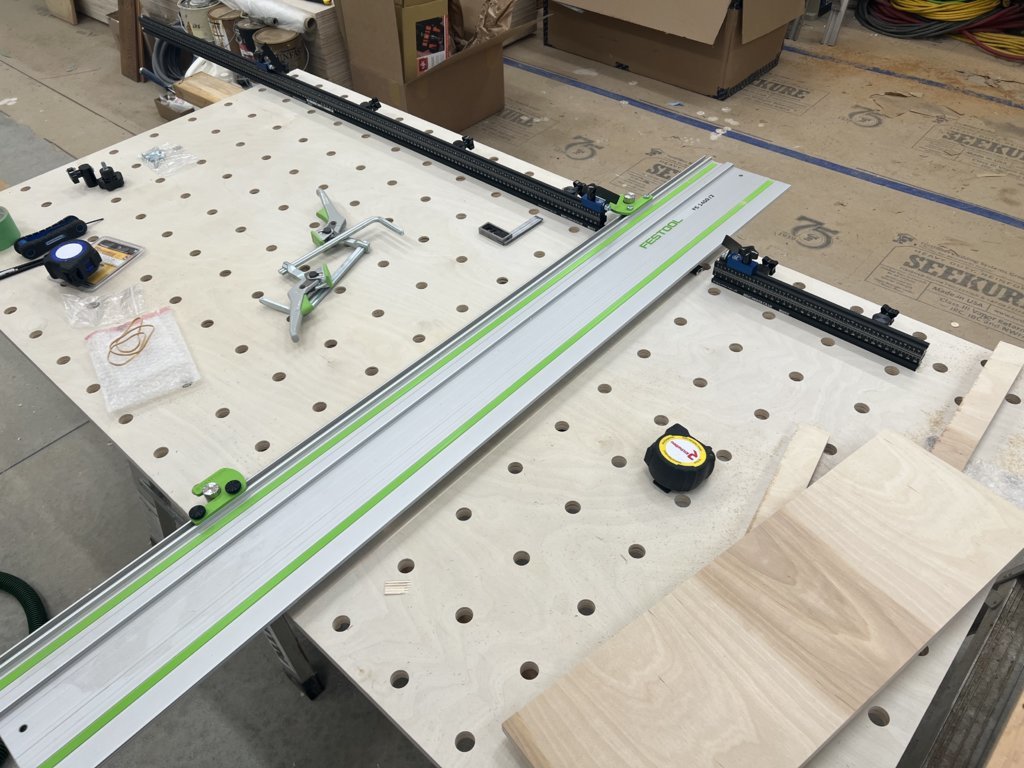

    Did a test run on my cabinet building set up with a small closet organizer box for my inlaw's house . Got to use the crosscut flag stops and fence to cut repeatable lengths with the track saw , dominoed the cabinet box together and set up and used the LR32 system and track to drill shelf pin system holes . Learned a bit about how small the tolerances are for using the LR32 set up with correctly cut panel lengths as mine were not correctly cut lol
    overall a good exercise to work out a few bugs

    I understand why you drilled the backside - definitely a good idea.
    Did you use the guide system, for precision? Or just the pilot bit on the 20mm, since it was the backside, and you were just drilling to prevent tearout?

    I just used the 20mm bit in a drill by hand , use the 3mm pilot on the 20mm bit to centre it in the 3mm starter holes and just barely score the veneer ply about 1mm / 1/16"

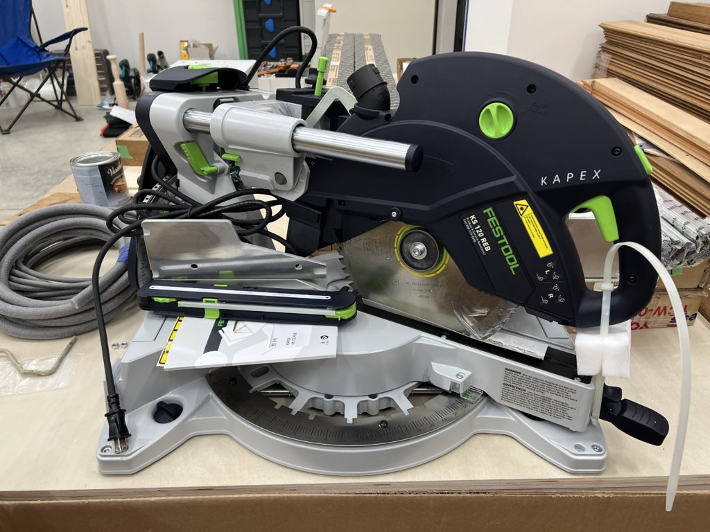

    New addition to the shop arrived yesterday
    Wanted this on hand before committing to cutting up my cabinet plywood
