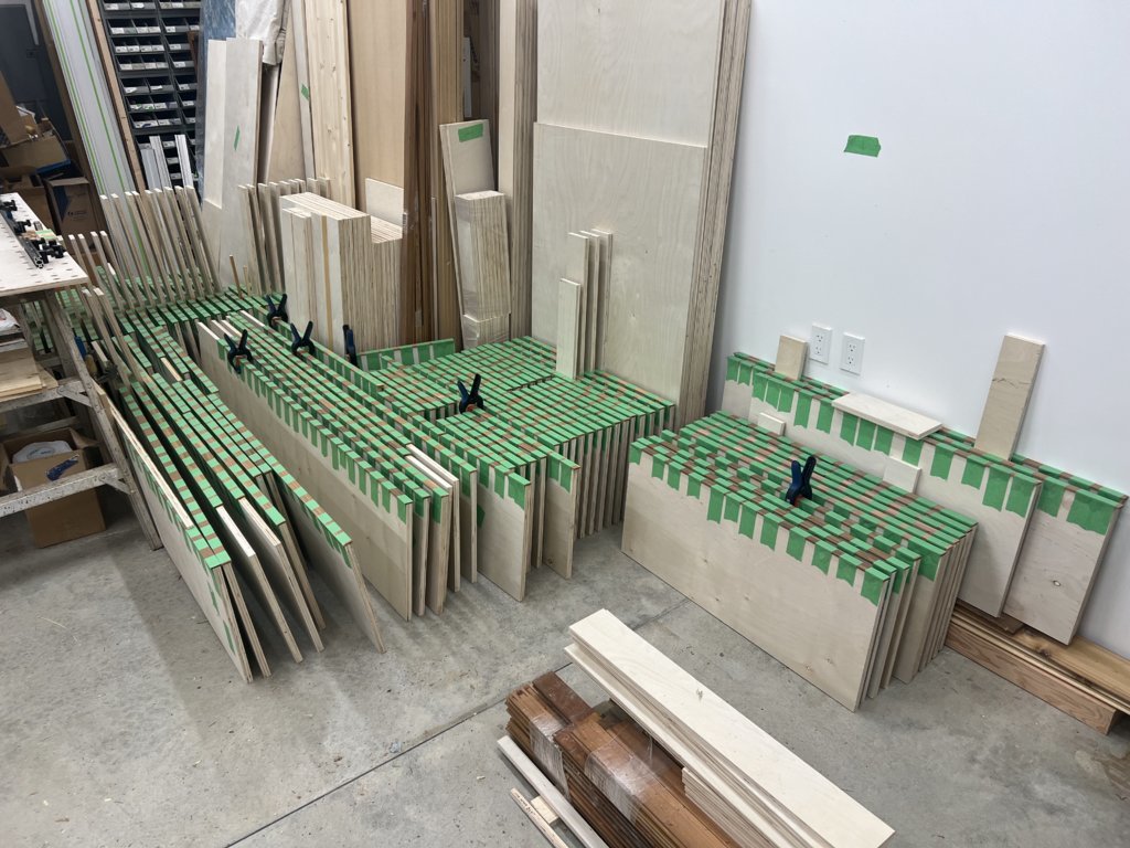

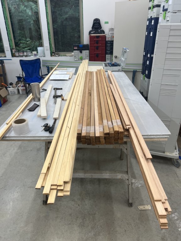

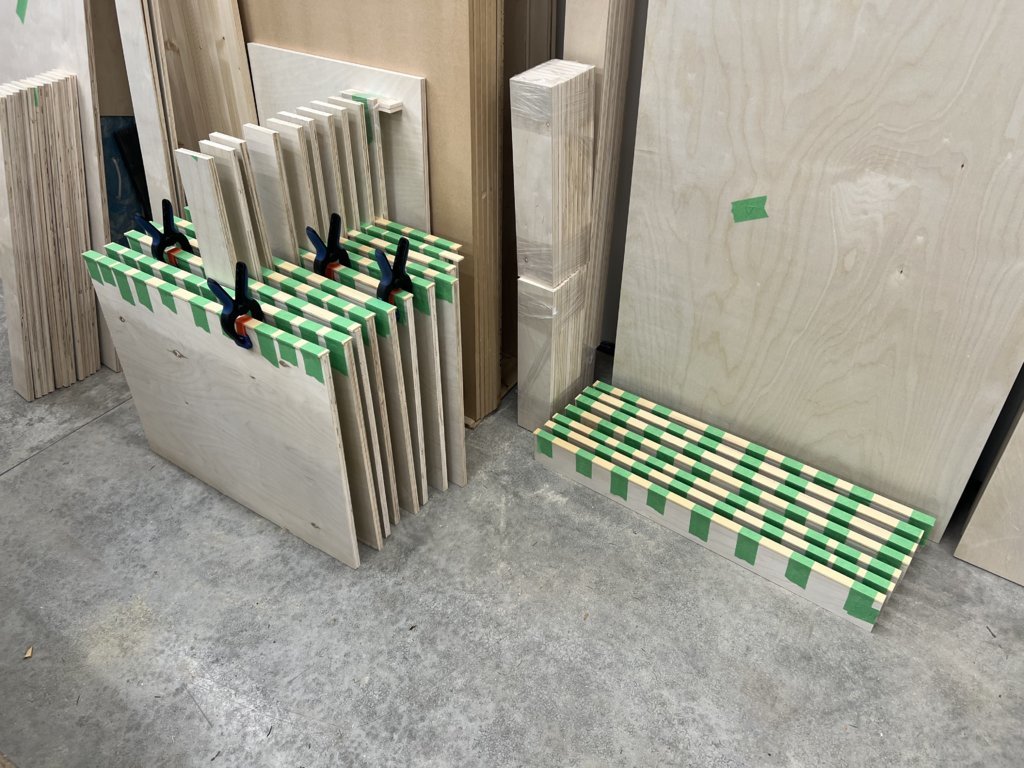

    Got my yellow cedar pieces all cut and applied to my lower cabinet parts today

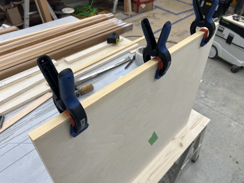

    I used Titebond 3 and Bandy Clamps to get the banding set and then ran 2" painter's tape on them for the glue set duration . There was a couple shelves that were being stubborn and I had to reinforce the tape with some Bandy Clamps .
    All my lower parts banded and set aside to dry
    I wanted my Red Cedar banding on the upper boxes / shelves to blend together as far as grain and colour goes as that will all be exposed and visual . I cut my Red Cedar out of 6' clear 2x4's I had as my longest pieces need to be just under 6' and the shelves are just under 3'
    i realized this morning that the total banding I needed for each upper cabinet and it's shelves could come out of the banding I got out of each 2x4 assuring that the colour / grain on each unit will all be the same . I had kept the banding from each 2x4 separated and shrink wrapped together (you can make that out in the previous pic of all my banding) but in order to apply the matching banding to each individual upper cabinet's parts , I needed to separate them and label them in packages for each upper cabinet . I did that this afternoon .

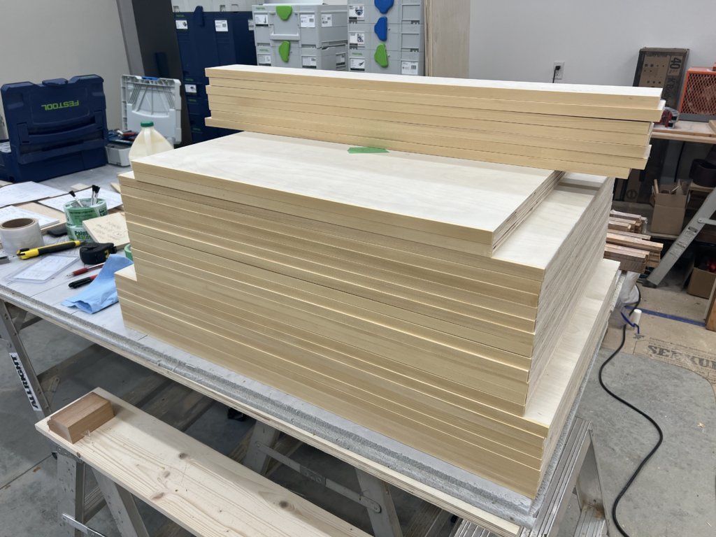

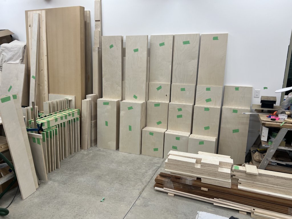

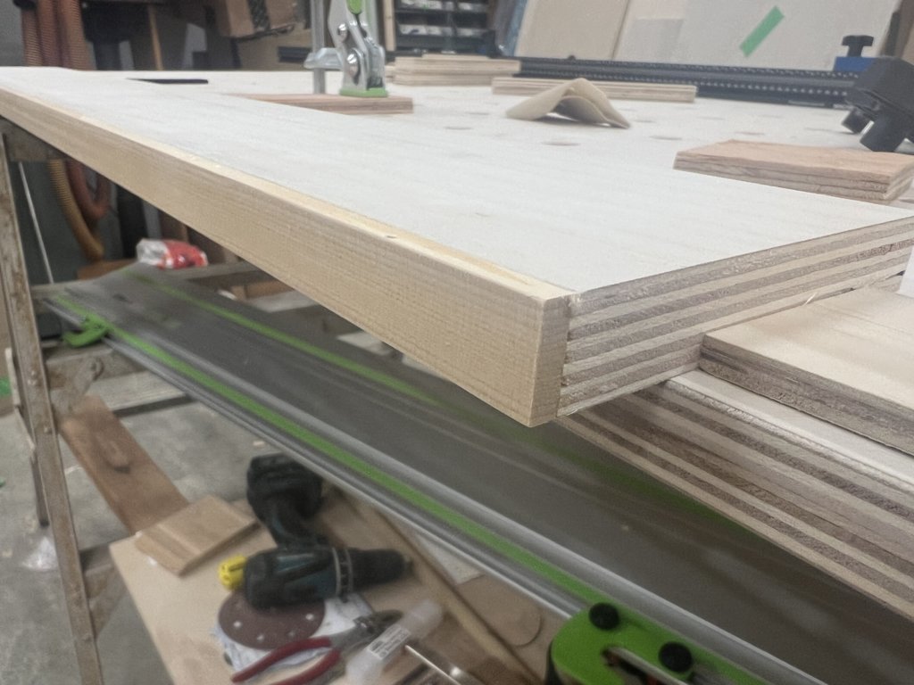

    Worked on flush trimming my lower cabinet banding this morning so I can stack all the lower cabinet components out of the way for now
    Banding overhangs about 1/8" top and bottom of the plywood component
    Banding flushed up top and bottom

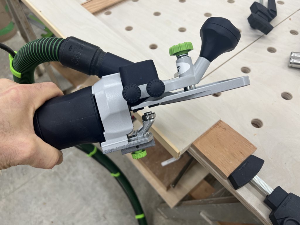

    To do that I'm using the Festool MFK 700 router and horizontal base plate so it acts as a lipping plane
    All my lower cabinet components banded in yellow cedar
    Demonstration of how the MFK 700 works to flush up banding (not me)

    it's pretty amazing what it produces for a flush edge
    Drainbung, wmb67 and scocar[QUOTED] like this.

    Looks like it doesn't require more sanding than what you would do to finish sand the face of the plywood either.
    Clean as hell is what I mean to say.

    You can adjust the cutting depth very precisely . The cutting depth adjustment knob (green knob on top of the fence plate in pic) is about 1 1/4" diameter and a full revolution of the knob equals 1mm of height adjustment.

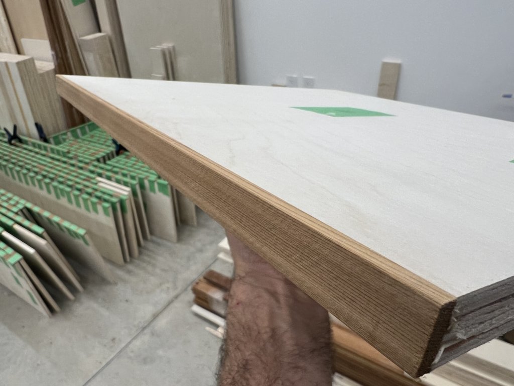

    I gave myself an extra day off today , stayed home and after a marathon stint yesterday and today , got all my red cedar edge banding glued to all my upper cabinet components
    Plus I flush trimmed one shelf that I had done yesterday , I think the red cedar is going to look good . Here is a close up of the edge you get with the Festool MFK 700 router , this has not been sanded yet

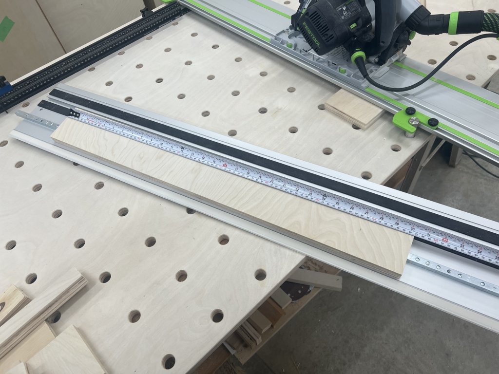

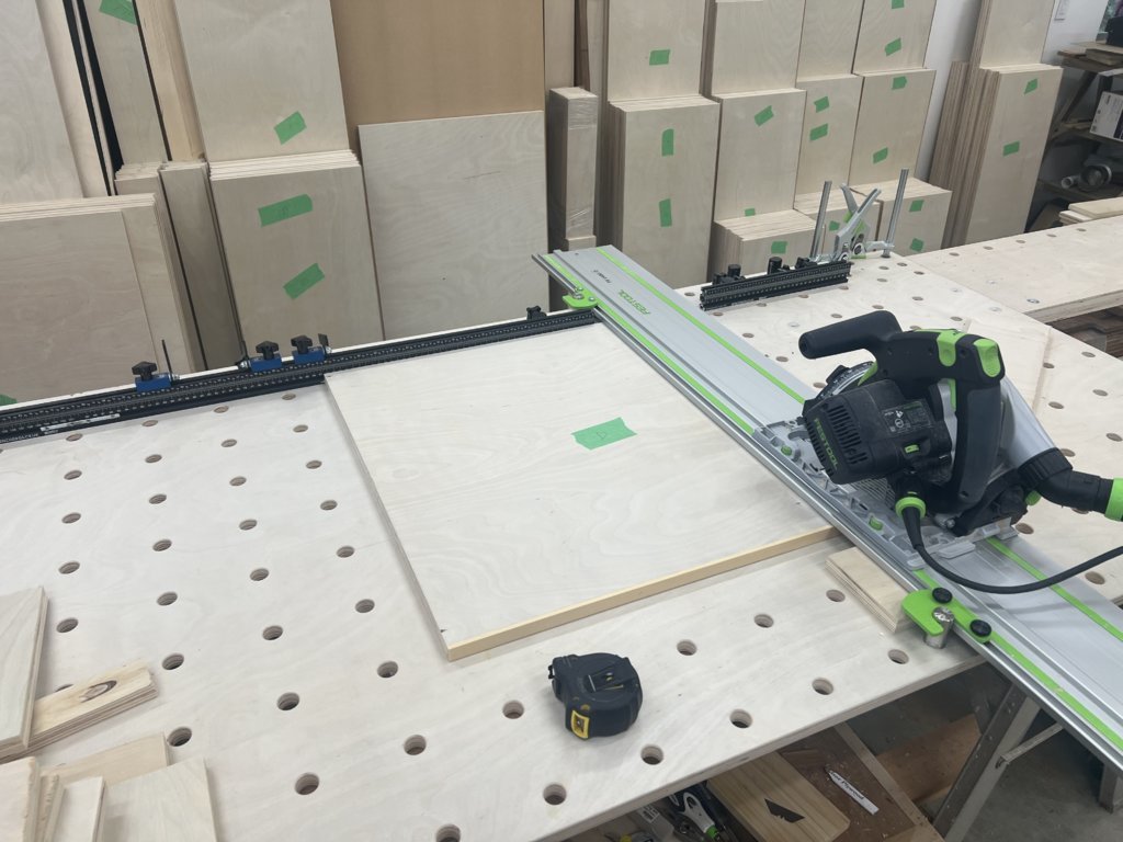

    Started cutting all my panels to finished sizes this weekend on my track saw crosscut set up
    I'm using the Festool LR32 system to drill all my shelf pin and drawer slide system holes . That system is designed to work in the European 32mm cabinet system where all side panels are in multiples of 32mm. The system uses stop blocks on the back of the Festool holey rail to register the panel for hole boring with the router . I learned in a previous test run that getting the panels to very accurately fit between the stops made life way easier later when boring the holes so this time when I went to cut my panels to length I tried a test piece against the LR32 stop blocks to make sure it was a tight fit and when I hit my perfect length I locked in my flag stops on the Benchdogs.UK crosscut fence to cut all my different sized panels
    Next weekend is LR32 time then assembly
