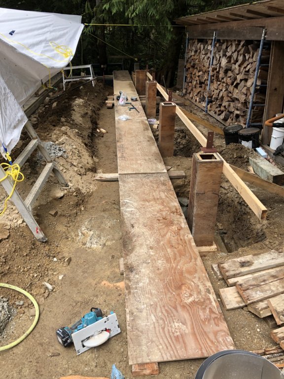

    So this week I've been forming up for the last of the concrete foundation work , getting ready to pour the 2nd retaining wall grade beam and the concrete columns for the posts that carry the outside storage roof
    This retaining wall grade beam connects to the end of the retaining wall I poured with the main building walls and is a grade beam bridging over some more large tree roots so its rebarpalooza
    That section of wall and column all buttoned up
    Next up I'm forming up the 8"x8" concrete columns that carry the 6"x6" posts for the roof support
    I'm doing a 1" canted detail top and sides of these columns like I did on top of original retaining wall / column pour
    I'm installing the cant strips into the boxes on the sawhorses
    Top cant strip complete , column form buttoned up
    Column forms in place
    It poured rain here last night so my post holes are full of water , yay !
    I still need to brace columns and build a ramp as I will be wheeling this concrete . Pour is scheduled for Monday
    Surveyor comes Wed to confirm siting for building inspection then we can turn the page on foundations and open Chapter : Framing

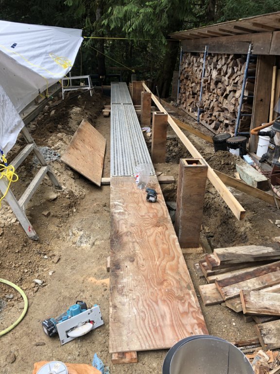

    Yesterday was a bit of a washout so I finished up things today
    Columns all braced and wheeling ramp constructed
