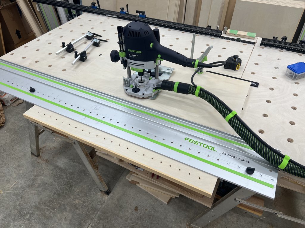

    Started boring all my 5mm system holes for any shelf pins / door hinges / drawer slides using the Festool LR32 set up on my router and the holey rail

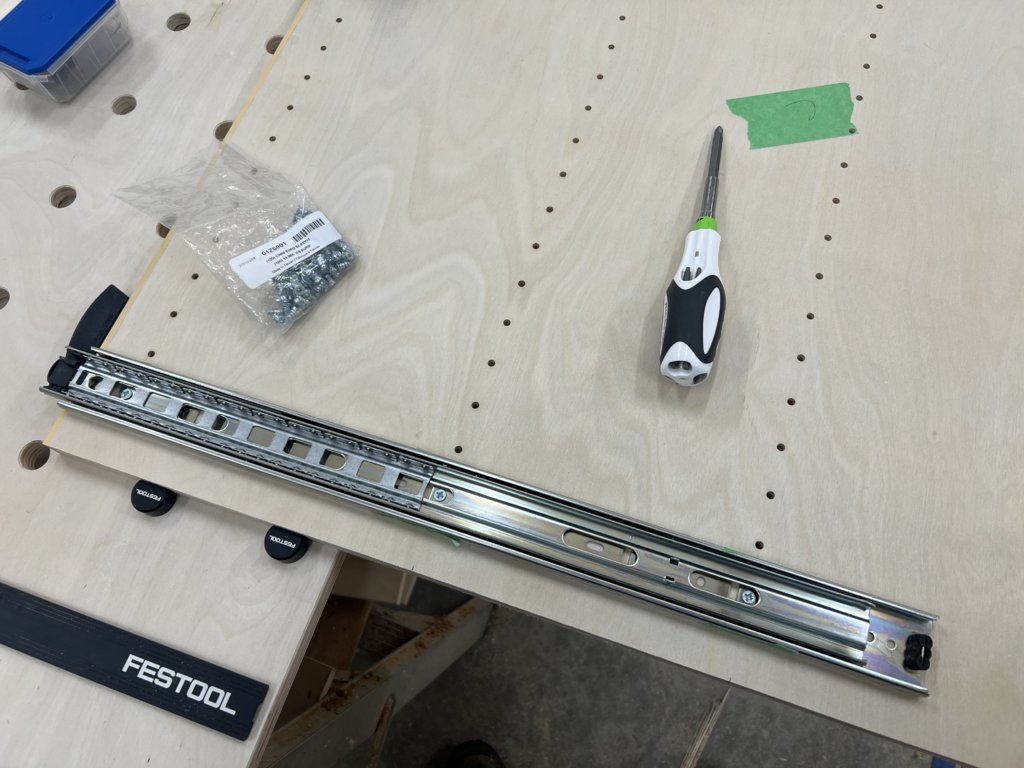

    The lowers are getting 3 rows of system holes for the full height of each cabinet side . Front holes are a common standard set back of 37mm which fits all european style drawer slides and hardware . The other 2 rows are spaced off the front hole multiples of 32mm . The mounting holes of most drawer slides correspond to this 32mm increment system

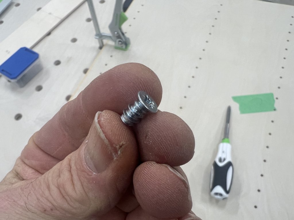

    I'll be mounting all my drawer slides with 5mm x 10mm Euroscrews

    Got all the shelf pin / drawer slide system holes bored for all the uppers and lower boxes this weekend so next weekend actually looks like I can start assembling the cases
