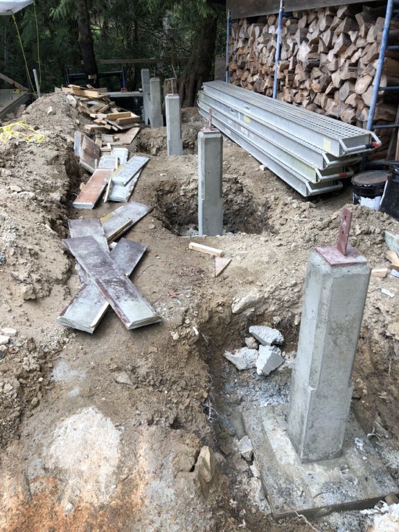

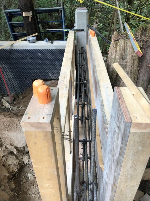

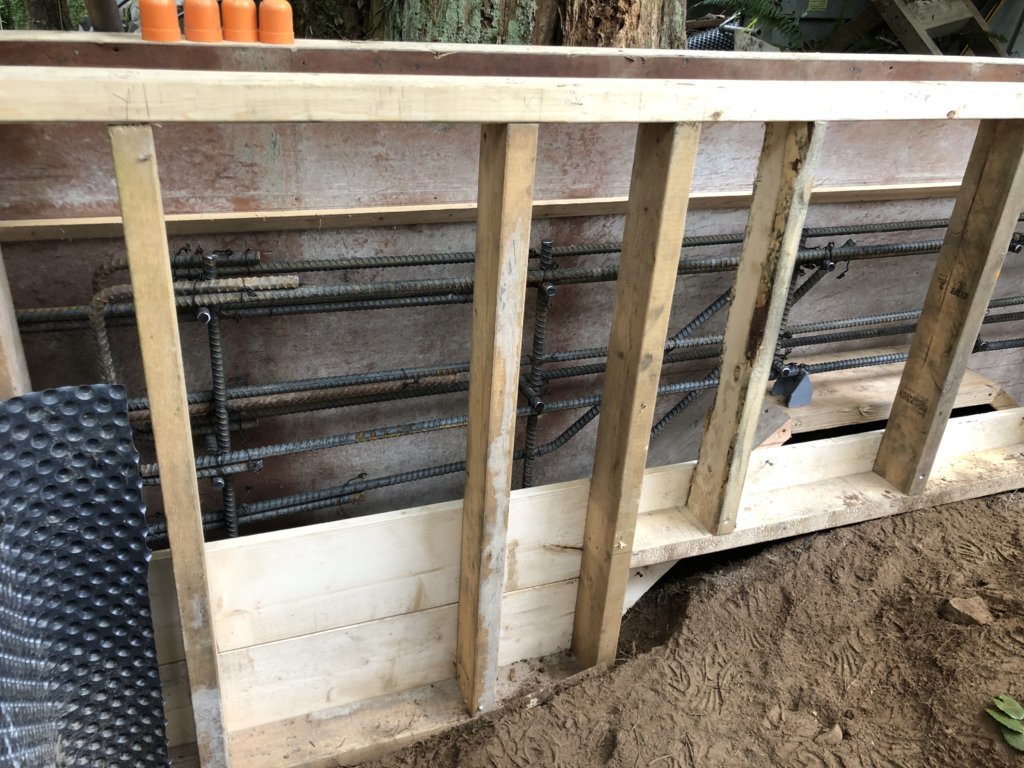

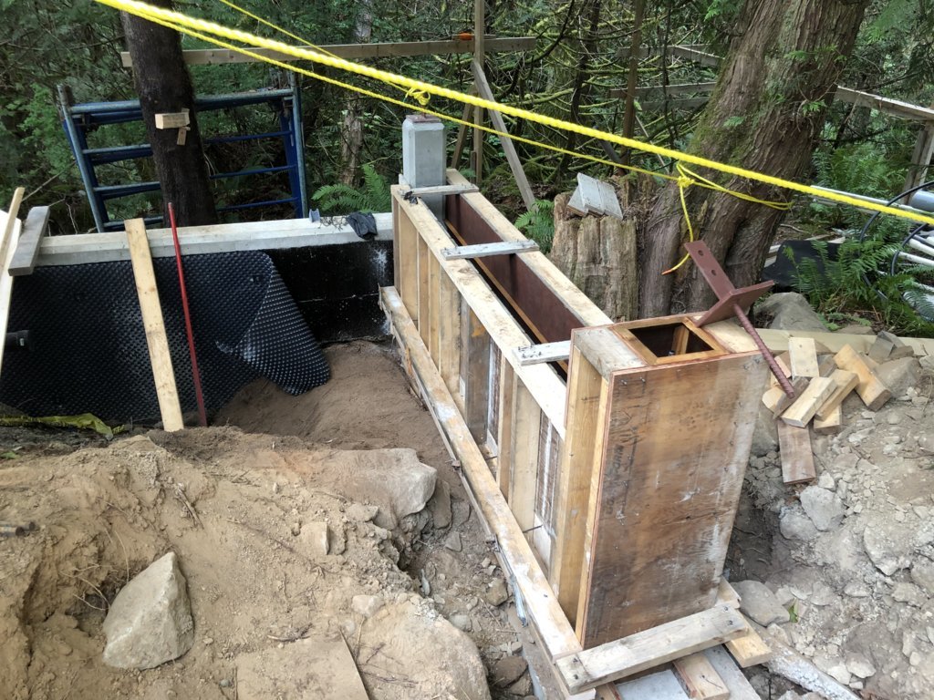

    Retaining wall / grade beam #2 and post columns poured and stripped
    Surveyor here tomorrow for siting certificate and then we start framing finally :woot:

    Column detail turned out great :thumbsup:

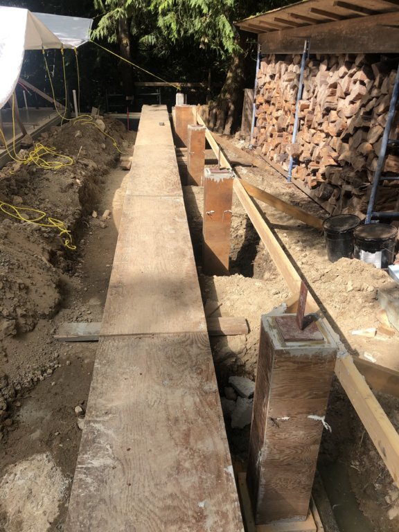

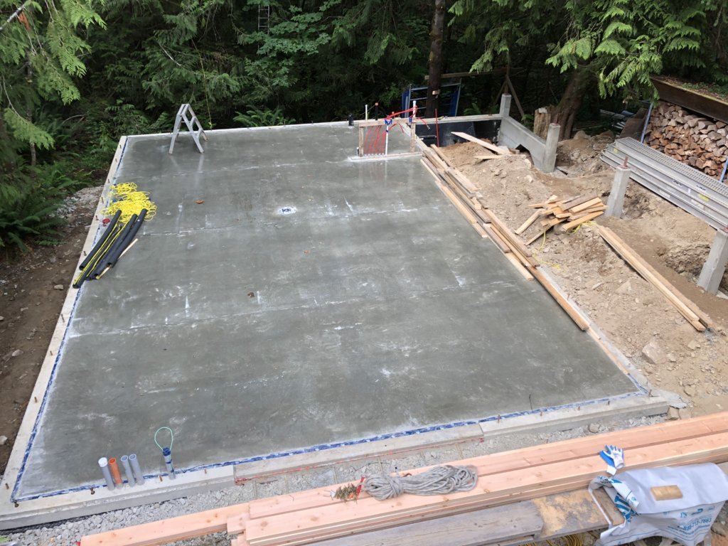

    Big Top down
    All ready to start plating tomorrow

    Didn't think you would have permitted a shop.
    :rolleyes:
    Are you leaving that storage area dirt or are you going to pour a slab in there later?
    I think #2 and #4 column seats are crooked :anonymous:
    Now the fun begins.

    Need permit for any building over 100 sqft here
    Outside storage area will be clear crushed gravel for now anyway

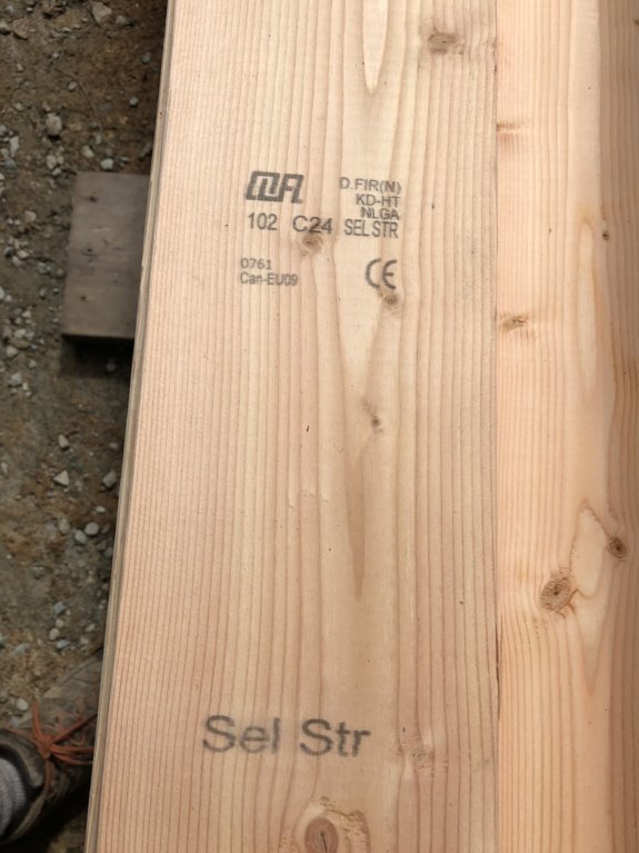

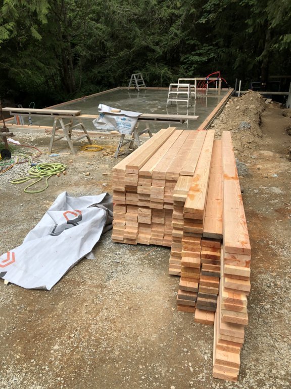

    Yesterday I drilled and bolted down my sill plates , today I went and selected and picked up / dropped off all my framing lumber for the walls
    10's , 12's , 14's and 16's of Fir 2x6
    The lumber market at least here is going nuts , prices are going crazy and availability of some material is sparse
    I worked with my regular lumber supplier and pre-purchased my 2x12 rafter material and 1/2" plywood a few months back but now wish I had bought my 2x6 as well but he gave me a 'personal use' price that made it a bit more manageable and as luck would have it his current stock of Fir 2x6 is Select Structural and some MSR 2400
